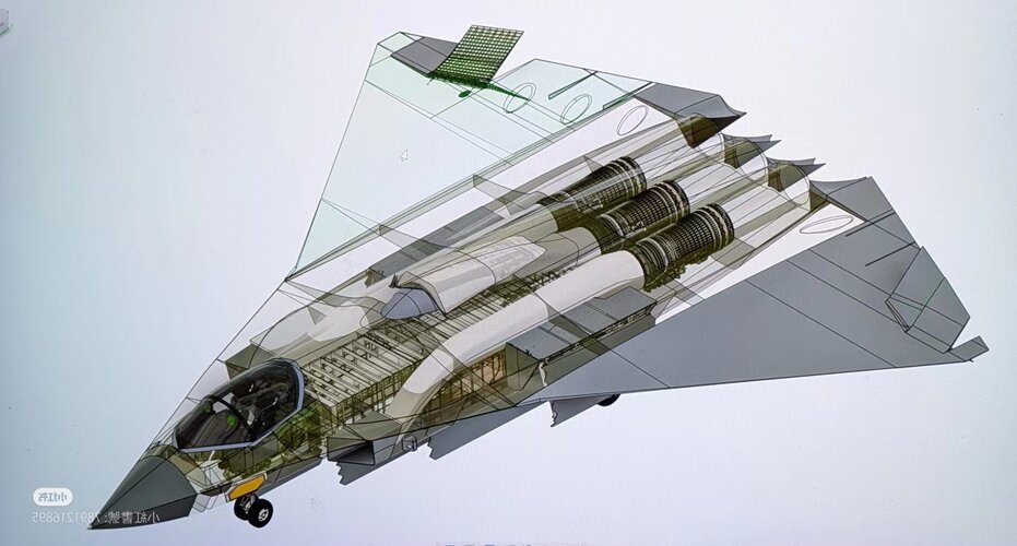

I wouldn't be surprised if they just lifted the drawings from the chinese CAD artist and "adapted" them. The initial drawings have been online for several weeks/months by now.
I wouldn't be surprised if you would like to apologize.

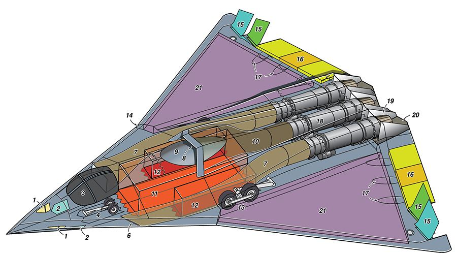

Regarding the speculation that the third engine is more about power generation than additional thrust, what would feasibly even require so much power? The only thing that immediately comes to mind is viable laser weaponry, but I'm a bit skeptical that the PLA has made some huge advancement over the rest of the world's developments in that area. I'm not sure what else might require such a drastic leap in requirements for electrical power.
It's bold to assume that two F135s or two A100/101s would offer sufficient thrust and power generation capability relative to J-36's target requirements.
If the requirements are for high performance, like what is desirable for an air-superiority fighter or interceptor, then why what looks like side-by-side seating for the crew? Based on past trends I think that would suggest more of a focus on air-to-ground missions, which normally wouldn't need a third engine for something of this size. Even with large fuel tanks in the wing it would lose a lot of range and endurance compared to something with just two. I suppose theoretically you could shut off that middle engine and only use it when needed, but is that really all that useful?

Aren't the engines placed far too aft of the airframe on your graphic, at least from judging at where the main landing gear position is. Anecdotally since it seems to have the same exhaust trench layout as the YF-23, i would expect the engines to be much more in the middle of the airframe than at the very back of it.
It's not just about power generation, but rather power generation, thrust and cooling.
In terms of power generation, it's not just DEW that matters but sensors, EW, processing, automation/AI.
Because the airframe is of such a large size that they are able to fit a side by side seating arrangement which is preferable for allowing both crew to coordinate with each other for commanding drones, commanding friendly manned assets, doing EW, while simultaneously maneuvering and conducting its own engagements as well, supported by further advancing onboard automation.
Putting it another way, in 5-10 years it should be a default assumption for a high end air superiority platform to have high end command/control, EW and AEW capabilities, on top of the usual kinematic maneuvering and ability to engage targets yourself.

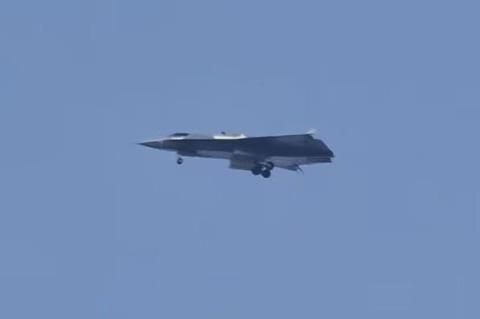

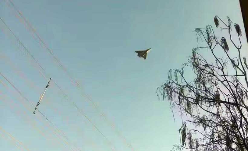

The Chengdu plane we've seen photos of showing a 36011 buzz number on the inlet. So calling it the J-36 in the generic or Article 36011 in the specific is reasonable, based on prior examples from the PLAAF. (J10, J20, FC31, J35)
Have we seen any equivalent photos of the Shenyang plane? Anything saying 50011 or whatever?

no the term J-50 is made by fanboys and the reasoning I believe is to skip the 40 series as 4 sounds like the word for death in Chinese and is unlucky
