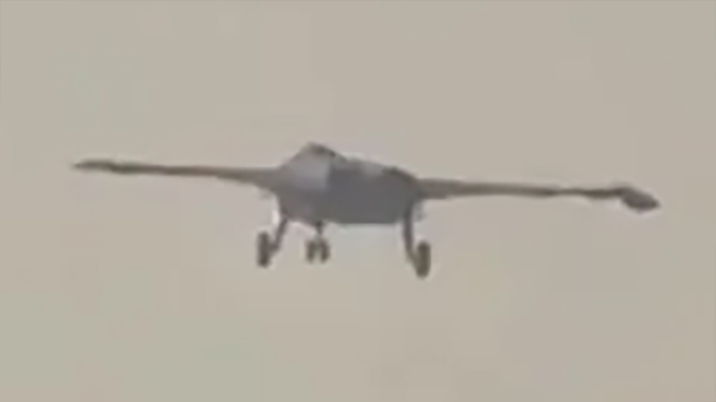

It seems that the moving wingtip and multiple aileron technology is becoming/has become a part of Chinese design philosophy now.
It seem more advanced in production than we think , you don't fly demonstrator over a highway with a lot of people if you are not sure of your plane.
Indeed, they could have even forgone the ferry flight and trucked it to a more discrete location.They would have made a single flight out to a remote location for further testing if that was the case.
The fact that it was seen flying over a city is noteworthy, even referring to Chinese practices regarding public safety.

Another image. Moving wingtips.
But for how long will be the question getting asked siegecrosbow? I suppose that it will only be a matter of time before the first proper PLAAF squadrons get them.
You're looking at years before these things are in front-line service. For the PLAAF, for example, they'll undergo manufacturer's trials at their factories, as Blitzo mentioned. The next place we tend to see new aircraft is at CFTE at Xian-Yanliang. Then, they'll appear at Dingxin and Cangzhou - these aren't yet front-line units, but they are PLAAF units, used for things like weapons testing, tactics development, etc. Then they'll appear in front-line squadron service. Given that we have a pair of aircraft types only appearing very intermittently at their manufacturer's locations, they're likely very, very early in the development phase. Their first flights being in December is entirely possible, has that been implied in any way by Chinese sources? Regardless neither should be anywhere near operation by the PLAAF in trials units, let alone operational squadrons. I think the J-20 first flew in 2011 and first entered service with an operational squadron in 2019 (9 AB, Wuhu). A similar timeline is logical for the Chengdu aircraft; depending how much is evolutionary vs. revolutionary it could be a little bit quicker, but I wouldn't expect it to be drastically shorter (i.e. I could see 6 years to service, but not four). The SAC aircraft may require longer development if it is intended for CATOBAR naval use.
Unless there's a really, really abbreviated flight testing plan (quickly verify flight control laws, do weapons clearance, keep planes maneuver-restricted while the test pilots expand the flight envelope), there's no way the planes are less than 5 years away from IOC.But for how long will be the question getting asked siegecrosbow? I suppose that it will only be a matter of time before the first proper PLAAF squadrons get them.

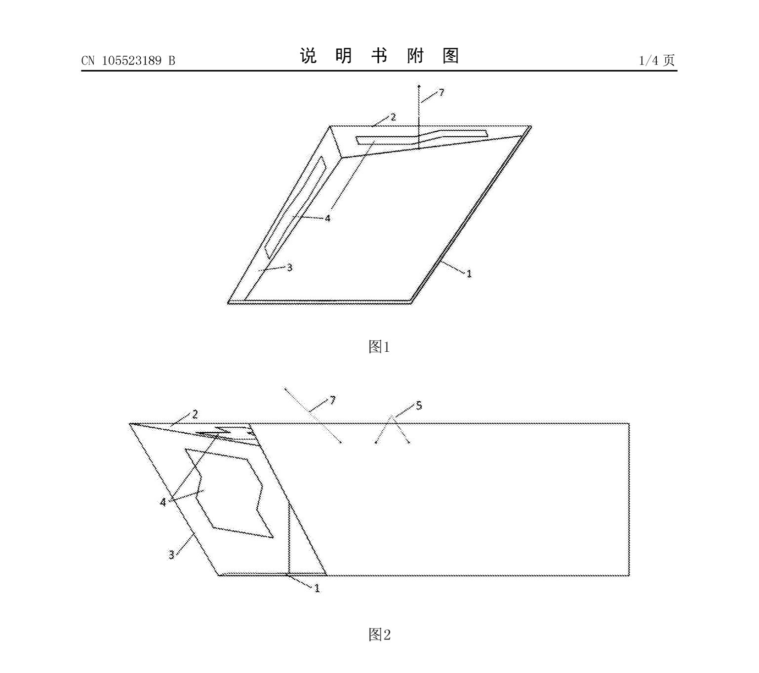

Haven't seen any patents linked here for fixed inlets working across a super broad range of speeds.Unless they do something different with the inlets that we do not know about Scott Kenny.

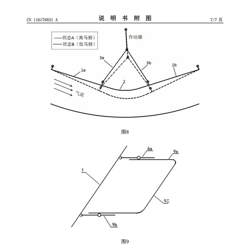

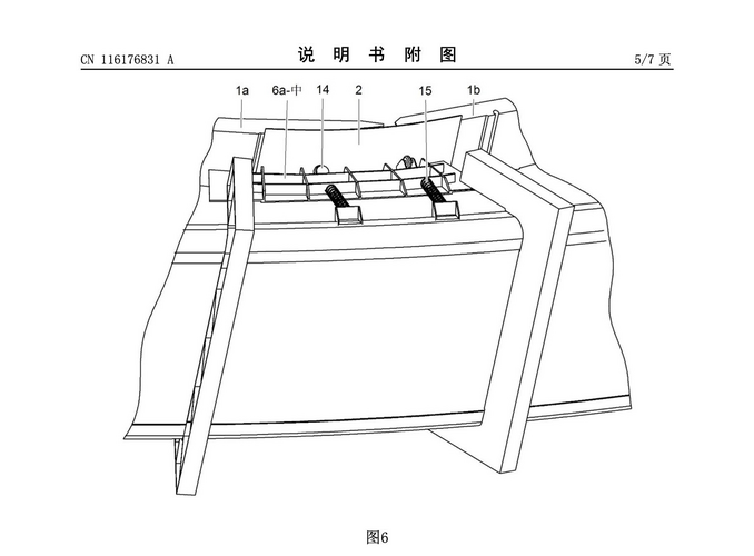

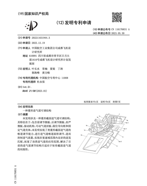

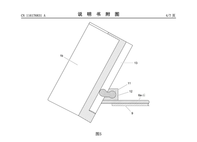

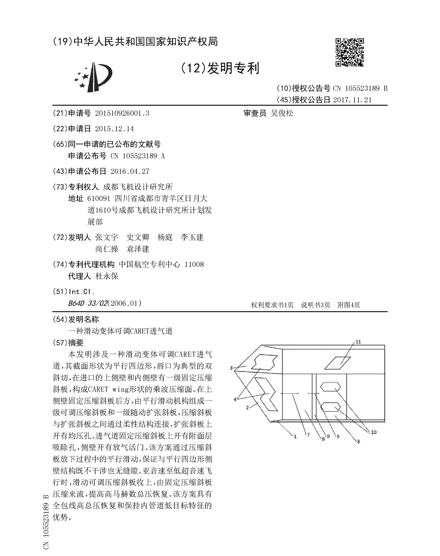

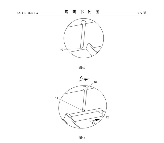

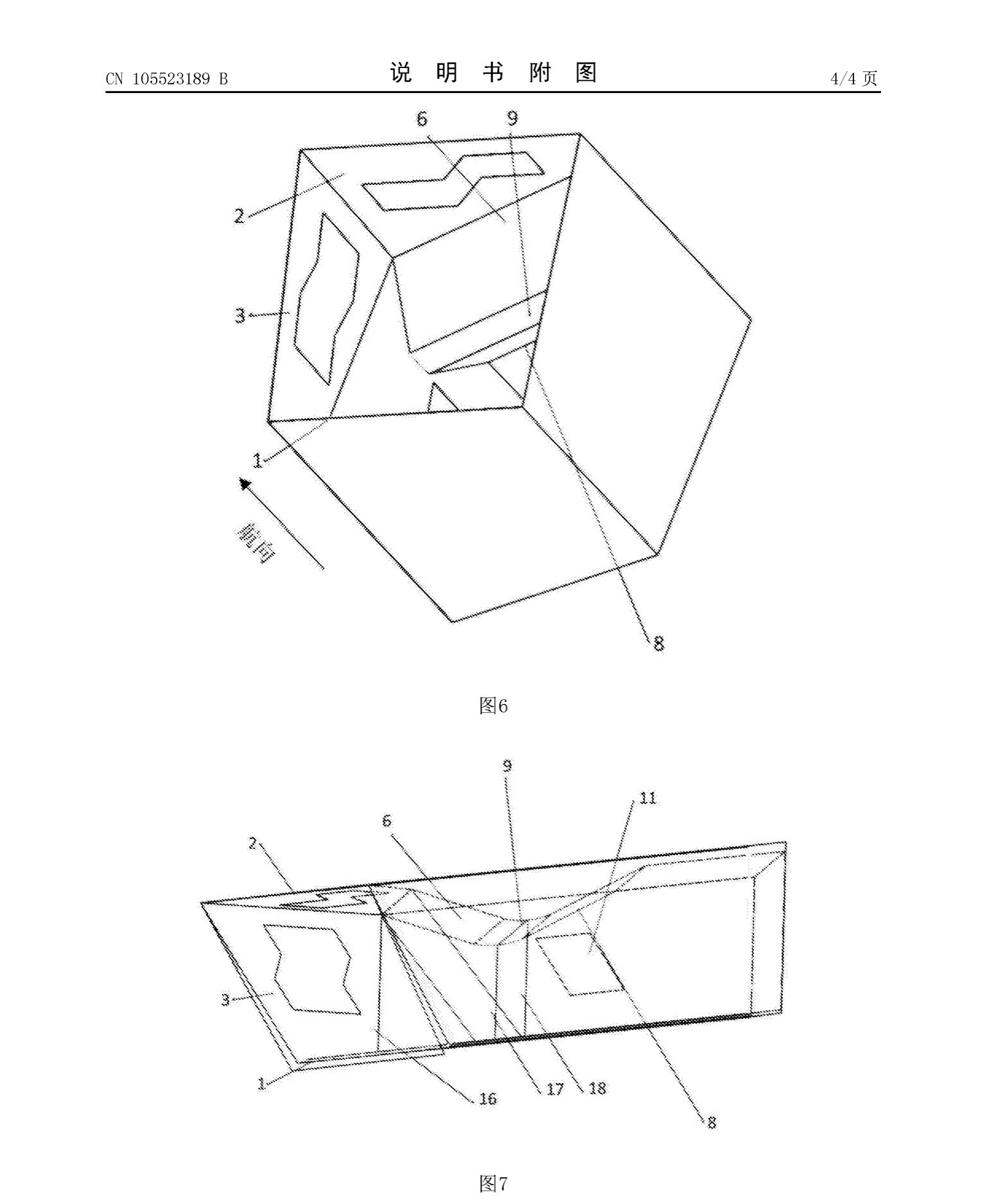

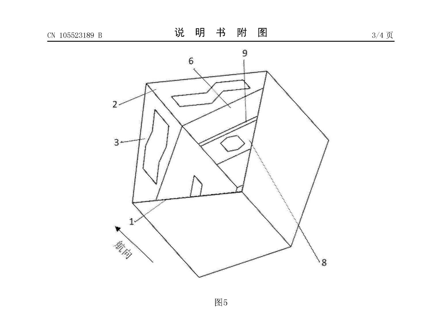

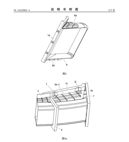

What if the J-36 really had variable caret intakesIndeed, Thrust = Drag. This is not a Mach stupid airplane. Mach 1.7, to 1.8 max, due to materials/cost.
The patent drawing shows a variable internal throat area well after of the inlet edges. With most external compression inlets, the initial inlet ramp generating oblique shocks well forward of the opposite inlet edges, where the throat will focus the terminal shock. With this specific carat inlet, this variable throat doesn’t make much sense unless they are getting mixed compression with internal oblique shocks. Not impossible, but maintaining stable mixed compression over a significant range of AOA conditions is very challenging.What if the J-36 really had variable caret intakes
