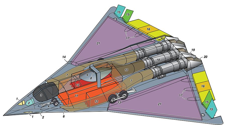

这是一架非常大的飞机,有一个非常大的武器舱-它当然不是用于格斗,甚至不是中程轰炸机 (lol),但是在巡航中两个外部引擎关闭的情况下,这将有一个史诗般的范围 -- 足以从美国意想不到的方向对美国发动攻击,比如东海岸或墨西哥湾,来自中国的地下基地,美国甚至还没有确定。认为中国人会犯一些基本错误,例如将附近的电力线纳入其RCS的评估中,这无非是种族主义,这种想法的结果导致了俄罗斯在1905年袭击日本时遭受的灾难。低估亚洲人的危险。中国的大学技术毕业生比美国的大学毕业生多,几十年来,中国一直在与西方电子产品相匹配,在某些情况下,它要复杂得多,比如几年前他们对主板进行的微观添加,导致数千台关键服务器过早退役,因为中国人正在阅读所有流量-西方甚至缺乏复制的能力,因为它不仅需要在很短的时间内对电路板进行逆向工程,但是对它的理解足够好,可以进行不留下任何痕迹的修改。想象他们在某种程度上落后于美国整整一代,这是一种妄想。你也不能根据美国的想法来判断中国人的想法,因为他们没有朝着同一个方向前进。
从19 40年代到19 70年代,许多射程最长的飞机通常会关闭发动机以增加射程,但在一台发动机中关闭一台发动机,而该发动机的间距很大。比如在一个典型的隐形战斗机上,它们之间有一个大型武器舱,会导致它螃蟹-从而增加阻力。拥有三个引擎可以让他们关闭两个外部引擎,并且仍然有足够的动力进行巡航,同时燃烧很少的燃料,相对而言,而且不需要容易追踪的油轮。当他们需要加速或达到穿透速度时,他们会启动另外两个引擎。

I think the whole turning the inner engine off, or turning the outboard engines off or the third middle engine being a different type of engine is all complete nonsense. Why must there be such a debate for a tri engine plane.
How about the third engine is there because the aircraft needed more power and thrust for it's objectives, and it was not willing to trade it's size and capability or kinetic flight performance that a dual engine setup could not achieve. I also don't buy the Chinese engine technology is weak so it had to compensate with a third engine. There is not an engine, even the NK-32 nor any future engine programme of any nation in the world that can produce as much supersonic thrust as this three engines aircraft with only 2 engines, if the use of WS-15 class engines are to believed.
Not to mention the current research and development work for variable cycle engines, and the mention by the chief designer that the aircraft is meant to feature such next generation engines, the thrust figures and efficiencies at all speeds will drastically improve further increasing the kinetic performance gap between a twin engine versus tri engine layout.
Please, visit the CRANE thread before you arrest your opinion. Aside of the lack of sufficient thrust, this is the onky probable case for this configuration.

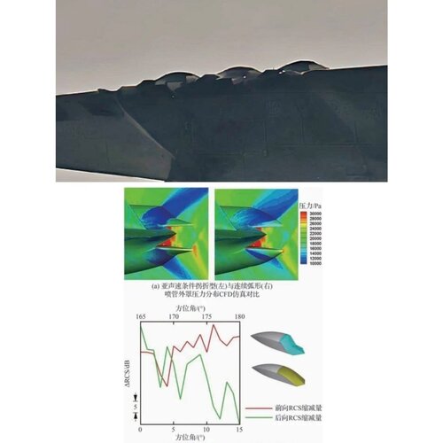

Interesting take on the buried axisymmetrical nozzles.
Yeah they're absolutely nonserious about it.

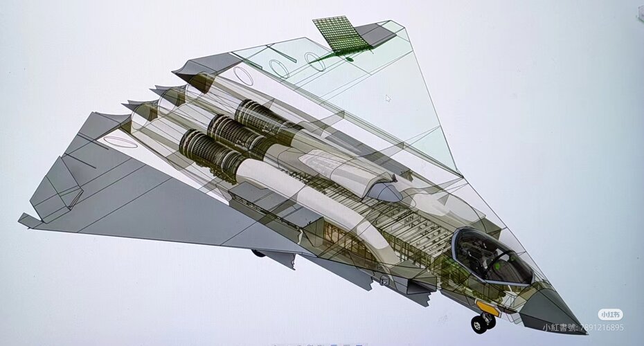

A Chinese CAD modeler did this better than them
Not sure if I can paste the SDF link here or not but there is 40 images im not posting them all here.
I wouldn't be surprised if they just lifted the drawings from the chinese CAD artist and "adapted" them. The initial drawings have been online for several weeks/months by now.
