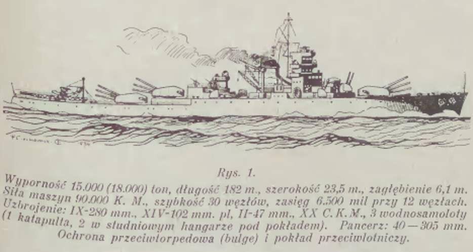

1. Washington cruiser
History: engineer Aleksander Potyrała presented a beautiful concept of a Washington cruiser armed with nine 203 caliber guns, which was used for novel purposes, the concept was not even developed.
2. Potyrała's design for a 10,000-ton heavy cruiser in 1937.
History: In 1937, engineer Aleksander Potyrała designed a heavy cruiser with a displacement of 10,000 tons.

4. Project of the Polish crusader engineer Aleksander Potyrała
History: Engineer Aleksander Potyrała was the author of the design of the so-called crusader( in polish krzyżowiec), the size of a heavy cruiser.( is this true Crusader Project)
5. a project of a Polish cruiser
History: In (1938?) a Polish cruiser was designed to be armed with 152 mm guns, the project was by Potyrała. Ultimately, its construction was withdrawn, and there were such plans.
I don't have his silhouette or sketches.

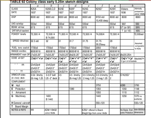

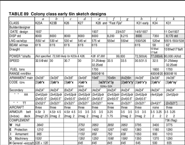

Allow me to post a chronology of dates for our 8000 ton cruiser (the reconstruction is mine).
- somehow since 1936 Poland has been implementing the maritime program 1936-1942 (since when exactly I won't give it off the top of my head because I don't want to make a mistake).
- somewhere in the meantime, around 1937/1938 (I don't know since when exactly it was worked on, the date is more or less) Poles are working on the next maritime program, after the reduction, the plan for 1942 is accepted for implementation. - On April 28, 1938, the Polish-British treaty was signed, as a reminder, it forbade the construction of cruisers no larger than 8,000 tons of displacement, the caliber limit of the guns is 155 mm. It was to last until December 1942.
- for the years 1943-1944, a cruiser of 8,000 tons was entered, I saw it there for the first time, I posted the plan for those years here. It was written that in 1943-1944 the tonnage of the Polish fleet could reach 50,000 tons, until the outbreak of World War II it was 20,000 tons.
Let me remind you that this cruiser was neither originally in the plan for 1942 nor after its reduction, so it should be reasonably correct.
- the last information is that it was supposed to be ordered in 1940, in a British shipyard, so we are writing about a British project.
Based on this data, I suppose that our mysterious cruiser appeared somewhere around the turn of 1938/1939, generally late, because in 1939 they probably already had this design of the ship (or rather we are dealing with a paper ship because it was not built, rather than one of existing ones), it's possible since they were going to order it a year later.
The only question is whether there was a tender, if so, it was in 1938/1939, and there were not as many offers as in the case of destroyers.
If not, it could have been somewhere in late 1938. But perhaps the design of this ship can be dated back to 1939, because you have to write the requirements, and probably other things, after all, it's not that easy to order a ship.
Above, I have included 2 tables with Colony designs, as a reference material for this cruiser, because these designs are very close to it, and maybe one of them may even be ours.
These are the closest known British 8,000 ton cruiser designs of those years.
designs from 1936 can be rejected, the same ones that are more than 8000 tons, ships from 550 wl and above can also be rejected in my opinion, because the cruiser for Poland would be rather smaller than the British equivalent (you have examples of French destroyer designs for Poland, Polish Guepard comes from 1933, the same Polish Fantasque / Le Hardi, let me remind you that it is a design of the de Loire shipyard, because in the picture I see an inscription under B2: Paris and then you have the year 1933, I can't read the exact date because I don't know French, but in English it's probably October 6).
On this basis, the ships in this table would be:
K23B, K26, K34 or K31 early.
The problem is that the British may have, for example, the data of this ship, but they may not know that Poland was to order a cruiser, but the Poles in the archives may have a drawing of it when it was supposed to be ordered, but they may not have the ship's data, as in the example from table.
The project itself does not have to be one of the Vickers-Armstrong projects, because it can be one of the preliminary projects or another shipyard.
You have my conclusions and thoughts.
I am more and more convinced that this is some kind of ship ala Fiji, time will tell how close I am to the truth, it would be a bit funny if it turned out that this cruiser was a K34, then you could write that I am a prophet or something like that.
I will note, however, that I do not know the Belfast (Town class) and Arethusa projects.

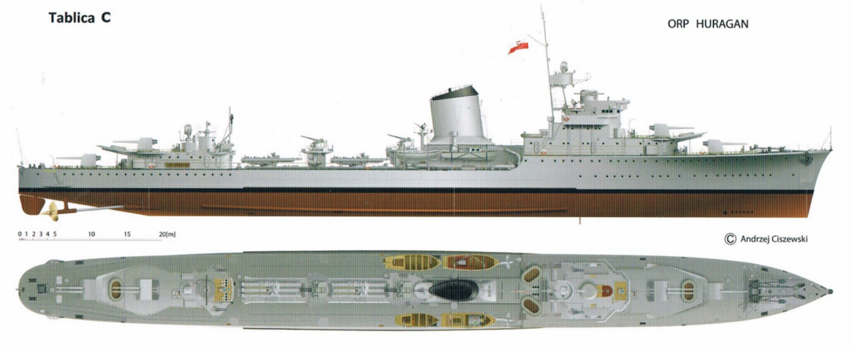

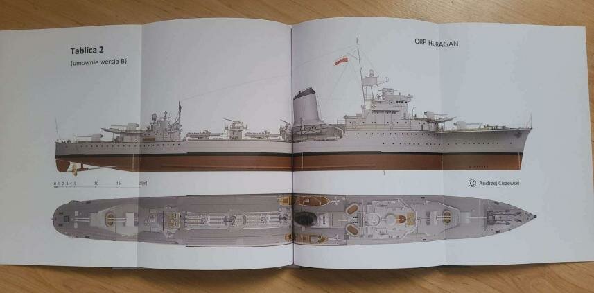

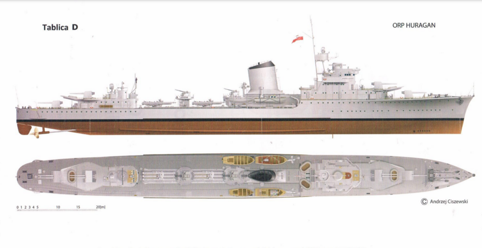

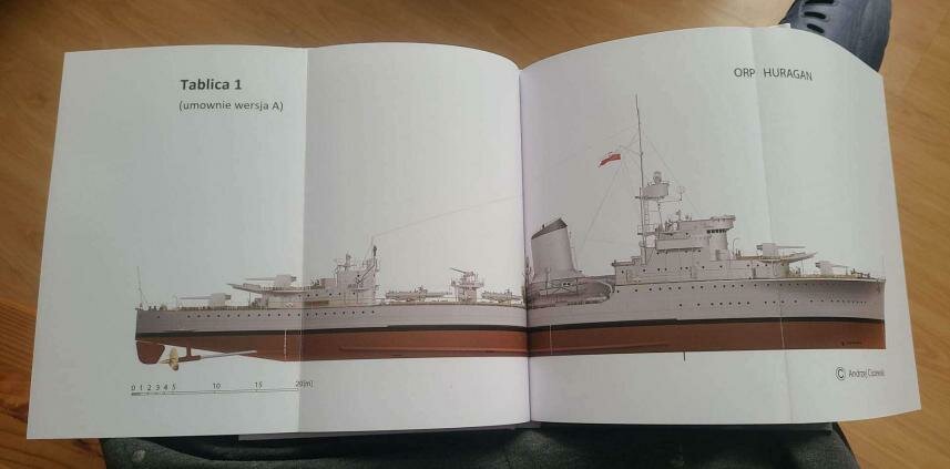

Destroyers improved Grom class.
First of all, I will write that the documents about these ships talk about the continuation of the construction of a series of Grom-class ships, there is no such thing as Hurricane-class destroyers, the correct name for these ships is Grom-class destroyers/improved Grom-class, because there is actually no evidence of how the new destroyers were named, but nevertheless it was customary to call them ORP Huragan and ORP Orkan and they are known under this name, although no documents for such names have been found, even as proposals.
The Hurgan type/Huragan class can be named to distinguish the new destroyers built in Poland from the Grom class.
But it should be remembered that these destroyers were not built according to the plans of the Samuel White shipyard, they were designed in Poland, based on the plans of Grom-class destroyers built in England.
Now I will write about the variants of this destroyer.
There is version A on Table 1, my friend sent it to me in January this year.
The drawing of this destroyer in this version was based on the original drawing of these destroyers called B18 7, dated November 7, 1938.
In this version of the major changes, the destroyer has a rounded superstructure at the front and 4xII 13.2 mm Hotchkiss.
Table 2, version B.
This is also a reconstruction of this destroyer based on drawing B18 7, the difference is that it is a reconstruction of a corrected drawing.
We also have 4xII 13.2 mm here as in variant A, but the shape of the superstructure is different.
Table 3, version C.
The version you see here is a reconstruction of the destroyer based on drawing B18 5.
we have as many as 5xII 13.2 mm Hotchkiss here, although there is also a variant without these Hotchkiss on the aft superstructure, in this reconstruction they are on the aft superstructure. Or at least I think there's a 5 xII here, look near the funnel, right behind that 40 mm Bofors gun.
The last version is on table 4, version D.
This is also a reconstruction from the corrected drawing B18 7, dated March 7, 1939, the latest and little known.
on the superstructure there are 2xII 13, 2 Hotchkiss, and at the funnel there is 1xIV 13.2 mm Hotchkiss, giving up 2 twin 13.2 mm at the stern.
Reconstructions and information about these variants come from Wielki Leksykon Uzbrojenia wrzesień 1939 tom 181 kontrtorpedowce typu Huragan by Maciej Tomaszewski.
The first two photos of the boards were sent to me by my friend a few years ago.
The illustrations are by Andrzej Ciszewski, as far as I remember.

The first time I posted this drawing was on one of the Facebook groups, my friend posted it yesterday and I asked him what the source of this drawing was.
I know everything there is to know, so I'll tell you about it.
In one of the issues of magazine Przegląd Morski from 1934 there was an article titled Ships of the Future by Benbow.
The author wrote there about the future of, among other things, battleships, he claimed that in the future there will be two varieties of battleships.
The first of them is a ship armed with VIII to X guns with a caliber of 333 to 406 mm, a displacement of 25,000 to 40,000 tons, and a speed of about 30 knots.
The second type is basically a lighter version of a battleship adapted to closed seas and capable of fighting for the maritime freedom of its country and supporting the actions of its own light forces.
This is a warship with a displacement of 10,000 to 20,000 tons, at a speed of 28-30 knots, the armament of such warships is to consist of VI to IX 280-305 mm caliber guns, and the armor, as the author himself wrote, is to be lighter than typical battleships, but still sufficient an equal opponent, and above all to defend against aircraft at low altitudes. (in the Polish case, it is the Deutchland class, although it had a 28 cm gun, so it is difficult to call it a typical cruiser, so here in this comparison it is an exception, or the Scharnhorst class, and Russian battleships, later at that time also a Kirov, but it was a cruiser, my comment)
The battleship discussed here belongs to the second, lighter type of battleship, what you see in the drawing is concept of a lighter version of the battleship that I wrote about above from the article, of course. ( rys.1, is an abbreviation of the word "rysunek" in English, so it can be translated as a drawing or fig.1, although more specifically it is an illustration of such a battleship. My comment.)
I am posting the data below.
Displacement: 15,000(18,000) tons
Length: 182 m
Width: 23.5 m
Depth: 6.1 m
Armament: 9x 280 mm guns (3xIII),
14x 102 mm anti-aircraft guns,
II - 47 mm guns, 2xI
20x heavy machine guns - C.K.M
3 seaplanes: including one catapult
Armor: 40-305 mm
Anti-torpedo protection (bulge) and anti-aircraft deck.
Power plant: 90,000 HP
Speed: 30 knots
Range: 6,500 nautical miles at 12 knots.
Translate by me.
And drawing is here
Probably the author of the article himself is the author of this vision/concept of the warship you see in the drawing.
I posted this drawing because someone might be interested in it, and they can analyze it and discuss it.
Of these, the main guns are 100% German, because the 280 mm guns are triple guns, and there weren't many of them at that time, and probably only the Germans had triple 280 mm guns.
The 47 mm guns may be those used on ORP Bałtyk, as for the 102 mm, they may be British Mk XVI guns based on the Mk XIX, but I don't know if it's too early for them.
Source is here Przegląd Morski NO. 68, 1934 and if anyone wants to read the entire issue, I also give a link https://bibliotekacyfrowa.eu/dlibra/publication/62401/edition/56600?language=pl .
This is amazing. What would other possibilities be for main guns if the German ones were not available? Possibly Swedish Bofors?
Considering that these are triple guns, I can't think of anything other than German guns, and the Swedish model 1916 guns were twin guns from what I remember, the design 1047 from the Netherlands was later.
As for the 102 mm guns being British, I may be wrong, it depends on what the author knew.
I won't say exactly what machine guns there are here because I don't know what they are here.
This issue was in November 1934.

With all respect, but I suspect that you took the generic speculation about "battleship of the future" for the actual project. Author probably just decided that 11-inch guns are better for some theoretical reasons, not because he actually wanted to use any existing German or Swedish guns. As you himself wrote:
So it's basically a generic concept, with "maybe 11-inc, maybe 12-inch" guns supposed to be used.
I know it's a concept, it's far from a project, I translated the data for this battleship into English.
If this were a project, I don't think they would use German guns, or if they did, Swedish ones.
These were his predictions for the future of battleships.
To be precise, I wrote Polish Gneisenau/Polish Deutschland as a battleship that is an equivalent of such warships so that it can be compared with something, so yes, I wrote it in the context of the equivalent, although the Polish equivalent is a concept.
And above you have explanations about the word drawing, in short, I translated the Polish word into drawing, although in fact, more specifically, we can talk about the illustration of such a battleship as a concept and not a project, because it cannot be considered a project.
Since in the case of Poland it is difficult to look for battleship designs, at least I don't know any, I think you can be satisfied with concepts, as in the case of the battleship I wrote about today, or with some visions of battleships, not counting specifications or data from naval programs.
Now that's a different topic.
