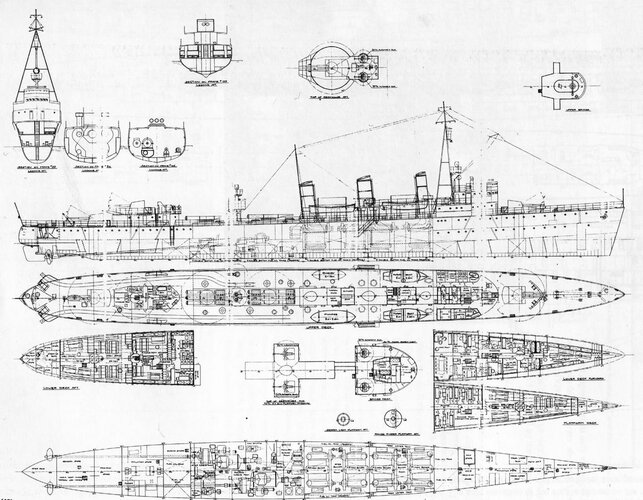

Kockums AB unsuccessful bid for Grom-class. Two versions (from May and August 1934), differed by dimensions and type of AA guns.
1610 or 1850 tons standard displacement, 38 knots, three twin 120mm and two triple torpedo tubes.

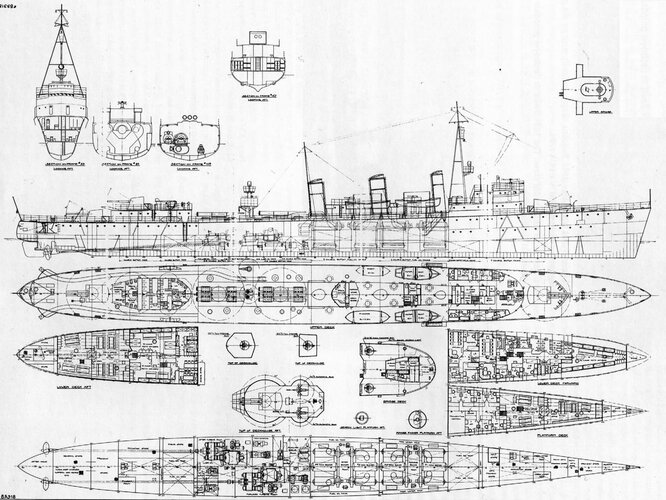

First project Samuel&White in photo

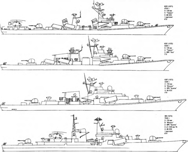

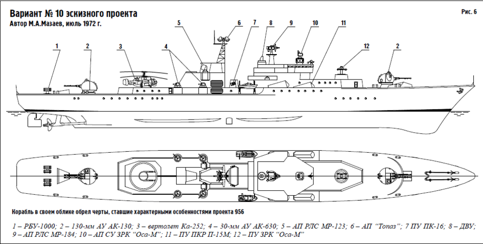

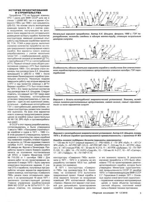

Export Version of Pr. 956 Sovremenny with less advanced equipment
Due to the political situation, a version of the Sovremenny with less advanced equipment was proposed, but this plan was cancelled by 1981.
armament: 2 doubled AK 130 guns, but variants with AK 726 or AK 100 cannons were prepared as well, which were replaced the AK 130 cannons.
Moskit 2xIV anti-ship system replaced on P-20M 4x1,
AA system Uragan [M-22] replaced on two [4K33] Osa M,
[MR710] Fregat M radar replaced on [MR310] Angara M radar,
And the Platina sonar station was replaced on Titan 2 or Argun.

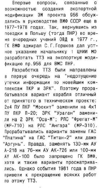

Work on the export version for Poland lasted from 1977, Gorszkow himself ordered the development of an export version for the Polish People's Republic in 1977, when he returned from exercises from Poland, these works lasted until 1981. No drawings and more details about project.
From "Morze Statki i Okręty wydanie specjalne 1/2015" article "ORP Warszawa(II) po co nam był ten niszczyciel". Info apparently from "Poslednij eskadriennyj minosiec WMF SSSR". Any more information would be from the Russian side which is difficult to obtain at present for obvious reasons.

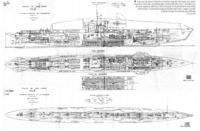

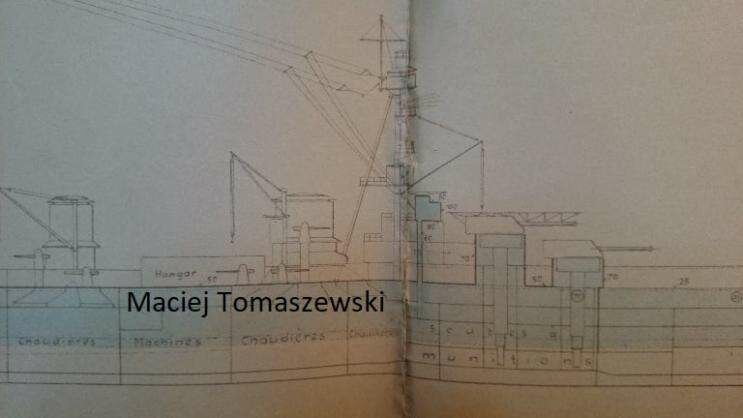

In 1923, the Poles were getting ready to take over the cruiser, which is evidenced, among others, by the found post (from 1923) of Cruiser N.1. It includes not only the personnel composition (commander commander, 21 officers and 488 non-commissioned officers and sailors) but also the planned armament:
8 guns of 150 mm caliber,
4 - four-inch,
2 - three-inch,
10 - 47mm,
4 machine guns,
300 naval mines.
It is probably about SMS Emden konigsberg II class which fell to France.
A hypothesis was put forward, in my opinion, that it was Emden during a historical session at the Polish Army Museum 90 years of the Polish Navy: 1918-2008 in 2008.

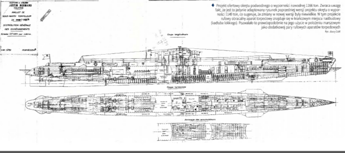

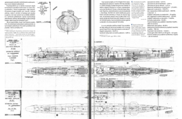

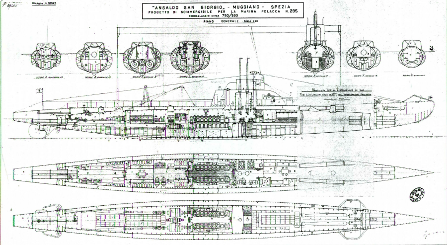

In addition, it was planned to build new submarines in a Polish shipyard, the first two submarines were built in France before the war broke out, but I don't know if it was abandoned.
Considering this, the only solution would be to order the cruiser abroad.

In Warship 42 was the article Pride of Poland: the Orzel class submarines part 1 published by Prezemyslav Budzbon. On page 81 he deals with the tender by the French shipyard Chanteliers et Ateliers Normand, Le Havre and mentioned that there were 6 versions of the 5751 design of which the 5751C was approved in 1938 and ordered to be deliverd in 1941. Anybody familiar with the specifications of the six variations?
I will say that I haven't read this article, can you provide screenshots or pdf?
I will attach what I have.
1. Augustin Normand project 5751B submarine for Poland with a surface displacement of 1166 tons
Augustin Normand projekt 1166.png 2. Full blueprint of a submarine for Poland project 5751C, contract variant by the Augustin Normand shipyard with a displacement of 1176 tons. At the top, the theoretical lines of the submarine variant with a displacement of 1163 tons.
Maximum length 86.870 m
The maximum width on the waterline is 5,900 m
Draft amidships 4.216 m
Draft on the bow perpendicular 3.256 m
Draft at the aft perpendicular 5.176 m
Standard surface displacement 1,175,450 tons
Standard draft displacement 1,530.579 tons
Number of screws 2
Maximum surface speed 20 knots
Maximum speed submerged 9 knots
Maximum power of internal combustion engines 5400 Horsepower
The power of the drive electric motors is 1200 horsepower
The armament of this submarine in the contract variant is interesting.
two twin Bofors 40 mm L/60 anti-aircraft guns so 2xII( U flak say hello there)
8 fixed 550 mm torpedo tubes
2 twin sets of 550 mm swivel torpedo tubes.

4. This time another submarine project called type E of the same shipyard, dated December 8, 1924, also offered to Poland

7. Blueprint italian CA offer for Poland in 11 may 1925, im confirm in 100% is this Trento mod, im posted previous black graphic CA.
A fragment of the plan was once posted by Maciej Tomaszewski on one of the groups on FB.
And from what I know, his name was Piłsudski.
- Total length 199.5 m;
- length at the waterline 195.0 m;
- maximum width 19.0 m;
- draft for sea trials 5.8 m;
displacement:
10,980 tons;
- machine power 125,000 hp;
- speed 35 knots
- 4 sets of turbines 10 boilers;
- fuel supply 2,400 tons;
- fuel reserve for sea trials 760 tons;
Armament :
- 8x203,
- 12x102,
The 102 mm anti-aircraft guns were placed singly.
8 Tubes .
The rotating torpedo tubes were placed in pairs of two below the deck.
- Deck armor 50 mm in the area of main artillery turrets 70 mm, side armor of the citadel 70 mm and towards the bow and stern, decreasing to 25 mm.
As I wrote or not, the original is in the Polish archives, it is a fragment of the drawing of this ship, probably the original plan as I see, or a reprint or something like that. I got this drawing with details from a person I know.
7. Blueprint italian CA offer for Poland in 1925, im confirm in 100% is this Trento mod, im posted previous black graphic CA.
displacement:
Standard 10,980 tons;
- speed 35w;
Armament :
- 8x203,
- 12x102,
8 Tubes .
The 102 mm anti-aircraft guns were placed singly, and the rotary torpedo tubes were placed in pairs below the deck.
On this variant - it is very similar to the Italian 1923 heavy cruiser design that eventually became the Trento-class (any World of Warships players will know this as Genova).
From the images we have, we can see a couple of differences - the Polish design has an amidships hangar, but it has catapults (or possibly flying-off platforms) on at least the B turret, and most likely the X turret, if the silhouette which was previously posted is accurate. Additionally, the Polish version has a single forward funnel, whereas the Italian design has the forward funnels as a split pair. There's also a crane on the mainmast to transport aircraft from the hangar to the forward launch platform, plus another platform on the mainmast.
That ship which someone claims to be the proposed pr. 956 variant for Poland is actually one of the premilinaries of the project 956 itself dating back to 1972 as labeled in the picture. It's from article in Istoriya Korablya 1/2004 which featured quite good history of the project.
Don't be missled by the similar armament suite as in the later offer for Poland.

armament: 2 doubled AK 130 guns, but variants with AK 726 or AK 100 cannons were prepared anyway, which were placed in the places of these AK 130 cannons.
Moskit 2xIV anti-ship system replaced on non-perspective P 20M 4x1,
AA system Uragan replaced on two Osa M,
Friegat M radar replaced on Angara M radar,

Work was interrupted in 1981 due to problems in Poland. I translated what is on the screen.
Maybe in some Russian studies there are some sketches and more details about it.
A trace of this was written in the book Poslednij eskadriennyj minosiec WMF SSSR, somehow the title sounds like that. And that's where there was a trace of the possibility of obtaining this ship, but in the export version.

COLDOWN_Iván — 17.11.2022 07:46
Морская Коллекция year 2018, number 12, publication 231
COLDOWN_Iván — 17.11.2022 07:47

305mm/52 Pattern 1907 — 17.11.2022 10:00
So got more info about that @COLDOWN_Iván.
While in @《》║ Enterprise║《》's source there was a mention of removing the AK-130 for something like an AK-100. Gorhskov and the High Command forbid its downgrade. So the use of the base A-217 mount is allowed. A-217 is the single barrel 130mm that the base AK-130 is based from.
10:00
The draft designs resemble Project 56 on the hull.
10:01
It was intentional as Project 56 was their 'last' destroyer before the 956. Hence the addition of '9' in the numbering
10:02
This became a pattern for destroyer category numbering since. Except 11900 Anchar
Project 56 -> 956 -> 21956
305mm/52 Pattern 1907 — 17.11.2022 13:14
History of the Ship (Istorya Korabelya) 2005-01 (03)
13:14
@《》║ Enterprise║《》
13:19
Clearer image
13:19
Variant 10 of a amphibious support destroyer (Development title for Project 956)
305mm/52 Pattern 1907 — 17.11.2022 15:13
So this was the final 'revision' they were working
15:14
This was after Soviet Naval High Command rejected the 1st Central Research Department of the MoD to downgrade the PRL-destined Sarych's main gun to a 100mm or a 76mm gun

305mm/52 Pattern 1907 — 17.11.2022 19:13
Yes. Variant 10
19:13
Authored by M.A Mazaev, June 1972
19:14
What is odd is the year
Yingpin — 17.11.2022 19:15
yeah that's what was throwing me
305mm/52 Pattern 1907 — 17.11.2022 19:15
Gorshkov authorized for a watered down Sarych for the Polish Navy in 1977
19:15
Unless this one was already in the works and was shelved and 1st CRD use it as a baseline
19:16
Also, the Variant 10 never appeared in Severnoye PKB (The major surface ship designer of the Soviet Navy except carriers) 60 year anniversary book
19:17
They showed 956E, EM, U (With 16 and 24 UKSK VLS). But not Variant 10

I probably could not dig a much deeper hole than "what could be" of the then Polish Navy back then.
Gorshkov had a reason why they would even let Poland have a modern destroyer like the 956
19:28
One clue is his disapproval of 1st CRD downgrading the guns any lower than 130mm
Yingpin — 17.11.2022 19:31
so, as I understand, the Polish design from 1977 was based off of a Pr. 956 variant from 1972?
19:32
And they used that as the basis as it already had the less advanced systems, most likely?
305mm/52 Pattern 1907 — 17.11.2022 19:32
Yes
19:32
But we still need more proof before I close this one
19:33
I have finished making my Capstone Project and currently full of potential energy that I need something to sink many hours into
The end.
And that's basically all the findings so far about project 956 for Poland, you have the whole record of conversations about it.
If anyone has new additional information to the above findings, please post it, if someone has access to Russian sources.
All those images you posted were published originally in the mentioned Istoriya Korablya magazine about the orgins of the pr. 956 and it doesn't mentions that the preliminary design for the pr 956 were later used as the base for the Polish proposed variant. However it does not exclude it either. What I could draft up from the discussion posted above is that some person with in some discord channel is claiming so. What exactly is the source were this claim is based? Aside the apparent similarity in the weapon fit which lures us to belive so?
I'll will check tomorrow what does one of the latest Gangut issue say about the matter, it also has an article about the development of the class.
Indeed based on Soviet project nomelenculture, a Polish Sovremenny should bear the designation of Project 956E or a variant of it like 956.1E as it was an export version specify for Poland otherwise it would be the same as the built ships.
Note the 4 956E and 956EM versions which all 4 gone to China still they received Russian names:
I doubt the Soviets would design multiple version of a warship just for a single country's export market. Though it wasn't impossible that the design bureau or the builder shipyard offered multiple variants, this is unlikely knowing how centralized was the Soviet Union.
I remember how it is also visible, we searched in several sources, the Polish magazine from which this screenshot is taken, in the article it was written that the Polish version was mentioned in Poslednij eskadriennyj minosiec WMF SSSR, later when I passed it on, we looked for further information in several sources, but the key is the book for which a Polish source is cited.
Since there were no drawings and detailed data in the article, we were looking for answers in several sources, in those that are given in the transcript of the conversation.
However, further information on this matter requires further research and research because I honestly do not know if any early variants of this version for Poland have been developed, and late ones generally before the final version.
Another thing that needs to be explored is the question which is that
if variant 10 is actually the final version for Poland, that's why it says it's from 1972, it's a mistake, or maybe they had it ready earlier and offered it to us?
Currently, there are many questions and few answers.
All I know is what is written above.
The case is open, and more information is needed on the matter.

Back to the Polish Cruiser ....is there more to that drawing fragment or is that all?
Dave
As for this cruiser, apart from a fragment of the drawing and graphics, I have nothing else. At the moment, everything I have about him has already been written.
