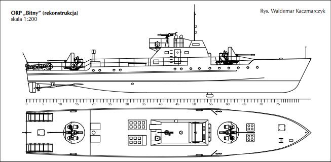

1. ORP Bitny - a former German partisan chaser of the ZPK type, the hull of which was found in Toruń and then completed as a submarine chaser.
It was armed with two single 37 mm 70-K guns, the engine was not changed.
He served only a short time, and there are not many photos of him to this day.
The drawing below shows a reconstruction of this ship(from Okręty Wojenne 4/2010).

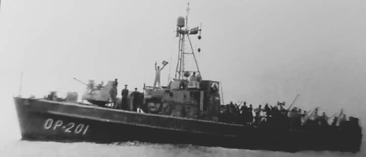

2. ORP Jamno OP-201.
It was a prototype of the Project 9 patrol ship, which was built on the hull of a German R-boat that had been found. It had a 37 mm 70-K gun.
Project 9 patrol ships were the first patrol ships of Polish design (as I remember), later project 902 was built, I will write about patrol ships another time.

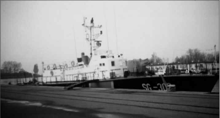

3. Type 205 patrol ships.
These were project 205 missile boats, known as Osa, rebuilt in the late 1980s, there were only 3 units of these patrol ships:
ORP Gdynia OP-301, later SG-301
ORP Szczecin OP-302, later SG-302
ORP Elbląg OP-303, later SG-303.
The changes were as follows: missile armament, main guns, Rangout and MR-104 radars were removed
a second navigation radar and a 25 mm 2M-3M gun were added.
However, they served only for a short time, until the 1990s.
Below is ORP Szczecin, the photo comes from Okręty Wojenne 4/2011.

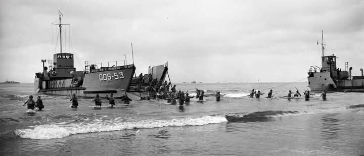

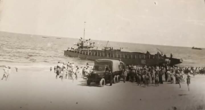

There was an Italian MZ type landing barge, apparently the Germans brought this ship to the Baltic Sea, and then we found this ship and it was incorporated into the Polish Navy.

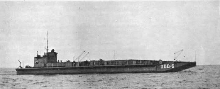

In addition, we used 6 former German MFP landing barges - type D and DM, which were found in the river shipyard in Głogów and then underwent a thorough renovation.
The photo shows one of these landing craft - type DM as ODD-6.
They served in the landing craft flotilla along with American landing craft purchased from surplus in 1950.
These were:
11 LCT mk V landing craft, numbers BDS-50 - BDS-60,
3 small landing craft type LCM mk III - numbers BDM-100 - BDM-102
In September 1953, the flotilla was joined by 6 LCP type landing boats.
The photo shows one of such ships.
I thought I would remind you about these ships, although the American ones are known, the Italian landing barge and the German landing barges are a bit forgotten.

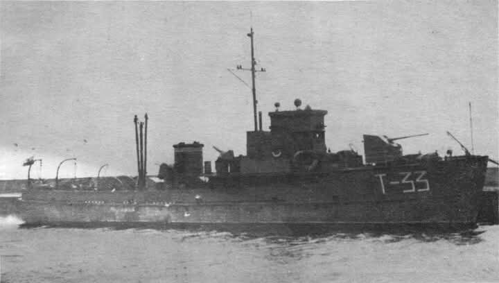

As an addition to the previous post, I will attach a photo of ORP Mors.
It was an YMS type minesweeper, 3 ships of this type were purchased and entered the service of the Polish Navy in 1948, they were named ORP Delfin (DF) later number T-31, ORP Foka (FK) then number T-32, and ORP Mors (MS) then number T-33.
They were rearmed with one 85 mm gun.
The fourth unit of this type entered civil service as Zodiak.
The photo shows ORP Mors with armament, I am giving it as a illustrative photo of these ships with armament.

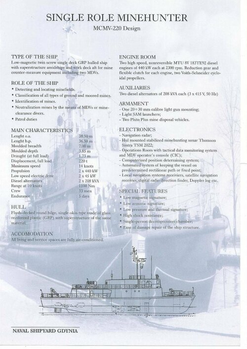

Designs of minehunters from the 1990s offered by the Naval Shipyard in Gdynia. They were to be built based on the hull of project 207 minesweepers.
I found the leaflets on one of the Polish groups on FB.
I am posting them here because I think it is worth reminding about these offers.
There were 2 designs: MCMV-220 which is shorter, and MCMV-207 which is longer.
I don't think I have anything more to say about them, the information is on the leaflets.
MCMV-220:
MCMV-207:

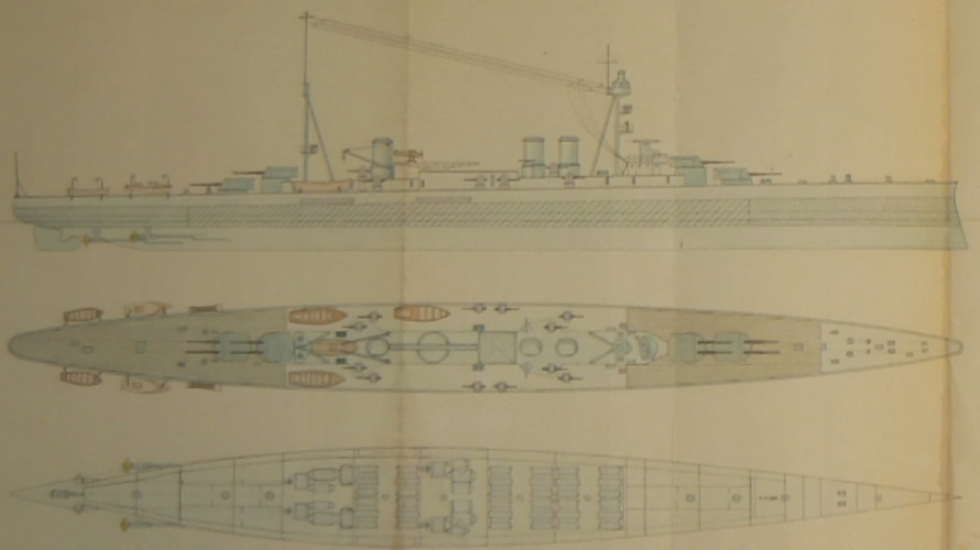

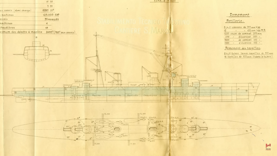

2. The offer of the Stabilimento Tecnico Triestino (STT) shipyard dated May 11, 1925.
I posted this offer here, it's a well-known trento mod, but today I have its entire silhouette, you can see it in the picture below.
I posted the parameters of this offer here, but I will remind them.
- Total length 199.5 m;
- length at the waterline 195.0 m;
- maximum width 19.0 m;
- draft for sea trials 5.8 m;
displacement:
10,980 tons;
- machine power 125,000 hp;
- speed 35 knots
- 4 sets of turbines 10 boilers;
- fuel supply 2,400 tons;
- fuel reserve for sea trials 760 tons;
Armament :
- 8x203 L/50,
- 12x102 L/50,
8 Torpedo tubes( 4xII) .
The 102 mm anti-aircraft guns were placed singly, and the rotary torpedo tubes were placed in pairs below the deck.
- Deck armor 50 mm in the area of main artillery turrets 70 mm, side armor of the citadel 70 mm and towards the bow and stern, decreasing to 25 mm.
So it looks to me as if the project above was an enlarged but modified version for export of the original project from 1923, specifically for Poland in mind, see different machine power of 150,000 HP, the original project from 1923, later offered to Poland, version 125,000 HP, project 2, and both projects have 8 203 mm guns, 4xII torpedo tubes, 12 guns each 102 mm and have a speed of 35 knots as far as I remember.
As a reminder, both plans were found in Polish archives.
Both offers above were commercial offers and we did not plan to purchase these cruisers, so let me remind you that at that time Poland was conducting negotiations about acquiring the cruiser Dessaix.
Finally, short information about the Vickers Armstrong cruiser offer.
There is a mention (as I wrote earlier) from March 1935 when Vickers started a discussion about building a cruiser for Poland, the price of this cruiser was 2 million pounds.
Unfortunately, it was not possible to find any plans for this cruiser, and I do not know any more details.
Source
The above plans, i.e. copies of the originals and information about the Vickers cruiser, were available on the YouTube channel Wolski o Wojnie film Polish cruisers of the Second Polish Republic. Here link
