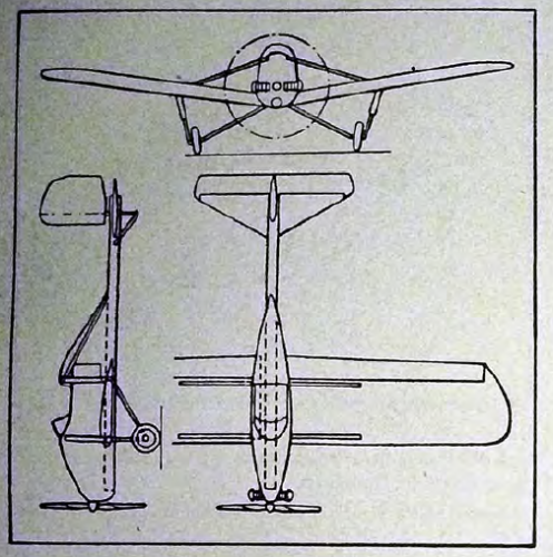

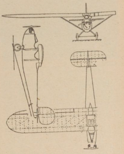

and here is a Daspect monoplane drawing.

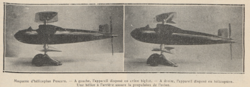

The Pescara Helicopter Model;
http://gallica.bnf.fr/ark:/12148/bpt6k6555017m/f23.image

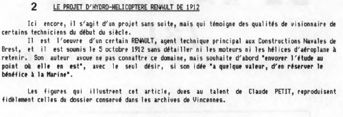

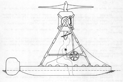

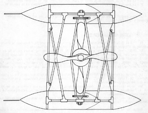

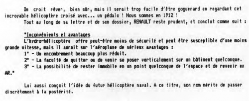

here is a Renault helicopter Project of 1912,from TU issue 122.
With reference to the second illustration in the foregoing post, I'm left wondering whether, rather than being a helicopter, this was a machine for performing trepanations!

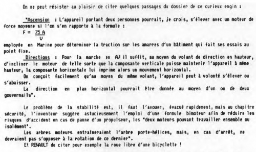

My dear Avion,
here is the rest of the article to can judge.

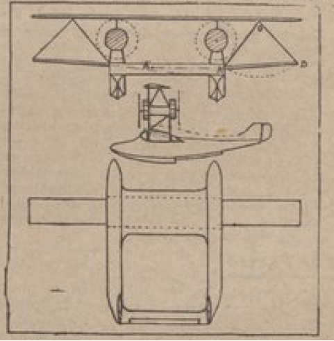

In the Trait d'Union #208 (Mar-Apr 2003): "in 1934, someone named Goudant designed a flying boat with variable area wing. Two half wings (of 6.25m x 2m) disappear inside the the thick wing. 4 engines, speed near 300km/h, not built."
A more Info;
http://gallica.bnf.fr/ark:/12148/bpt6k6576063q/f7.image.r=Goudant%20hydravion

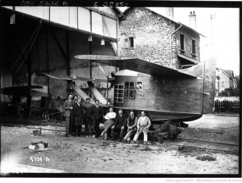

here is a canard seaplane which designed by Charles Nungesser.
http://gallica.bnf.fr/ark:/12148/btv1b9023255f.r=hydravion.langEN

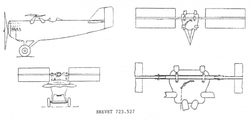

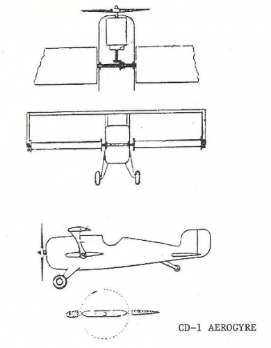

here is a drawing to Chappedelaine CD-1 Aerogyre.

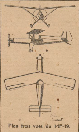

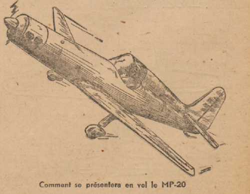

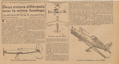

From Ailes 1/1945,

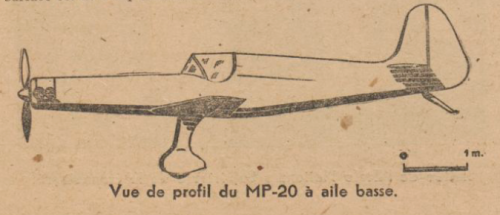

does anyone hear about Maurice Paltz MP-19 & MP-20 light airplanes,maybe a Projects ?.
The answer is completely in the article, you posted:
Maurice Paltz was an aviation engineer, who worked for Guerchais-Roche and Holste and
proposed those 2, or better one-and-a half designs, intended for amateur construction and
designed for easy building. And both designs differed in wing only, the fuselage was the same.

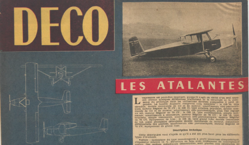

here is Atalante airplanes,the GB.10,GB.12,GB14,GB.16 and GB.18,most of
them were remained a Projects as I know.

It would appear that the Atalante GB-10 survived the war as it had been mentioned in Les Ailes of 14 April 1938. It was designed by G.Bertout (hence the initials GB) for the Société des Avions 'Atalante' and had been constructed by Ateliers Nicolas in Auxerre. Les Ailes reported that had been had been presented, earlier that month, at Villacoublay Aerodrome and that it had been demonstrated at St Cyr Aerodrome.
Just a thought, but wouldn't this 1946 emanation of the GB-10 Atalante be better placed on the post-war aircraft projects board?
This article is mainly about the GB-10, I think, a type from 1938. As I understand (please correct me, if I'm wrong !),
the other types would have been closely related to the GB-10, versions for different purposes/clients and maybe
designed in the time between 1938 and 46. So it's ok, I think, to deal with them in this section here, as long, as we
have no clear evidence otherwise.

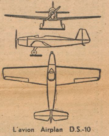

From Ailes 10/1945,

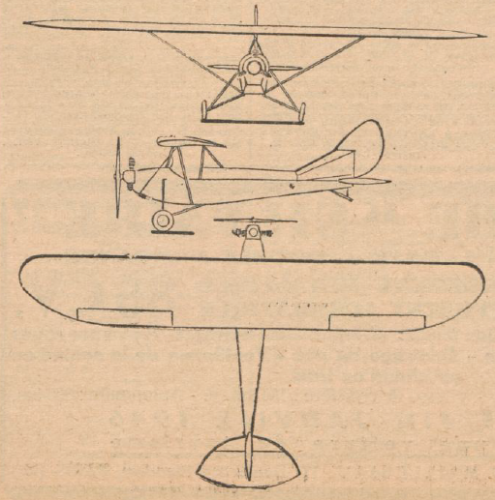

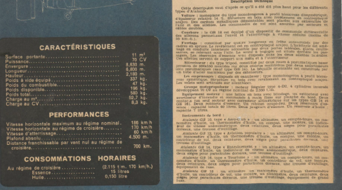

here is a DS.10, a low-wing light monoplane Project as I suggest,created by J. Durandeaux,
in the book; Les Avions Francais 1944-1964,he designed a light aircraft called D.510,or
maybe it was a misprint and they meant DS.10 and they saw the letter "S" as the number
"5" ?!.
Curiously the TU index for issues 1 to 266 contains no mention of Durandeaux and the D.510 or DS.10 and Pierre Gaillard's book is succinct in the extreme in describing it as an amateur built light aeroplane dating from about 1945 (with no illustration). I wonder whether it was realised?

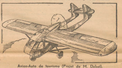

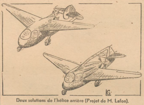

From Ailes 11/1945,
here is amazing two airplanes,from M. Lafon and G. Dabat.

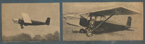

Skyblazer said:
From Avions No. 127, a little-known prototype identified as the "Fellot Lacour" [F-PJCV], christened "L'ancêtre" (the ancestor), though the spelling is apparently unsure.

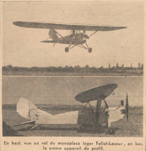

From Ailes 11/1945 and TU magazine issue 91,
here is all of Fellot-Lacour airpplanes,FL.1,FL.2,FL.3,FL.4,FL.10,FL.20 & FL.201

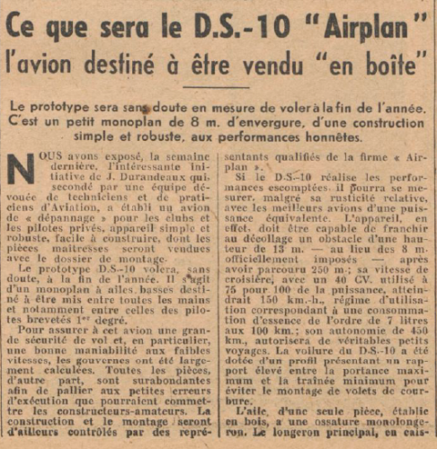

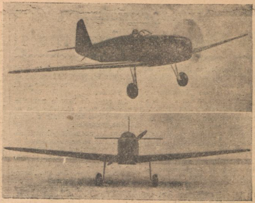

It was actually built,from Ailes 12/1945.
But the text of that report [in translation] says, inter alia, that:
'..... it is the model of this aeroplane that is represented in the two photographs, that we reproduce above.'
and it goes on to talk about the engine which it is envisaged will power the D.S.10 and the tests that it will undergo. I can find nothing in the report that says or suggests that, in December 1945, a full scale DS.10 had been built or had flown. Maybe later reports will establish this. I keep an open mind.

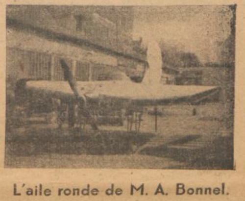

here is a tailless airplane,designed by A. Bonnel,appeared in 1939.
Ailes 1/1946
