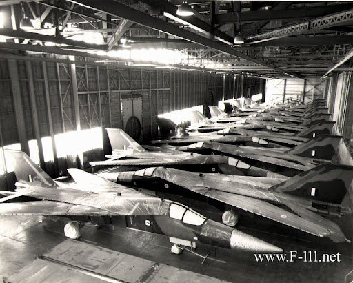

The US DoD was so keen to save the 111K order, for industrial and capability reasons, that they added another $100 million of offsets a couple of weeks before the cancellation ( per AvWeek ).
The UK as a whole was therefore getting the F-111K at nearly a 200% discount, but the Gov budget just didn't work.
By then Australia's F111Cs were being built to be put directly into storage, and the issues were arising about Australia's deal and what exactly constituted delivery of an aircraft as these were obviously not airworthy.
