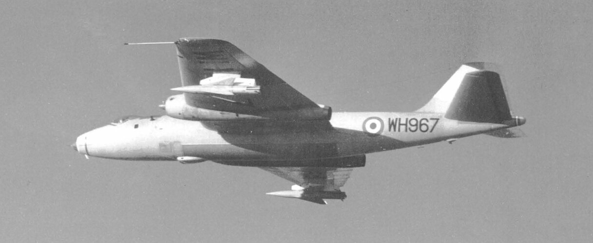

A better makeshift would be fitting the Navy's buddy IFR pods to the Air Force Canberras
Canberras are an interesting missed opportunity… their slow speed made them extremely vulnerable to both ship defenses and fighters. Really not suited to dropping iron bombs.
So how to use them better? Well imagine them instead as an antiship platform with a pair of AS30 missiles (similar to some RAF Canberras).
Canberras would have been perfect for low level stand-off attacks from 5-6nm, especially with a basic ECM jammer.
Fighter escort would have been required, and that’s where the relatively large internal fuel capacity comes in (17,300lbs of fuel including bomb bay tank), as they could have buddy fueled a pair of A-4s flying close escort (armed with 2 Aim-9 Sidewinders - though personally I would prefer them rewired for Magic 1s). Or alternatively the A-4s could have stopped at Port Stanley to refuel (being lightly loaded, they would be able to use the 1,200m runway if equipped with a brake parachute from a Mirage, even in wet conditions) and then you wouldn’t even need buddy refueling.
So imagine 2 pairs of Canberras (8x AS-30 missiles), each pair escorted by 2 fighters, going in low against the more vulnerable outer escort layer (Type 42s) or the T21s doing shore bombardment. In the first 2 weeks the results would have likely been quite lethal, especially if used to open up a channel for Exocet armed Super Etendards to reach the carriers.

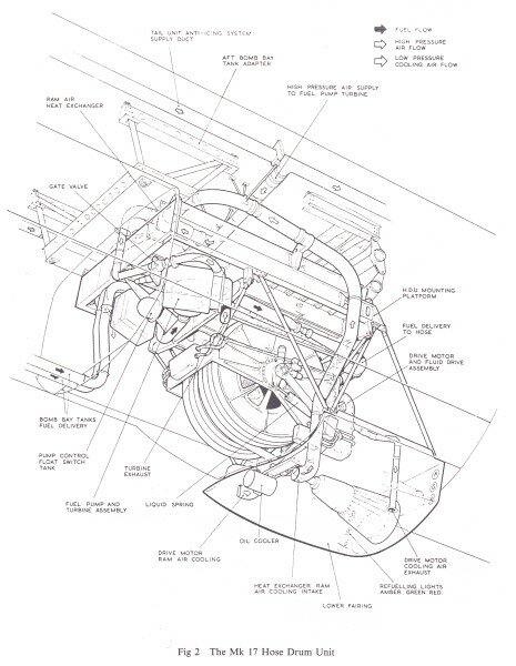

So no big structural modifications at the airframe, just add two drogues at the end of the wings. And then you can put also some colapsible ferry tanks inside the cabin.
You don't just add drogues to an aircraft, they a somewhat sophisticated piece of kit that requires a fair bit of work to integrate into the host aircraft's systems.

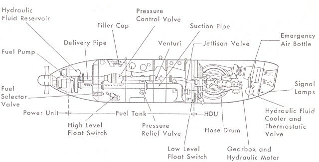

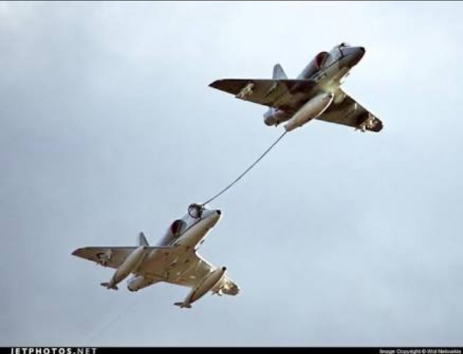

Btw, since we speak of buddy refueling, here is a nice option for the argentinians:
If you already have the fuel plumbing in place and the container of the fuel tank where you can put the mechanism your job is greatly simplified. After all, the buddy refueling stores are based on standard external tansk.

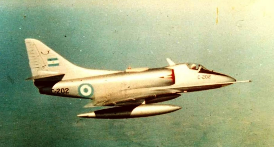

Firstly, those are RAN Skyhawks, I saw them do this trick in NZ service at an airshow in the early 90s.
Secondly, yes, a tactical aircraft can easily attach a buddy IFR store, they already have the hardpoint to attach the pylon to and the connections to fuel, compressed air and electricity that the buddy pod needs.
Thirdly, it isn't particularly difficult to turn an airliner or even bomber into an inflight tanker, by 1982 it had been done dozens if not over 100 times by various firms around the world. However, it is not a job Argentina could undertake within 2 or 3 months in a crisis.
The Argentinian Navy had at least one Sargent Fletcher "buddy" refuelling pod in 1982.
When the 25th de Mayo was preparing to strike the British TF on 2 May, one of the 8 A4Q Skyhawks (serial 3-A-302) was held at readiness with such a pod in case the strikers needed a top up to get them home. The mission was scrubbed due to unseasonally low winds.

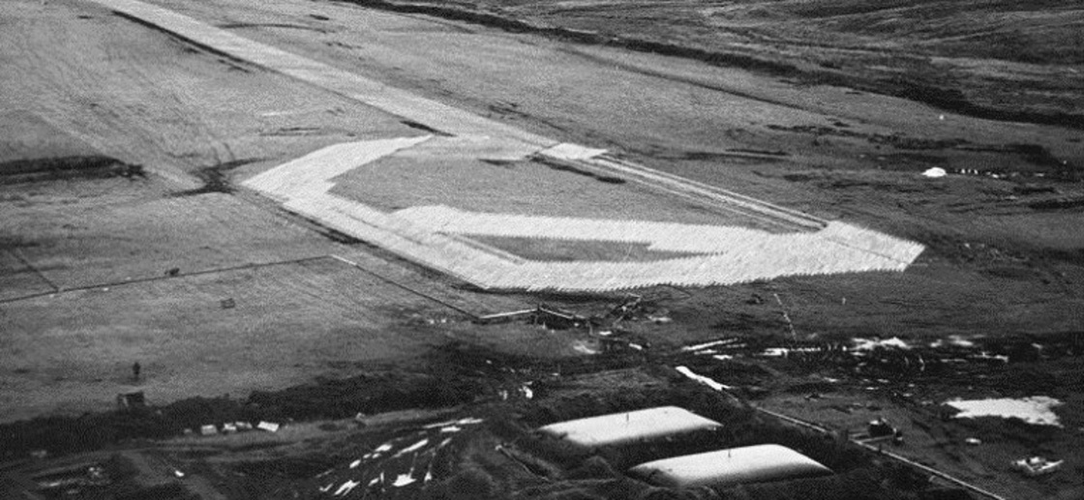

Here is the loop at one end of the Aluminium 'Sids Strip' at San Carlos. I think Argentina should have made something like this at Port Stanley of they extended the strip with PSP, it allows combat aircraft to take off in pairs or flights.
In the 1970s, the Argentine Corps of Engineers built a temporary strip at Hooker's Point in the Falklands using pierced Aluminium planking. This was in advance of the construction of the concrete runway by the British. It operated as the main runway until almost inevitably a strong wind blew it to pieces. LADE gathered what was still serviceable and stored it in a warehouse locally.
So there was already some materiel in the Falklands that rather foolishly the British had allowed to be pre-positioned by the Argentines. They also had planned to send out the plant and additional materiel to extend the strip but in a combination of inter-service rivarly/incompetence army stores were given priority (much of which was still unpacked dockside in June 1982).
A-4Q of the ARA also did some testing of the use of the runway but in truth it was half-hearted. They concluded that the facilities weren't suitable for operating fast jets citing the lack of suitable maintenance facilities. There was some evidence that they made a token attempt to extend the runway in April 1982 but made little progress. What would have made a difference was installing arrestor gear.
They did operator Trackers from the strip, which could have been used later to find the British fleet.
In my personal opinion, failing to make tactical use of the runway was one of the biggest blunders of the war. They could have extended the runway to make it suitable for fast jets, they had the time, materiel and expertise to do so. Having had such a facility forward to simply refuel would have transformed the tactical situation, they could have increased the attrition rate of the Sea Harriers significantly and it would have meant the Mirage III could have operated as interceptors with sufficient loiter time to make the Sea Harriers ineffective. Operating Trackers from the strip would have increased their situational awareness.
So why didn't they do it? They simply never expected the British to respond, they assumed the British were bluffing and being in a far superior position initially believed they couldn't lose. Once the British took the initiative they were always on the back foot.

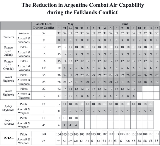

Here are some interesting numbers on Argentine combat capability during the war, taken from "Air Power in the Falklands Conflict : An Operational Level Insight Into Air Warfare in the South Atlantic". This is a great piece of analytical work which uses Argentine sources (Rivas mainly) to look at why Argentina's FAA and COAN failed to interdict British forces.
1) First, Argentina had ~60 attack aircraft available on most days, all the way to the end. This is a large force which outnumbered Harriers by 2-3x (20 Harriers available initially, later reinforced to 28-30 for the San Carlos landings).
So a lack of fast jets wasn't really the issue.

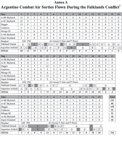

2) Argentina flew 536 combat air sorties over 44 days, including 485 sorties by attack aircraft (if I exclude the 51 Mirage III sorties). On the peak day during the San Carlos landings (May 21st), Argentina's 66 attack aircraft were able to fly 66 combat sorties - exactly 1 sortie per aircraft. On the first day of the war, 76 attack aircraft flew 50 combat sorties - a sortie rate of 0.65 per aircraft.
The problem is that the other 42 days of the war, only 363 sorties were flown... a sortie rate of only 9 per day or less than 0.15 per aircraft.
This low sortie rate was the root cause of Argentina's failure... driven by a mix of poor weather (14 out of 44 days) and most of all lack of targets due to insufficient intelligence (maritime patrol capability) and operating at max range.

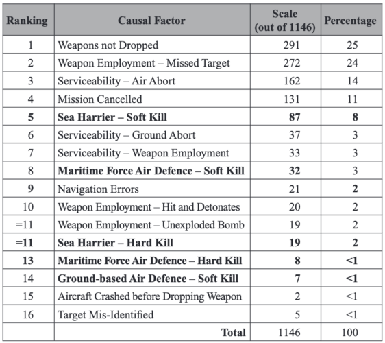

3) Looking at those 485 attack aircraft sorties, carrying 1,146 munitions, the biggest issue was also a lack of success finding targets. Once you exclude the 17% of mission aborts due to technical issues (overall serviceability was actually quite good), almost 40% of missions failed to find targets or where cancelled due to weather and/or lack of targets or navigation errors.
Only about 40% missions found their targets, typically resulting in bombs missing their target (23% of missions) or aircraft being driven away by British defenses (11% soft kills). Only 4% of missions hit their targets and only 2% were shot down, with only 1.5% of attack missions were successfully intercepted by Sea Harriers.

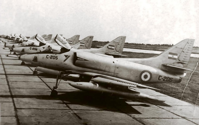

I will give you a source about the History of A-4s in the FAA
A-4B with the first scheme, which includes flag and large cockades, used only while they were with metallic scheme.
The A-4C Skyhawk
The third major event in 1975 was the purchase of 25 Douglas A-4Cs to replace the veteran F-86 Sabres, which would continue to fly until 1986. These aircraft, which were in storage at Davis Mountain, were delivered without any inspection or modernization, and many of them had participated in the Vietnam War, both from aircraft carriers and from land bases. The aircraft differed from the A-4B in having five underwing mounts, had been delivered without the AN/AJB-3 low-altitude bombing system, while the AN/APG-53A radar was replaced in 1980 by a VLF/Omega Litton LTN-211 program 2700 complemented by a Thompson-CSF AHV611 radio altimeter replacing the AN/APN-141 and IFF 2720 TACAN ARN-21, installed in 1979. They also incorporated an autopilot, gyroscopic system and an improved bombing system.
