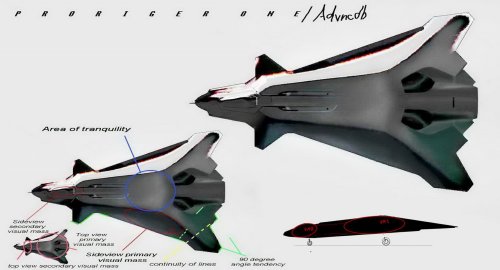

Here is Proriger. It is unfinalised and provides a draft sketch and ideation.

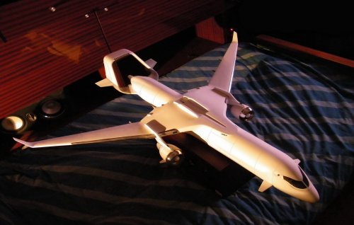

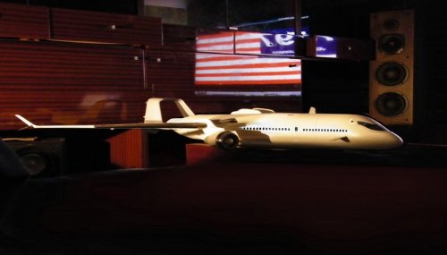

797 `Journeo` revisited.
One version has additional horizontal stabilizers. Maybe that should be established as the final version, I don`t know. But as the whole hor/vert stabilizer section got narrowed down it could necessitate additional horizontal stabilizers.

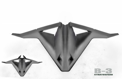

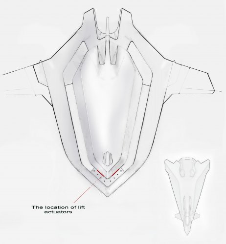

Further development of Proriger. I also added one of the versions of B-3` Stratosfear` , which is unfinalised. It will have a couple of large actuators implanted in front part of the nose section . The wings will be flexible and the actuators by lifting up front part of the wing will control pitch.
As to Proriger- I would like to build actually a mockup. 1:1 size . But I can`t do it alone. It would take about 2 years to build it. If someone is willing to be part of it, is rich and could provide materials, space and tools, shelter and just the basic survival staples such as food, I would go for it without any pay whatsoever. The mockup of course would stay in US, and could be displayed upon agreement. I will also need at least one more person to work on the project, that is a hands on guy on technical issues and would work along me. The best would be a team of 3 people . That would be a great challenge and a new xplane for US . It would be approx. 22 metres long . I know, I sound silly, almost out of my mind, but , think for a moment, there are many aviation buffs, that would welcome such an endeavour.

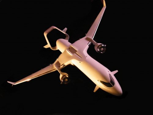

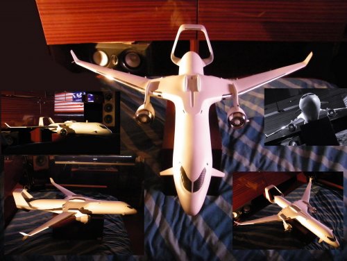

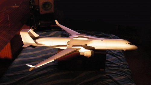

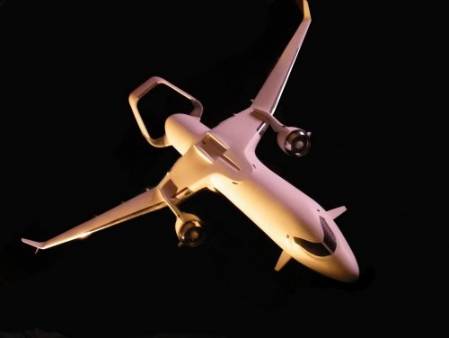

Update on `Journeo`. Plus front view of widebody version.

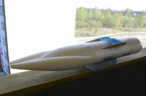

Approximate direction where the Proriger might go. If I endeavour to build it, it will be the most complex model I have ever built. The canopy is not finalised yet.

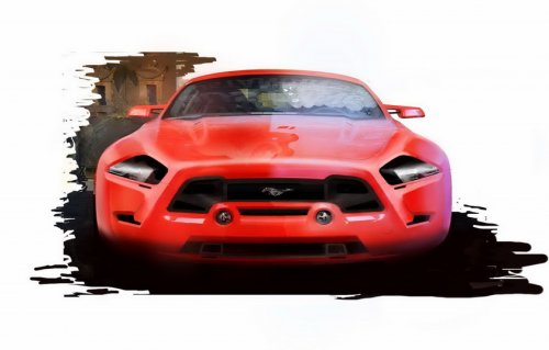

I took the 6th gen Mustang and decided to redesign it.

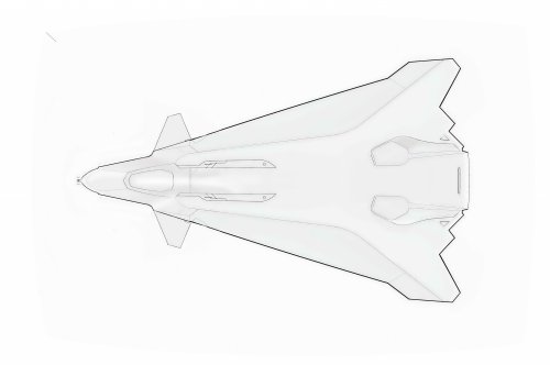

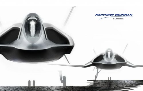

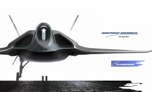

Northrop -Grumman Slamdunk manned version. I might add iso- view later. Hopefully I can post Cargonaut some time later, as I am working on its details. I have given it `a go` and it is going to be built. Thanks.
I don't know - with a wing shape like that perhaps it should be called the "Corsair II" ;)

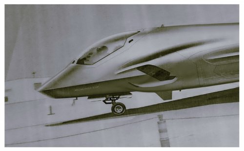

Thank you for following my sketches. Anyhowz, I decided to rework the manned version of Slamdunk one more time as I was not happy with the air intake shape. Here it be.
That is great, the fighter looks even better than the ucav, good work Advancedboy.

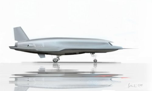

Thank you for your support. This is my first sketch this year- Apex Predator UAV. Stay tuned, be happy:)

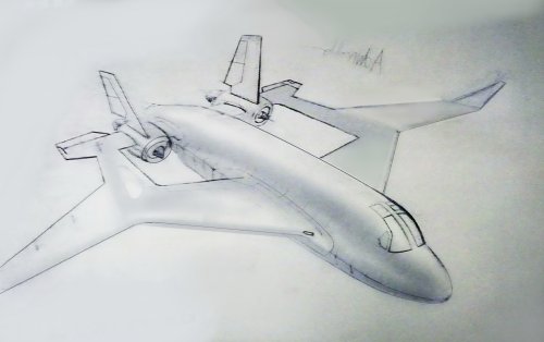

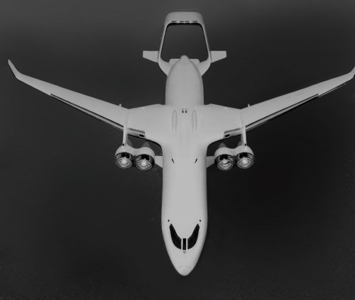

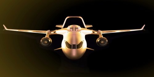

Currently I am working on Cargonaut.( I have started the fuselage) This is a rendering of possible engine configuration for it. It will have a unique fuselage, wings, etc. This pic simply illustrates the possible engine placement using Journeo as a sample. What do you think, will this work?
How do you think your aircraft will fly? Maybe look closer to the size of the control surfaces of your aircraft. And what will the heat of the engines do to your fuselage? and wouldn't it be rather loud?
1. The noise wouldn`t be an issue, as the engines are not directly attached to the fuselage and vibration is not transfered directly. Even if they were attached to the fuselage it wouldn`t cause any problems. ( Check Tu-104 , for example.)
2. The size or rather area of control surface is sufficient, you should check other `Journeo` pictures for a point of reference. This picture is shot from front and perspective of wings gives impression that control surface area is insufficient.
3. I also question that heat would be a problem to the fuselage. As you can see it is apart from it, and the exhaust plume would reach its lateral expansion already in area behind the aircraft.
I would be rather afraid of aerodynamic problems due to the close spacing of
the inner nacelles to the fuselage. Putting the engines further outboard on a single
pylon for each pair shouldn't be a structural problem, I think.
You will have serious structural issues when the wings try to flex, putting loads through the engine struts. You are best off to let the flappy bits flap.
I have seen this on a smaller scale on a helicopter project where an enlarged battery tray was attached to the tail boom and the adjacent fuselage. As the tail boom flexed the battery tray cracked. Beefing up the tray just produced cracks in the tail boom. Detaching the tray completely from the fuselage led to no cracks, and lighter structure.
I might agree with some of your concerns. But I don`t want to remove unorthodox ideas and make the plane....plain. As to wing elasticity, the closer we move to the fuselage the less amplitude of wing movement we have. To compensate the probable wing movement I might add a curvature( to dissipate tension) in small winglets between engine nacelles and fuselage. As to aerodynamic issues dealing with engine proximity to fuselage, I need more detailed elaboration on the nature of probable issues.
ADVANCEDBOY said:
... As to wing elasticity, the closer we move to the fuselage the less amplitude of wing movement we have. ...
Not sure about that. AFAIK, in aircraft with podded engines, the engine weights are used as counter weights to
limit wing flexing. Otherwise the spar would have to be stiffer and probably heavier.
