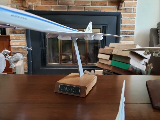

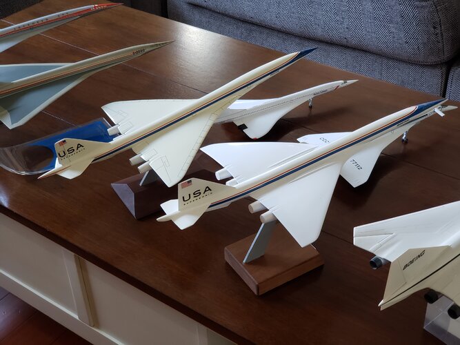

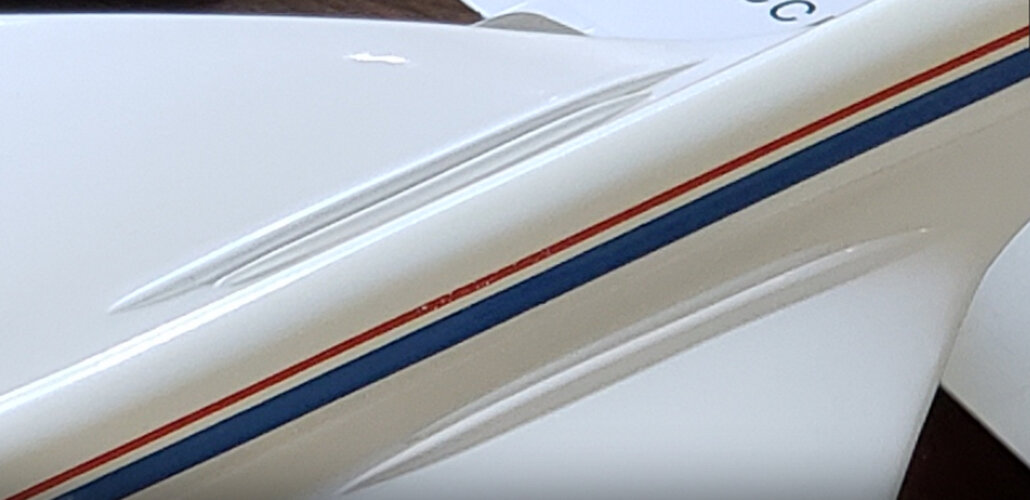

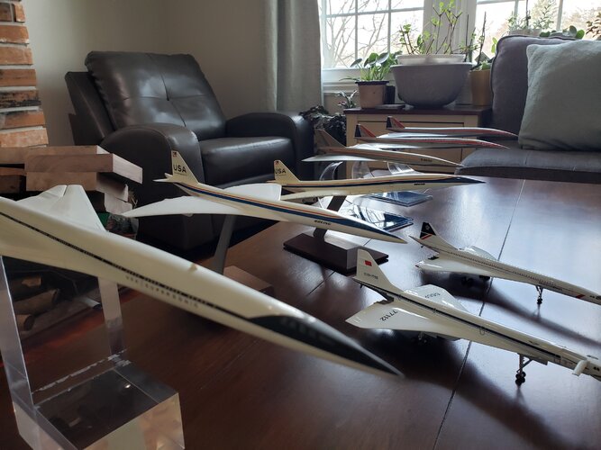

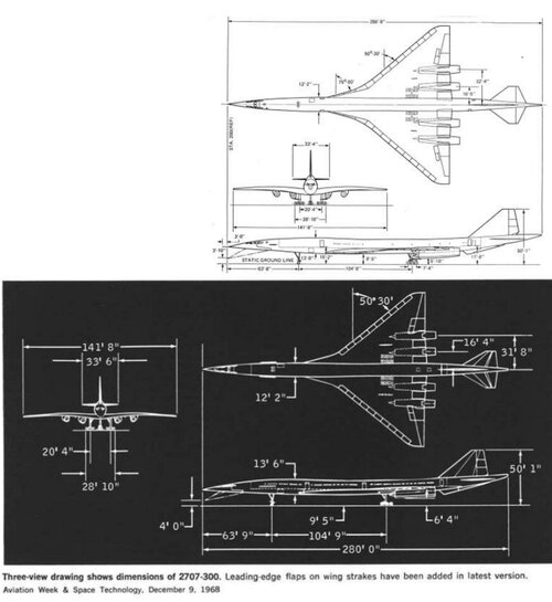

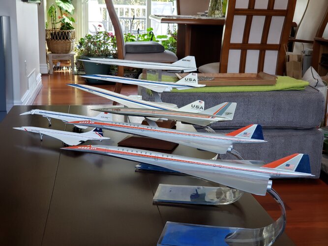

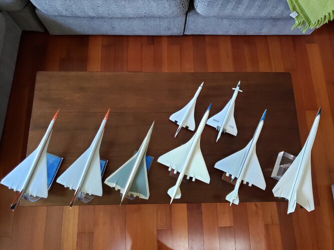

Apologies in being a being out of sync with the topic, thought these may be of interest as well as could get some help if anyone has a bit more info on the time frame differences of these two Factory 1/200 scale 2707-300 models?
I believe the one on the Right side with the twin main wing bulges is the earlier 2707-300 as used by Boeing in film and executive photo opps (also has small twin main wing strakes underneath) and they both later seemed to be removed according to drawing etc, with the one without being the later close to final version?
Hi!
Please compare horizontal tail stabilizer trailing edge shape.
If those models are all together in your collection could we see them compared as they are all 1/200 by the look of it.
Yes all are 1/200, though I do have 1/100 factory model as well as several of the early 1/250? Scale 733 chrome models.
I know the 2707-300 without speed bumb bulges was pacmin, im trying to find out more about the 2707-300 with, as it seems to hold more significant history as pictures of it exist in the possession of many on the program.

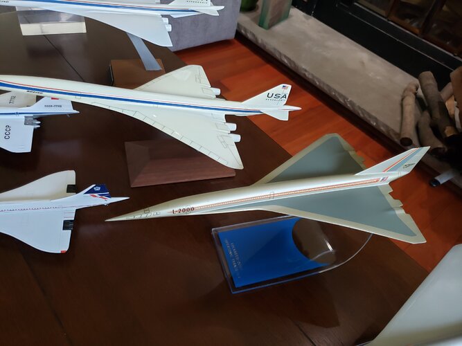

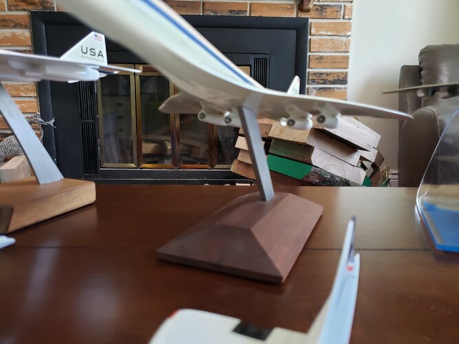

How would you like to see? Two, three at a time? I can plenty more pix. 20240112_124515.jpg 20240112_124153.jpg 20240112_124145.jpg 20240112_124140.jpg 20240112_185726.jpg 20240112_125514.jpg 20240112_123843.jpg sddefault (1).jpg 20231230_115347.jpg
Thank you. I am a serious fan of the US SST but have no original manufacturers models. The photos you have posted above are fine as they show the relative sizes of the real aircraft.

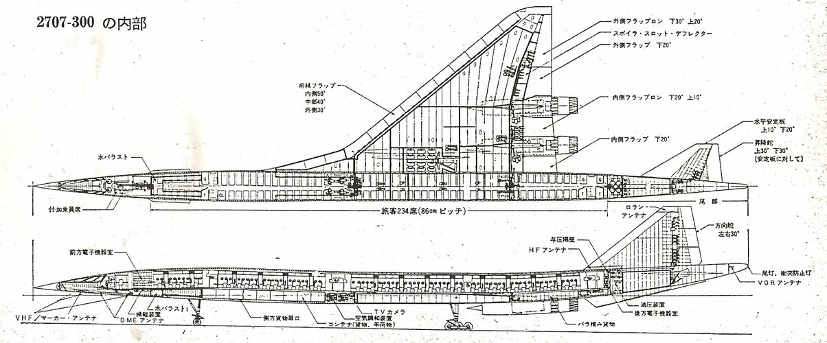

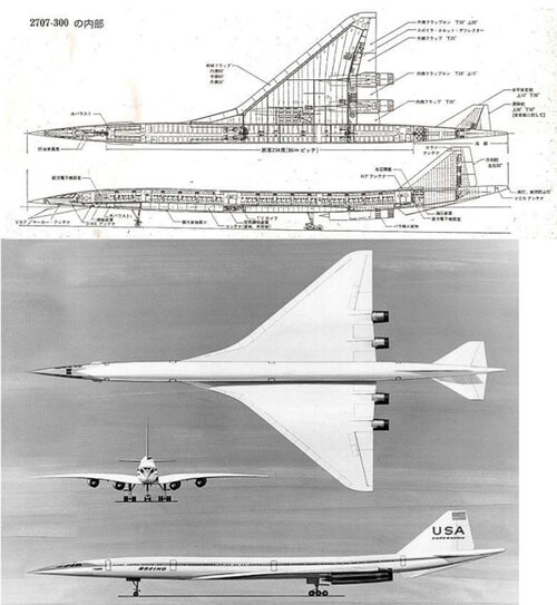

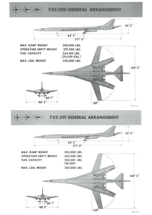

I think that bottom drawing shows final design.
(1) Smaller front strake.
(2) No bulge on the wing.
(3) Smaller wing root leading edge flap.
(4) Perhaps thick wing.

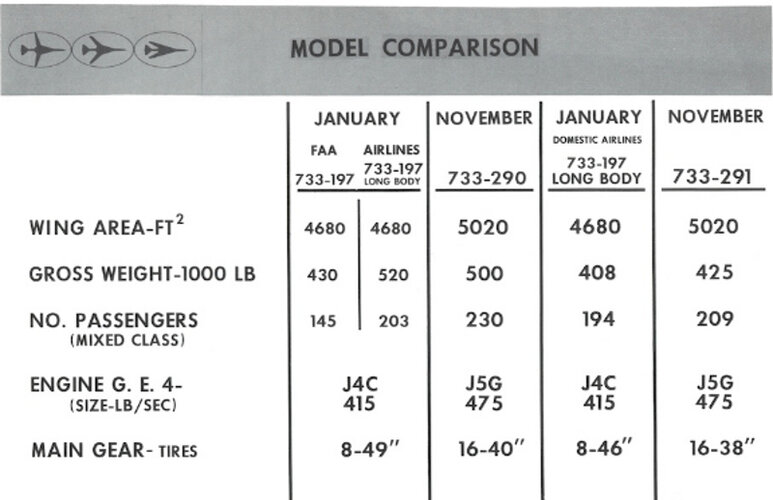

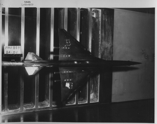

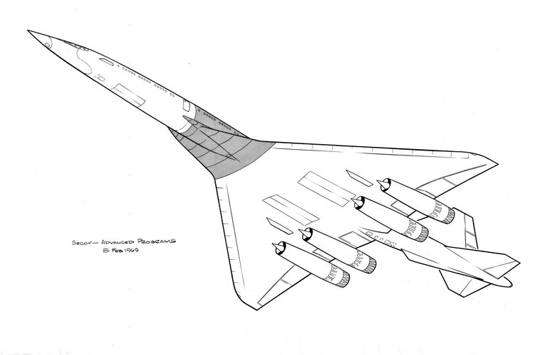

Here are a few more of the bulged and the lower strakes...

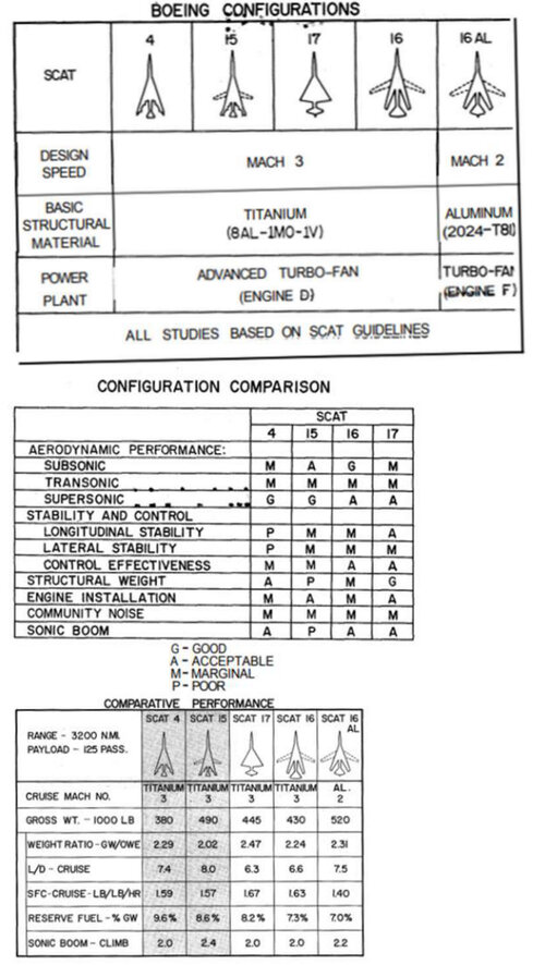

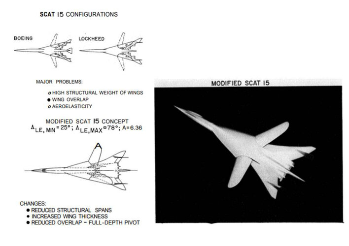

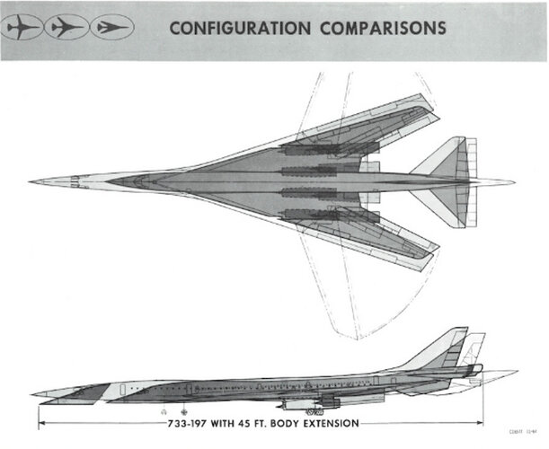

The design of the SCAT 16 led to the design of the 733 and the 2707 with variable swept wings, and the design of the SCAT 17 led to the design of the 2707-300.

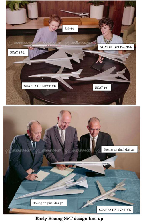

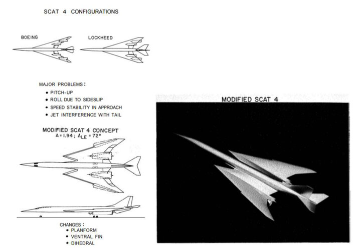

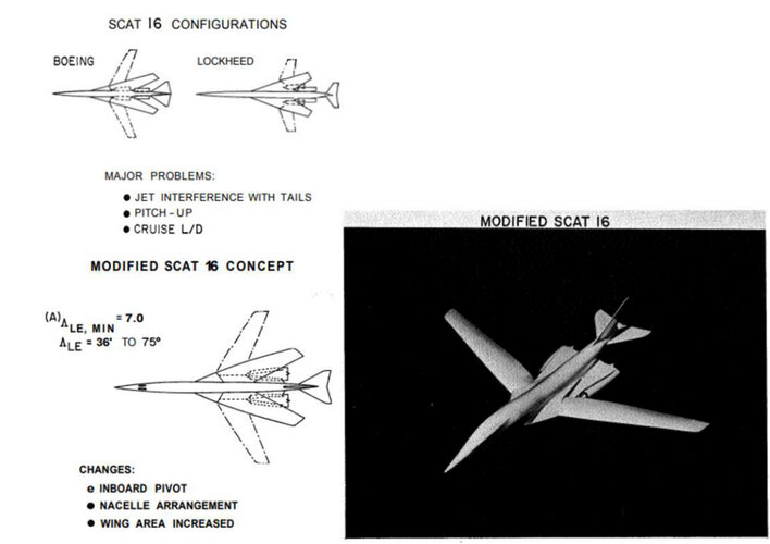

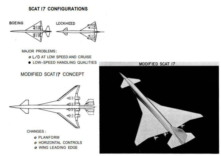

Hi!
SCAT-18 was a modified SCAT-4.
Modified SCAT-16 was a base of Boeing 733.
Modified SCAT-17 had a double delta wing.

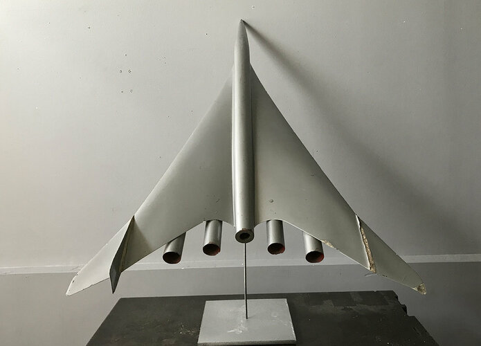

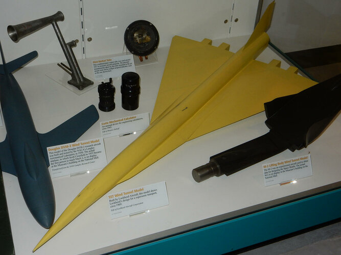

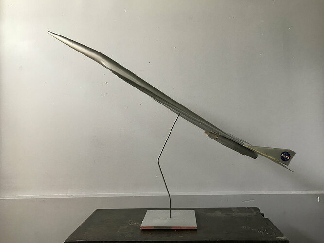

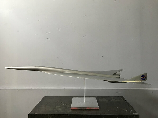

Hi! SCAT-15F-B1 wind tunnel test model.
I imagine that F of SCAT-15F means fixed wing.
Explanation of this model is as follows.
We recently acquired a rare 1960's aerodynamic test model for a NASA SST (Super Sonic Transport) vehicle from Langley Research Center. This model is rather large and is built of wood and composite materials. One rear fin has the NASA logo -- finish and condition is original. The piece measures 51" L and has a max width of 24". Everything is in tact with the minor exception of one rear fin. Wear has some dings and chip paint in areas. These Langley Aerodynamic models are very rare and as you can imagine and these were used in what is called the free-flight technique where they are tethered and float in the wind tunnel for study. A variety of designs were tested and this is one in the spectrum of craft. Reference the video for a demonstration of this type of craft in free flight testing. These video segments are courtesy of NASA Langley Research Center.

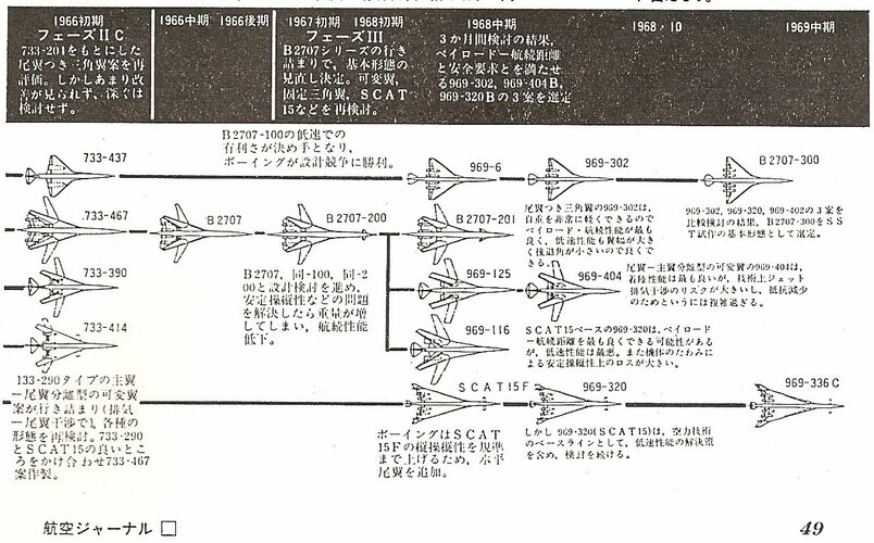

Perhaps this picture shows Boeing 969-336C SST wind tunnel test model.

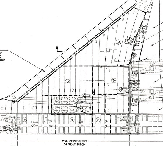

Has anyone ever seen a line drawing, plan, model or anything of the Boeing 2707-300 wide body 7 abreast 321 passenger variant? We have all seen the 280 foot 234 passenger, 286 foot 258 passenger, and the 298 foot 298 passenger versions. So I'm thinking Their had to be at least one illustration of the high capacity domestic variant.
I speedily found that; never saw any internal picture of the domestic version. Will try to find some more info.
