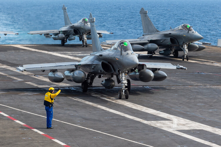

2 - France does have a smaller carrier, but for quite a while planned to follow CdG with a version of CVF.

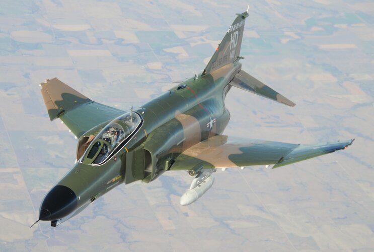

TFX was just people looking at F-4 Phantom and saying "wow that's great, do it again!" though.
