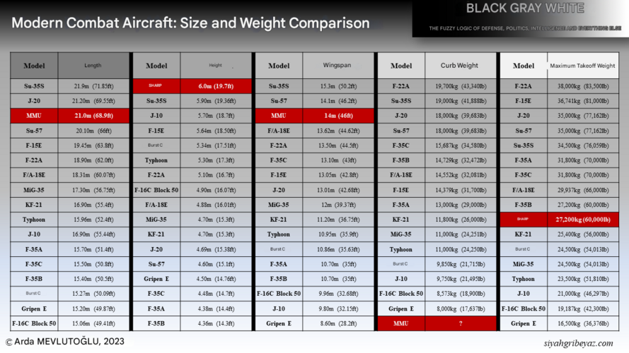

(machine translation, cc for the original: @orko_8 /siyah gri beyaz)

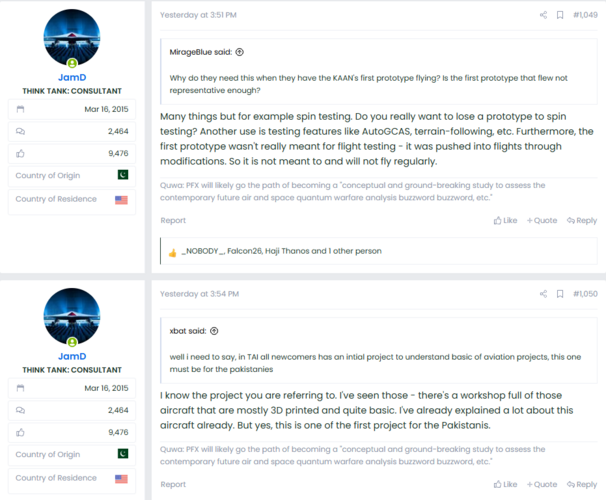

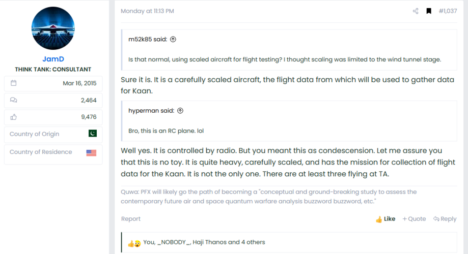

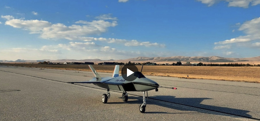

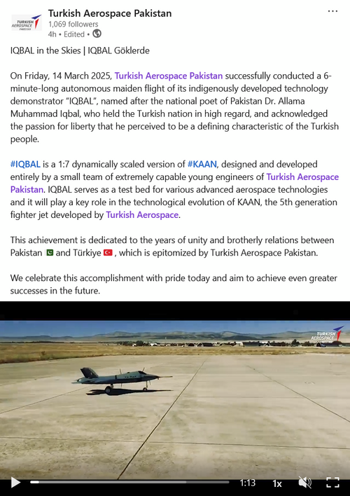

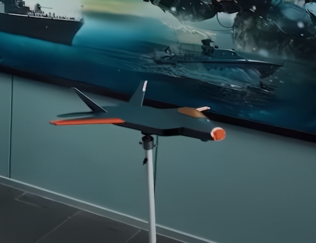

Hmm? Allegedly a scaled-technology demonstrator for Ka'an was tested.
Just something to keep the Pakistan office busy and to have something to show to local officials.
TAI headquarters in Ankara probably flew a couple of these even before the GTU-0 was assembled.

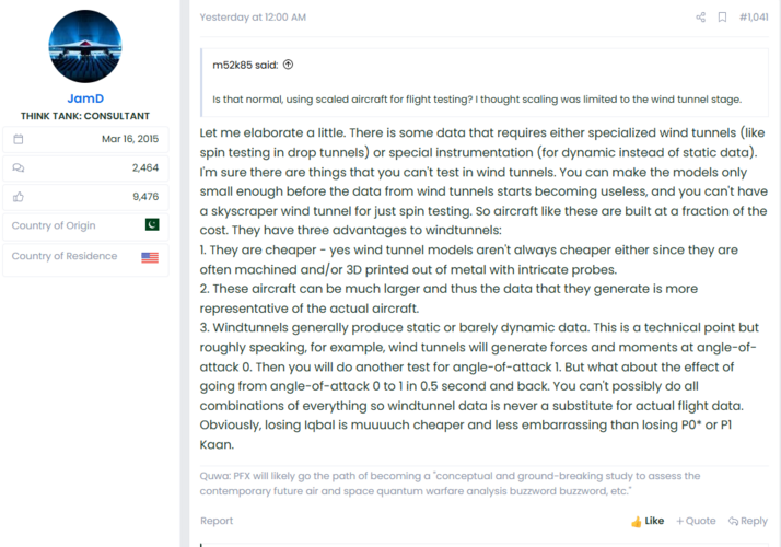

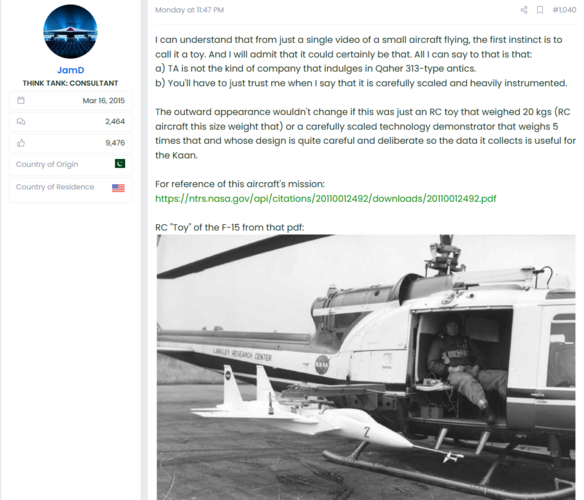

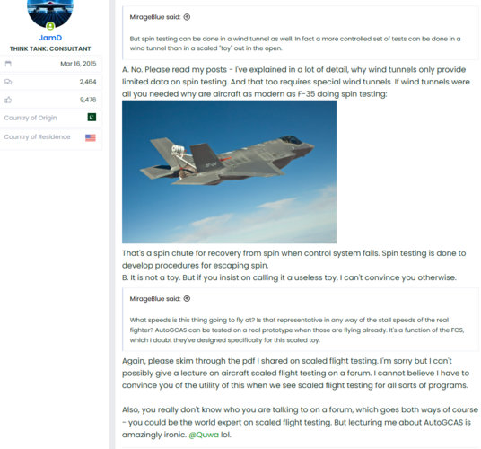

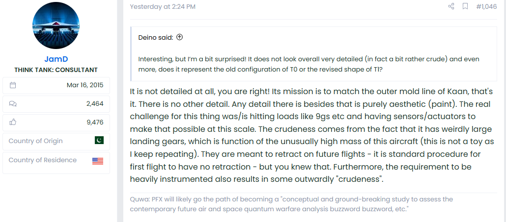

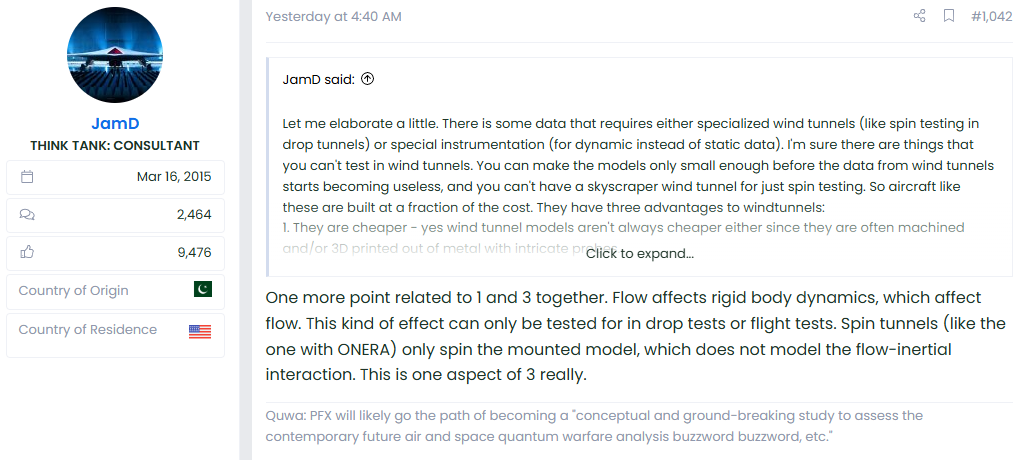

I also believe it is necessary to share @JamD's remarks, as he is an engineer in the industry. (I also suspect that he works at TA Pakistan or at least has colleagues working there.)
Screenshot 2025-03-19 095017.png Screenshot 2025-03-19 095100.png Screenshot 2025-03-19 095109.png
Screenshot 2025-03-19 095313.png Screenshot 2025-03-19 095954.png Screenshot 2025-03-19 095710.png
View attachment 763519View attachment 763520View attachment 763521
View attachment 763526View attachment 763529View attachment 763528
Yeah. My opinion as well. Prototype of Kaan is much further along when you look at amount of details like sawtooth in weaponsbay/panels. They won’t risk flying a prototype unless they’ve had verification of the basic aerodynamics earlier.

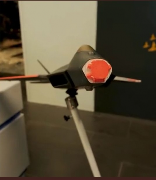

Should be Aselsan BURFIS FCR.
Not sure what's going on with the leading edges of the model which are also painted orange.
I believe this radar is more of a technology demonstrator than a prototype for a production model radar. Same was done for the F-16 radar which they displayed a demonstrator using brick modules some years ago which is different from the tile arrangement on the Murad 100 series.
Those LE could be EW or an Su-57 style L-band radar.

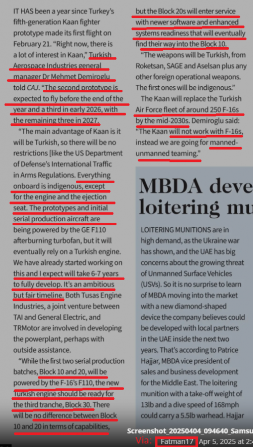

Here’s a good summary of what’s to come in the Kaan program by GM Mehmet Demiroglu, including future developments and milestones.
So the old definition of block 10 has been split into two blocks of block 10 and 20 now? and 6 prototypes in total. Quite some notable changes to the plan if we consider what we were told some years ago. I feel they are really quick in reflecting what they've learnt in terms of programme management and development processes, good for them.
6-7 years seems rather ambitious for a domestic engine fit for a large stealth fighter. For comparison, we just have to look at how long the development of the WS-15 and AL-51 took. Both developed by infinitely more capable nations with regards to their prowess and experience in the military aviation sector. Neither engine in frontline service to our knowledge in April 2025.
So how is 6-7 years an "ambitious but fair" timeline? Domestic development and production of military spec engines is arguably one of the most difficult and costly things to master.
I think 2018 was the test flight date for the AL-51 and supposedly it will be on the Su-57's that will be produced this year which in total is a time span of 7 years, in other words 6-7 years seems feasible for the KAAN
Let's wait and see ... they have to prove their IMO overambitious claims, not we have to explain them again why it is unlikely.
And even more flight test is only the last part of the development, so since the Turkish side so far has nothing built and even bench tested yet that is at least close to something that can be tested in flight, it is IMO totally unrealistic. But let's wait.
