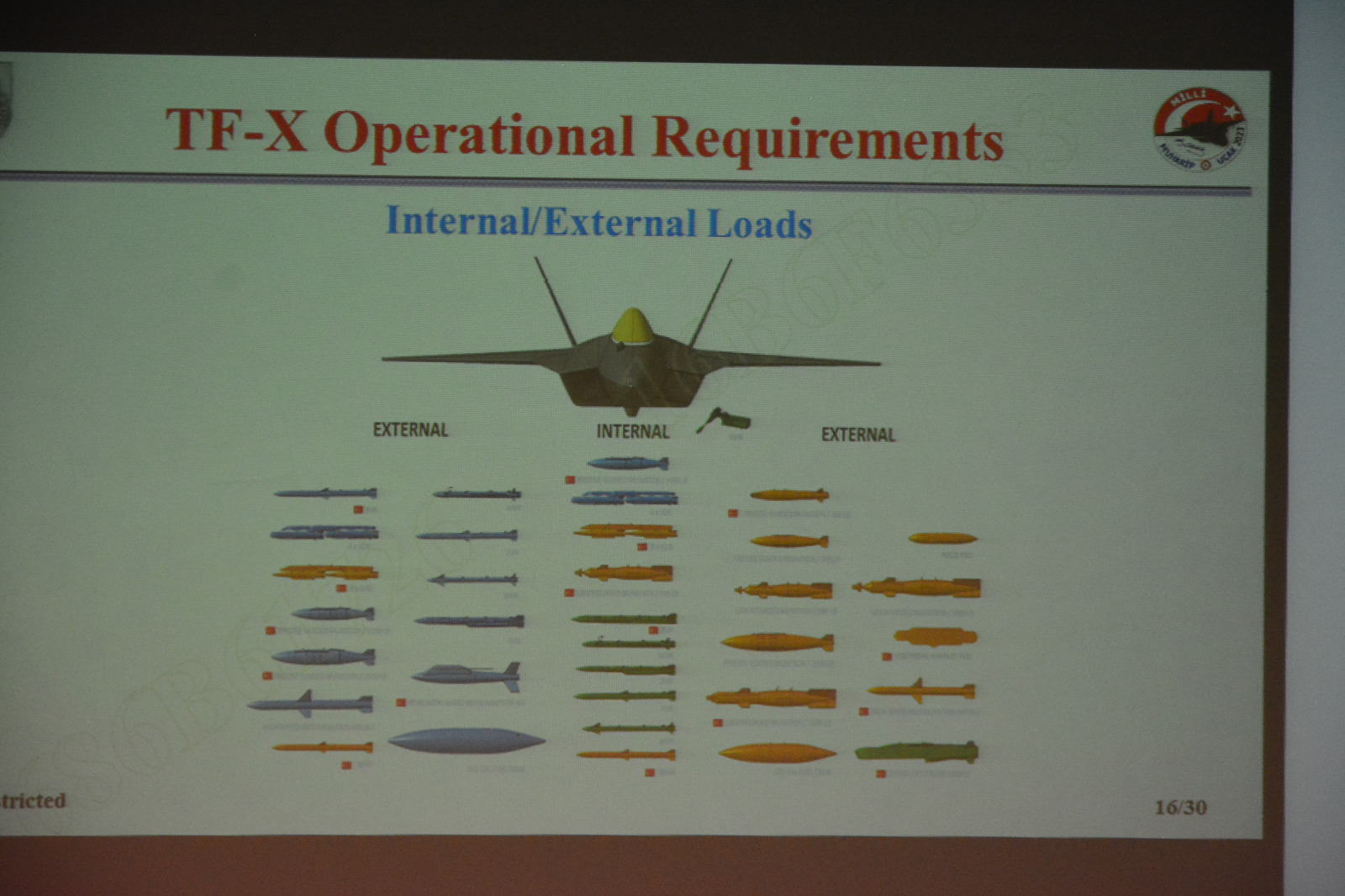

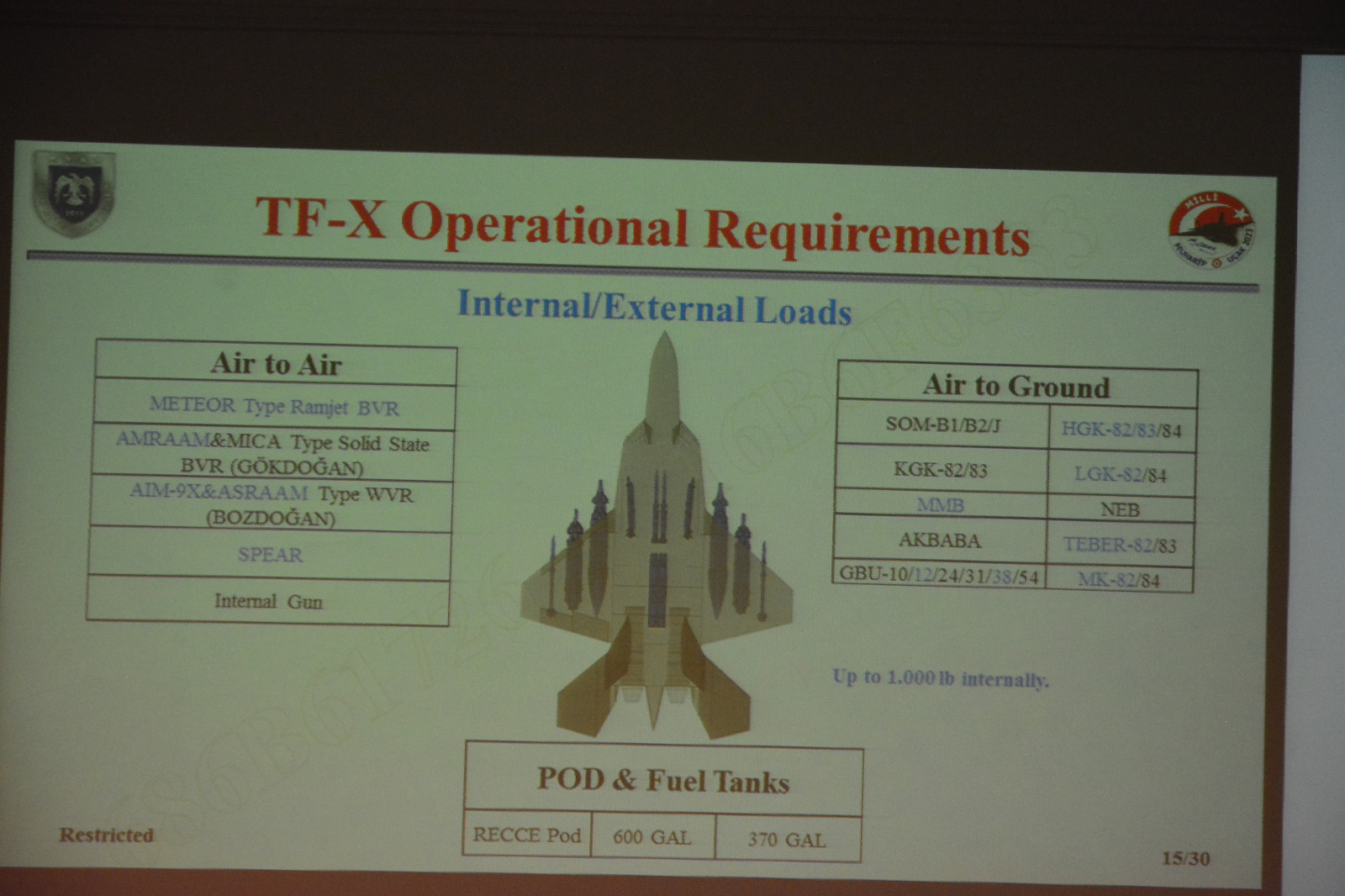

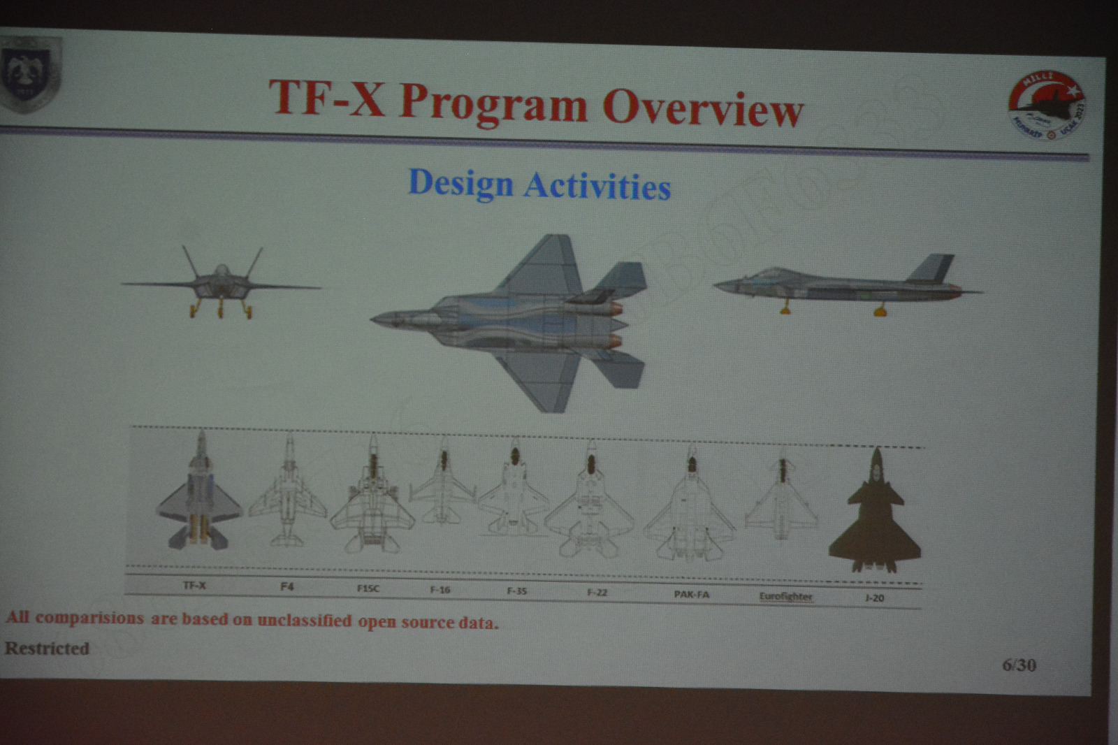

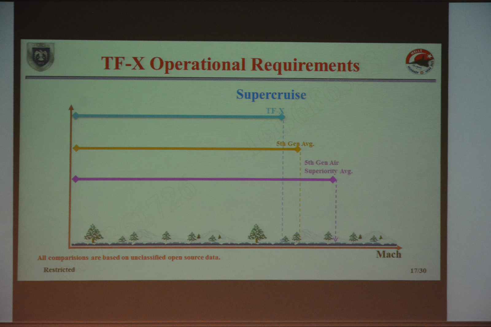

From an old presentation at Anatolian Eagle '21: (there are lots of changes but it is still useful)
