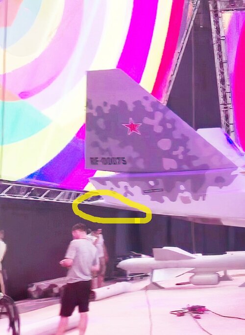

So... no elevators between the tail planes? Or... do those antenna housings have a bit of an ability to move up and down for trim? There are lines which are suggestive. Seems a bit unlikely though.
P.S. This is pretty sophisticated marketing... adding an extra few frames and re-releasing the video... I wonder if there will be a couple more extensions of it? It is also interesting how the video subtly indicates UAE as a partner in the project, and Argentina and Vietnam as having expressed interest.
I see the lines and articulation rather clearly and would assume the updated trailer settles that topic, I designed my model with the function in mind and the results is essentially identical... but it is clear everyone is entitled to their own opinion until we don't see it move
EDIT: I forgot to say, that the small notch in the lower side of the canted tails is most probably there to avoid contact with other control surfaces, in this case when the first are moving inwards and the elevators move upwards.

yeah those are some small 'elevators' there
What is your opinion about their main function? Trimming mainly, or also pitch authority for manoeuvring? Backup of the TVC? As far as I know, this is the first time since MFI that such elevators are installed on a recent fighter...

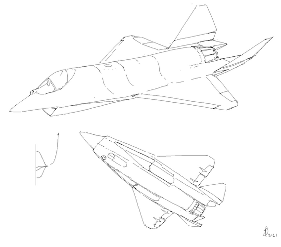

Hi guys, here's my reconstruction of it.
I believe it is likely there are small movable horizontal planes flanking the nozzle, possibly for thrust entrainment, and it is possible this aircraft may not have TVC nozzle.
I also believe the tips of the LERX chines have a blunt chisel planform much like the F-35's inlet-strake relationship. My inspection of the desktop model supports the inlet lip terminating at the root of the chine, not at the outboard edge. I believe that the recent sideview reveal was taken at a carefully chosen angle where the end of the chine happens to be aligned with the intake lip in order to obscure this issue.
Hmm... maybe not small, maybe thick is the relevant word :)
Makes sense. I saw the lines too, I just didn't want to jump to conclusions...
They are thick enough that it almost suggests 'polymorphic' rather than 'control surface' in my mind... but that is probably just an irrational reflex to a bit of novelty.

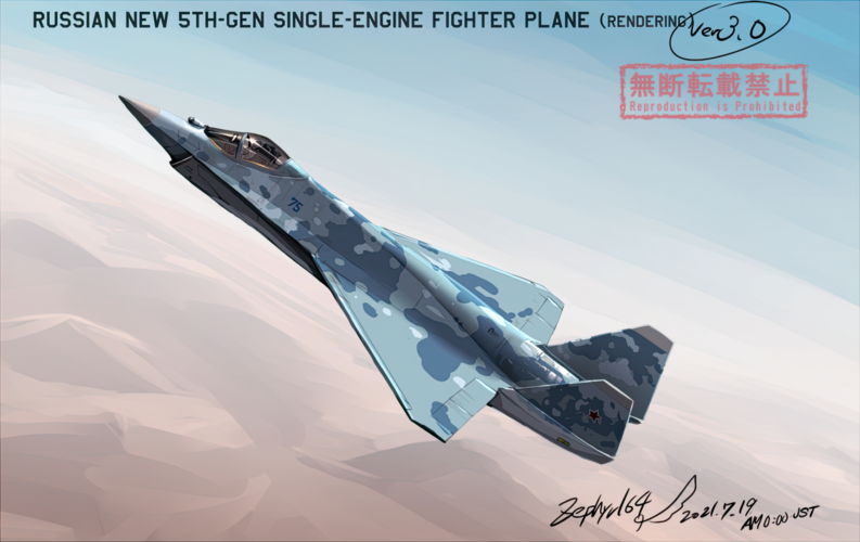

via Zephyr164 / Paralay-Forum
all 3 versions of Zephyrs Checkmate

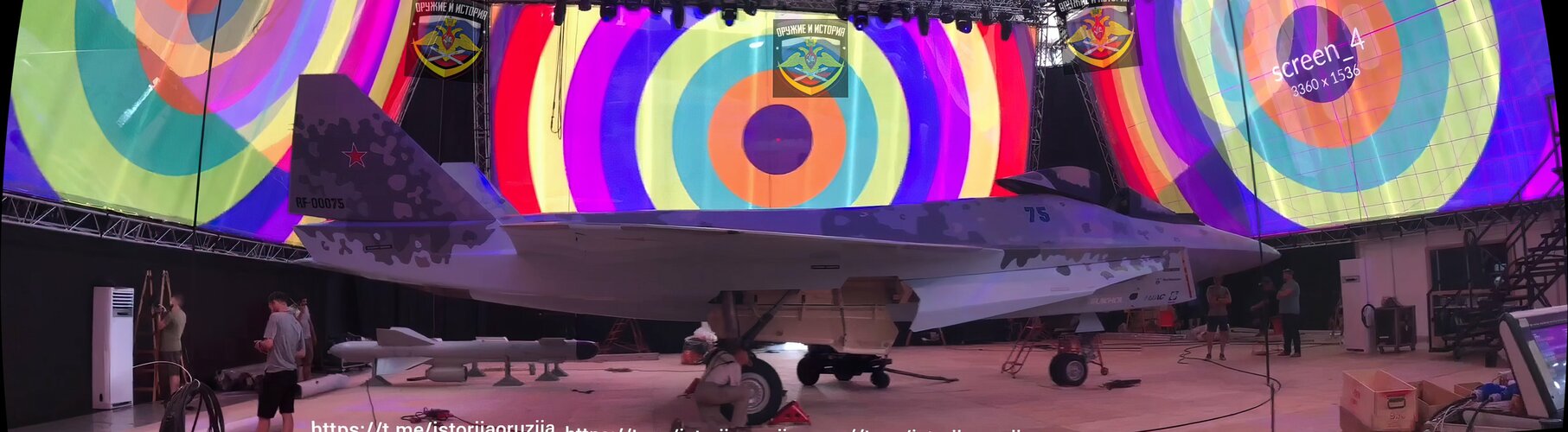

There also appears to be a fairing with an inlet on the inside of the starboard tail fin. What could that be for ?
Notice the inlet wall that would suggests there is a twin air duct behind?!!
Also noticeable is the short head clearance. I don't know how a 6ft is gona fit inside.
