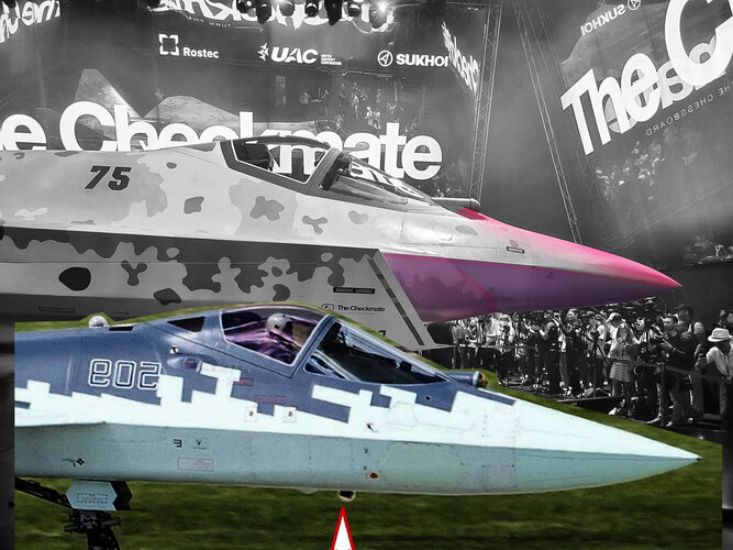

Paralay, the only thing I see missing on the drawing is the bump right before the intake, which would probably make the intake are a bit smaller. Man, I hope Zvezda comes up with a model soon as they did for the su-57... although I'm not looking forward to reproducing that camo paint job.

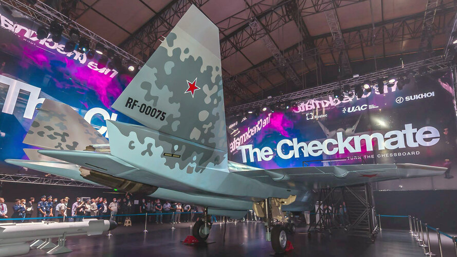

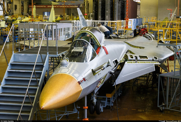

It's fairly clear to see that this is a first article - for engineering development and display. Nothing wrong with that!
Using as many Su-57 parts as possible is the right way forward. Leveraging that previous investment in design, tech and manufacturing is paramount in making this aircraft 'affordable'.
The more assemblies and tooling you use from already existing and paid for products and processes the lower your upfront setup and long lead item costs.
The problem with that is that you're using parts and sub-assemblies sized, optimised and stressed for a heavy, twin-engined fighter for what's meant to be a lightweight single engined tactical fighter.
When Teddy Petter created the Gnat, he did not start out by using the outer wing panels from a flaming Javelin.
You couldn't create a useful lightweight fighter from the nose, fins and wing of an F-15. And even if we could, it would be vastly inferior to a purpose designed aircraft.

Whilst I agree that using sub components isn't the absolutely, most perfect to the last millimeter and kilogramme design point, we are talking about a world famous, cutting edge aerospace design bureau.
I'm sure they have weighed up the various pros and cons between design, affordability, and performance.
Look at the design of the Su-57, especially in planform, and in particular the central lifting body, and the wings. The central lifting body component is far bigger in relation to area than the F-15.
I think, if Sukhoi carries this LTS off, it's actually an extremely smart design, very cleverly executed.
It's not "an extremely smart design, very cleverly executed."
It's a clever way of making a compellingly realistic-looking mock up.
Put national pride, patriotic chauvinism and Sukhoi fanboyism to one side for a moment.

It just occurred to me BTW that this design has a very similar control surface configuration to Checkmate, @VTOLicious - to maybe add to that earlier discussion. Relatively upright tails and trailing edge trimmers flanking the engines (though inboard in this case).
The tails? Again these are especially small in the Su-57 and they assume a greater share of pitch control in Checkmate, so that they are relatively-speaking larger is probably accounted for at least to some extent.
The Su-57 probably can have very small tails because they are fully moveable and because the LEVCONS allows them to maintain authority at high AoA by helping to keep the airflow attached. That last element does not apply in the LTS, so somewhat proportionally bigger tails is quite reasonable.

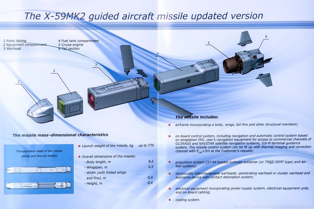

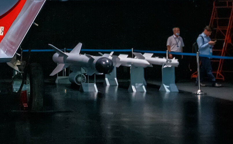

I wonder if the AShM would fit inside the bay or it should be carried externally (that would kinda harm its stealth capability tho). For some reason i feel the fan below the missile could not fit, but maybe im overthinking it ?
That AShM is not compatible with internal carriage, but for instance Kh-35 is.

Roland55:
No, you are quite right, they made a Kh-59 version specifically for internal carriage:
I'm so hyped on that Kh-69 missiles. It basically check all the boxes of being compact, long ranged and Universal. I believe Su-27 family can easily carry it. It's a much better weapon than earlier Kh-59. I wonder tho if it will still require Tekon or its Russian analogue datalink pod.

Pak FA is a MOD initiative, if the VKS buys Checkmate then it will mean the corpse of MiG is finally in the ground. Hard to say what impact that might have in the future.

Russian equivalents to the US F-22 and F-35. If Checkmates verticals were laid down flatter, would look like McAir/NGC JSF entry.
