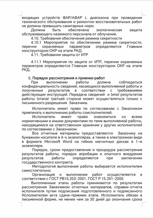

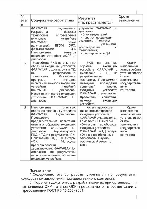

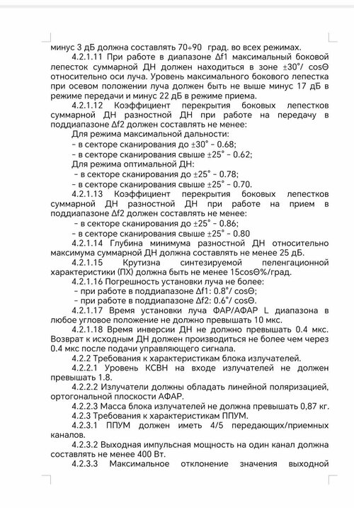

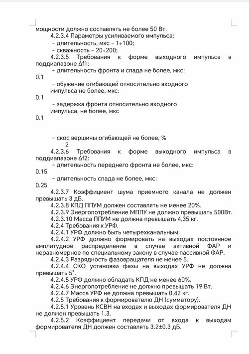

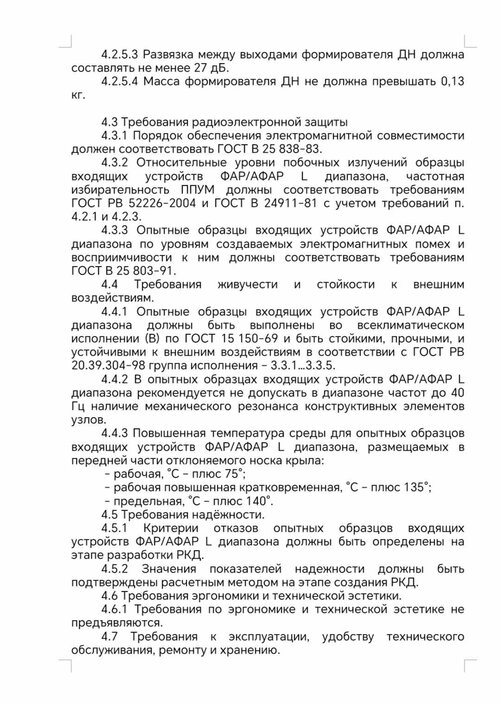

This is the simplest way ( copy/paste) to present this some kind of 'Technical Doc.' about the Project 'Scale'. As mentioned before ,this presentation is about decimetric L-band PESA/AESA N036L radars. I've lost my complete tranls of this doc. ,sorry....
I don’t quite understand. What is the name of that document? Is it the flight manual of Su-57?. Where do you got it from?

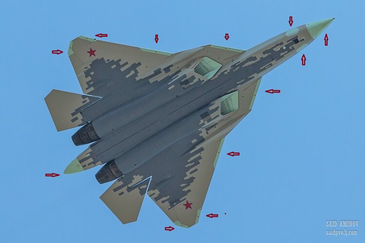

Or you can just call it metal layer/ metal mesh since it is literally just a thin layer metal
Well, maybe so that you can jam and perform IFF fucntion at once?. Or maybe simply so that you can cover both side since Su-57 wing has very big swept angle and ESA aren’t exactly known for high boresight capability
They are both electronic scanned array
OK, metal layer ,yes.

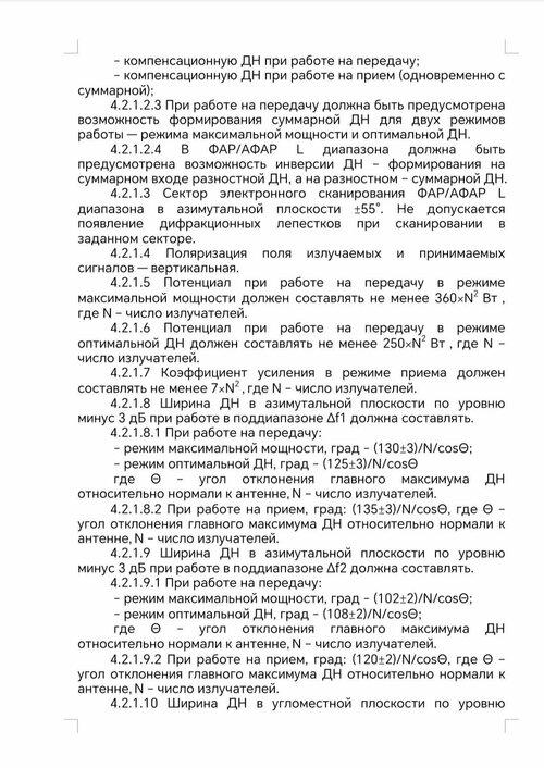

As we can see from the Doc. , FoV for L-Band PESA/AESA is 110° or+/-55°.
Yes but with differ radiating elements.

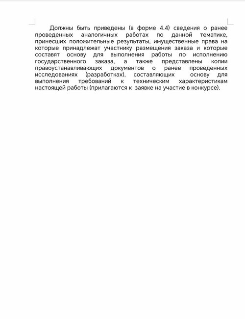

This is that document. No ,it is not FM for the Su-57. It is about Project 'The Scale' ,about developing those decimetric L-band N036L PESA/AESA radars for the Su-57. If I may ....

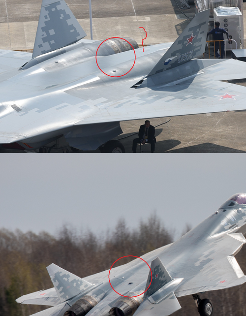

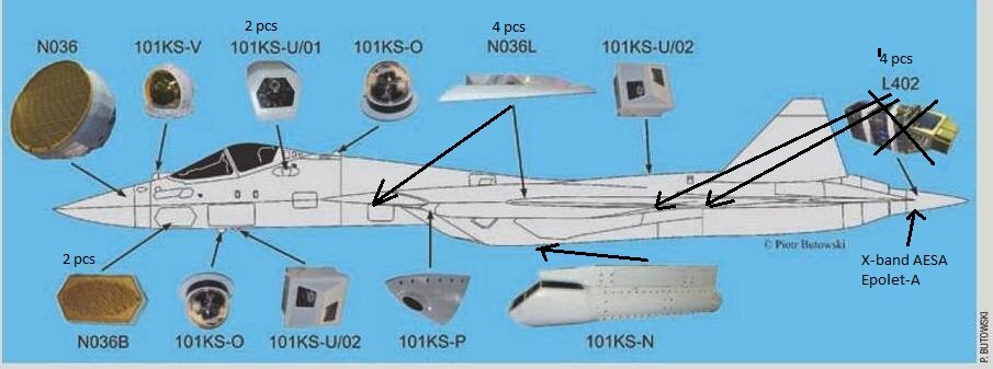

There are 4 of them(2 in LERX, two in wing), or two per side, for combined 220 deg AoR.

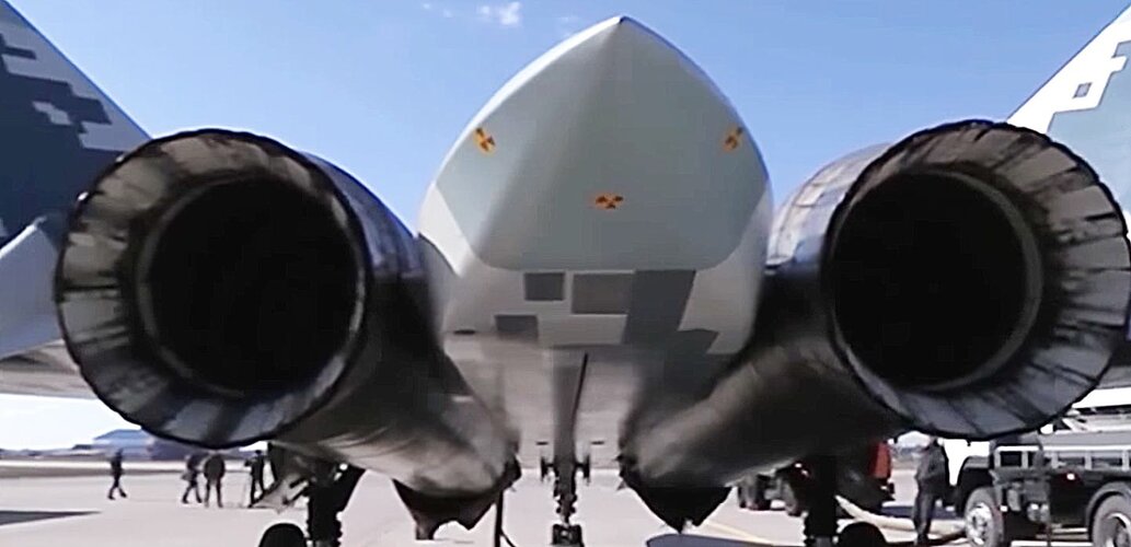

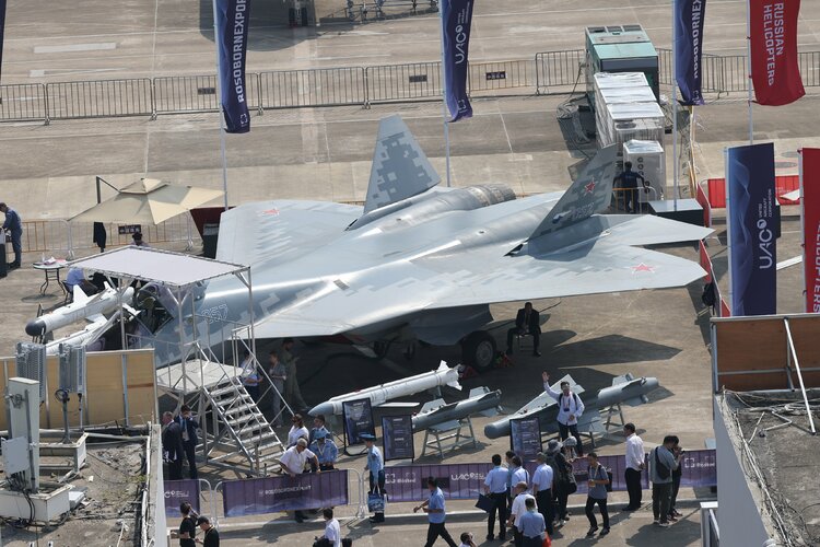

wow so interesting , how about the MAWS for Su-57E option I see only 3 sensor on T-50 KNS ( Su-57E markerting )
i compare from T-50KNS (up) and Su-57 serial (T-50S-2) (down)
Hi ! Su-57E for the export will be certainly much downgraded when we talk about avionics in comparison with the Su-57(S) for RuA&SF. When we look on the technological demonstrator of Su-57E Bort number 057 blue, we can see that there is even no N036B as SLAR-X band AESA. So Su-57E will have four instead of eight radars.
We will definitely be waiting for pictures of the Algerian Su-57Es when they are produced, so we can see how many radars and optoelectronic modules they will have.

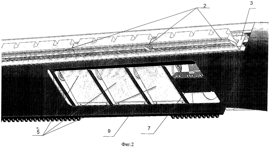

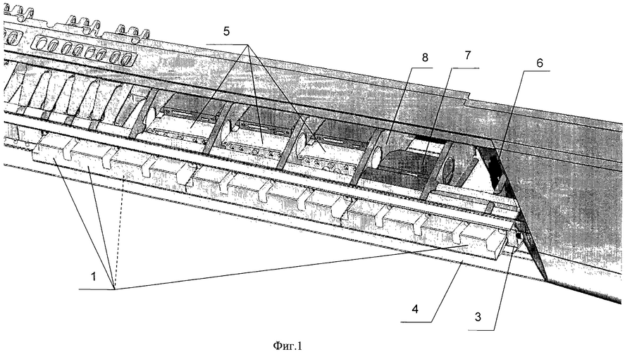

Patent of the linear L-band PESA/AESA for the Su-57.
САМОЛЕТНАЯ АНТЕННАЯ РЕШЕТКА​

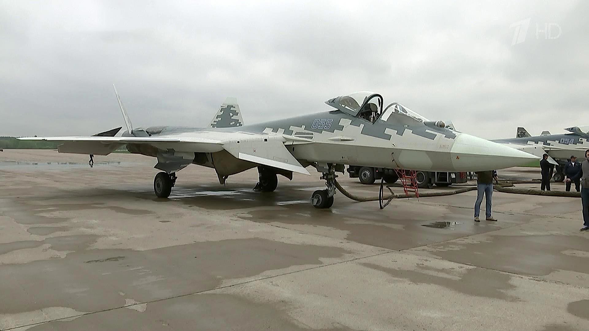

Cameras ??? Three ball-like cameras one to the each other, hm. I first saw those 'balls' in one reportage from Russia 1HD TV on May 2018 several days before Victory Parade. Famous reporter Nayla Asker-Zade interviewed Sukhoi test pilot Taras Artsebarsky. I have some sequences from that video but video itself, I could not find.

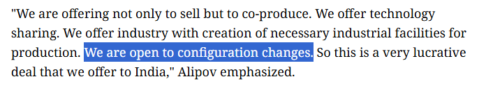

It looks like India is finally starting to move back into the Su-57 interest. It also looks like Russia might be caving more to demands to the configuration, though I agree with @stealthflanker that no changes will take place that would change the base Su-57.

Tnx for that. Obviously that's not the video I meant. First I found this one, but it's not that one either.
I'm now 100% sure that video is from May 2018 ( made before V.P.) and in that video ,Taras A. after the interview was in the cockpit with his thumb up.

That's right, Let's see the latest news. So the Indians were even offered license serial production of the Su-57E (maybe with limited transfer of technologies), which is fantastic because who else offered to produce the 5th generation fighter under license? Let's keep in mind that the Russians recently made it known that the Su-57 could very easily get a two-seat version, which was one of the requirements in the FGFA program.Personally, I think it's the best possible offer.

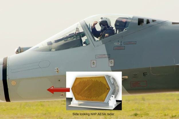

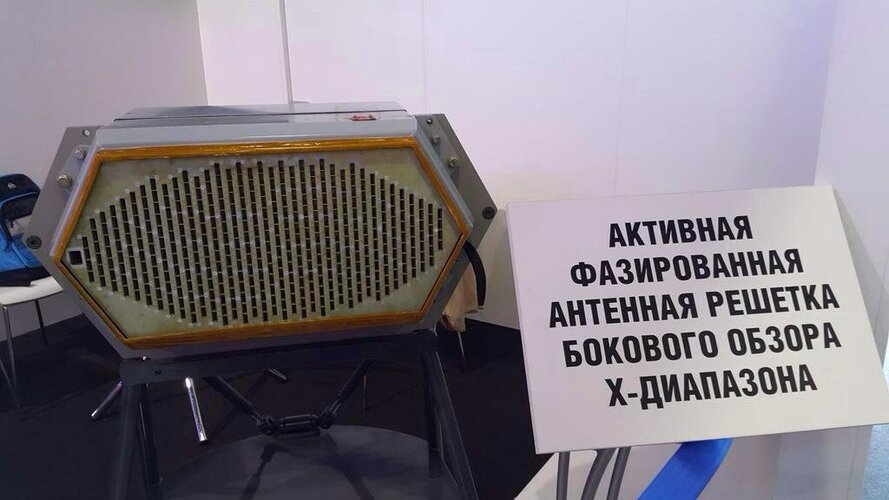

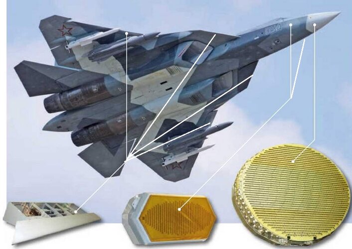

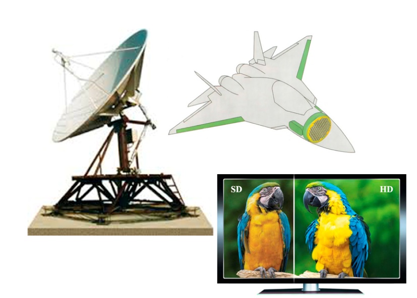

Transl: He was asked what they plan to show on MAKS 2015. He said that the main X-band AESA( test model) for the front hemisphere search was shown on MAKS 2009,then that N036B X-band AESA as SLAR was shown on MAKS 2013 and N036L L-band radars (PESA/AESA) was shown even earlier, on MAKS 2007.
This modified ( I added some white lines) photo has description : ''Слева направо: Крыльевая АФАР L-диапазона, АФАР бокового обзора Х-диапазона, АФАР переднего обзора Х-диапазона. '' From left to right: L-band AESA in wingslats and of course LEVCON's, X-band AESA as SLAR and X-band AESA for the front hemisphere.

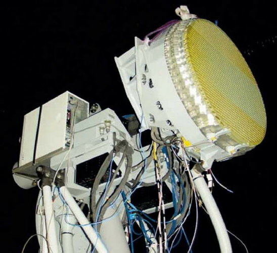

When we mentioned those L-band radars it is interesting to note this .Let us see this next photo.
Первый экспериментальный образец АФАР ПО на испытаниях в радио безэховой камере НИИП им. В.В. Тихомирова, ноябрь 2008 г.
So as we can see, the test model of the main X-band AESA was on static tests during 2008.As we know now ,L-band AESA was on static tests much earlier. But this is not the point of the story. In the meantime I tried to find that interview with Yuri Beliy in National Defence (detail about L-band radars wavelength) and I 've found some additional articles:

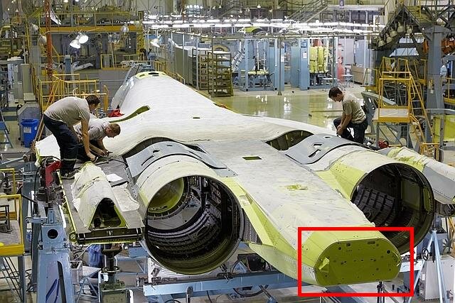

Point of the story is this .What was going on with that X-band AESA inside of the tailboom for the rear hemisphere search (rear-looking )? The story about that radar is even more interesting.This X-band AESA was shown ever earlier than any other,he was shown on MAKS 2005. Citations:
''At the MAKS-2005 air show in August, Russia's NIIP (the prime contractor for the PAK FA radar), demonstrated a working model of its Epolet-A active phased-array radar for the first time. The antenna uses domestically produced key components. According to its designers, the radiated power on each of its 68 elements reaches 10 Watts, compared to 5-8 Watts for foreign radars. The small-sized Epolet-A is considered to be an auxiliary antenna but it employs serial technologies developed by the key Russian electronics manufacturers: the St. Petersburg's Svetlana and Fryazino-based Istok companies. NIIP Deputy General Director Anatoly Sinani hopes flight test radar will be built in late 2006 or early 2007, as called for by a government program.''

Practically, this X-band rear-looking AESA 'Epolet-A' was the first one to be developed and tested for the N036 Byelka dual-band radar system as part of the Sh121 MIRES. Some photos:

When we talk about EW (ELINT/ECM) AESA-stations of the L402 Himalay system ,those stations/antennas are positioned in the wingtips.Btw, L402 uses all other AESA radars with their centimetric and decimetric interference signals.
''Бортовой комплекс обороны Л402 «Гималаи» разработки АО «Калужский научно-исследовательский радиотехнический институт» и производства ставропольского ПАО «Сигнал» имеет собственные антенны, но поскольку он работает на тех же волнах, что и РЛС, он использует антенны Н036.''
''The L402 Himalaya airborne defense system, developed by JSC Kaluga Research Radiotechnical Institute and manufactured by Stavropol-based PJSC Signal, has its own antennas, but since it operates on the same wavelengths as the radar, it uses N036 antennas.''
Illustration made by Piotr Butowski several years ago.There is some corrections and adds.
