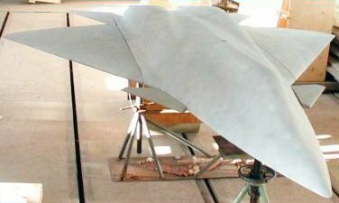

There is a post from 2020 by Flateric claiming that the design study is from the late 1990s. Not entirely impossible as the F-22 was planned to have cheek arrays and the X-44 MANTA project would've been contemporary (even if the 602 looks very modern).

Ah, interesting. I should have noted that the Sukhoi designs still have vertical stabilisers.
Was there a common influence? Is TsAGI still influential? I'm asking because of the highly swept wing combined with the small close-couple 'moustache' canards... it seems very similar in terms of aerodynamic approach.
P.S. If '602' looks like that - it'll be very interesting to see if E-721 ever gets declassified. I suppose '602' had between engine weapon bays like the PAK-FA/T-50?
"Spot 10 differences" in the attached pics... The last two are cleaned up by a friend of mine.

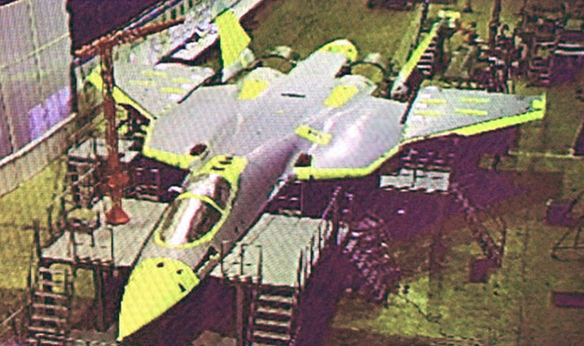

In June 2007, the plant received all the design documentation for the T-50-0, 1 and the first stage of construction of the KNS. Active work began on the construction of these aircraft, design and technological testing was carried out, and these activities provided additional material for refining the design documentation itself.
The production of 3 aircraft was launched: T-50-0, T-50-KNS, T-50-1. 2007 and 2008 were spent on preparation of production, technological development and correction of documentation, production of parts and assembly of units, their joining and development of some systems. This required increasing participation of specialists from the plant and the design bureau, many issues required solutions on site.
It's possible.

From OKB Sukhoi in 2018, some wing spars and nacelle area.

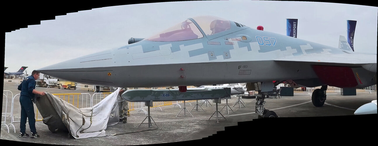

The Size of Things: Human vs. Su-57
:rolleyes:
I think it’s very kind of the Su-57 to pet his friend on the head. You never see this in the west... we need more kind 5th generation aircraft
also: the perspective on this picture is quite blown out, so it’s kind of difficult to discern proper scale here
I love it! Where's this weird (and weirdly numerous) crowd now who liked to claim so adamantly that Sukhoi went with the configuration we know as the Su-57 today not on merit but because they were variously unwilling to or downright incapable of departing from the legacy Flanker template?! Everything from canard-deltas with tip fins (ok, known for a few months already) to a freaking FSW got considered before arriving there - but sure, it's nothing more than a Silent Flanker...
