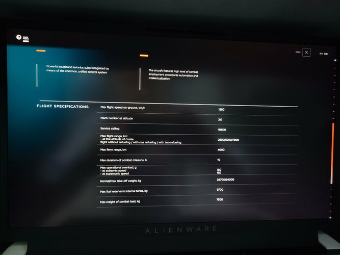

Arent those airframe G limits a bit small? Max 8g at low speed and 6g at supersonic speed.
I'm more interested in range. 2800km even for 9.7t fuel is way too little. For example, it's less than Su-30SM, that has much worse drag and same amount of fuel. Unless they forgot to mention that is with some load.

That's the one I had in mind for the MTOW and range.

The thing that current range spect doesn't make any sense at all, wither with 117 or 30 engines.
As I pointed above, Su-57 has less range than Su-30MKI despite having more fuel efficient engines, almost same amount of fuel. By that data Su-57 drag is somehow worse than that of Su-30, which is the second worst in Flanker family.

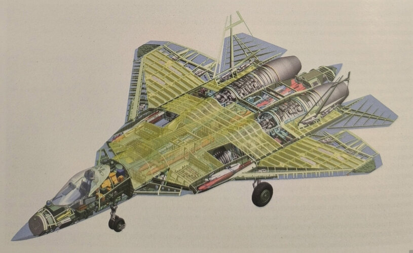

Could also be the result of Sukhoi attempting a difficult and risky structural design for the Su-57 by have big internal weapons bays in tandem, so two big structural "holes" in the centroplane, while also not being structurally too thick above the bays for aerodynamics. In fact in Bill Sweetman's 2013 article on AvWeek after MAKS airshow, he highlighted the structural risks and challenges especially for centroplane. In fact the patch of metal reinforcements that first showed up on T-50-4 is still there even on serial production aircraft. So slightly reduced MTOW and overload limits may be meant to reduce structural weight. The T-50 did have an entire structural redesign after the 5th prototype because of cracking early on. That's why there's "Stage 1" and "Stage 2" aircraft. And to be fair even the most maneuverable fighter only sustain 9 G at low altitude and having all that vaunted maneuverability is increasingly of questionable use in modern air combat.

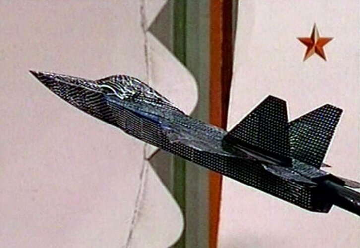

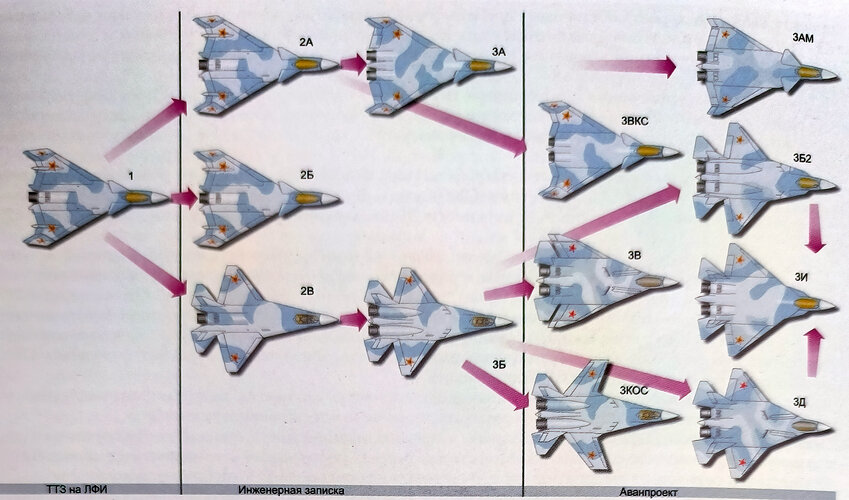

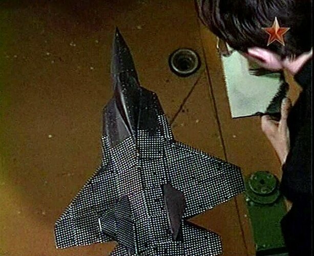

I still don’t understand why the rear visibility is so bad; their concepts had a cockpits similar to the f-22
I’m not

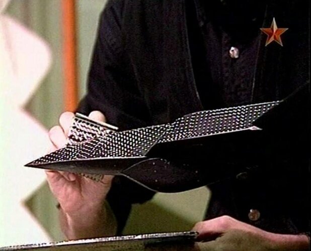

Remember Pogosyan's "model on windowsill"(3Б2 i believe)? It's rear view is even worse than on a real plane.
I’m not following QuadroFX why did they limit the visibility to the back? Is that due to radar signature?

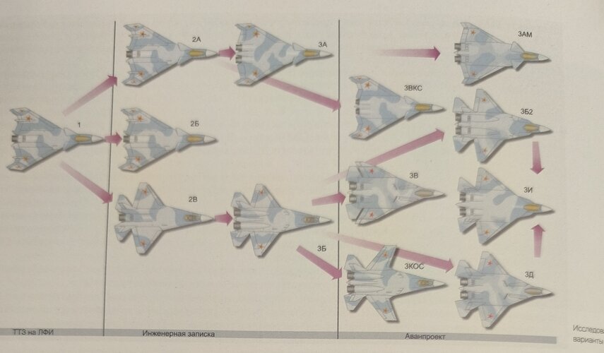

SibNIA PAK FA early desain ???
