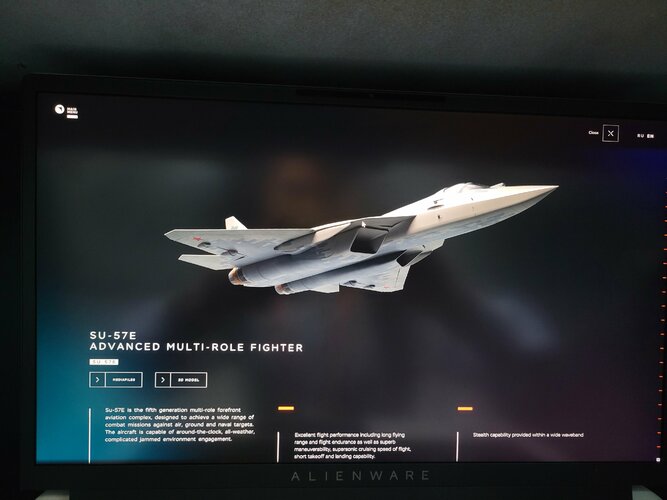

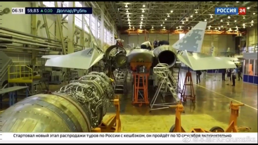

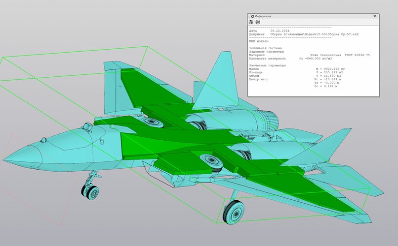

Same thing is with the empty weight of Su-57. UAC or Sukhoi present that it is 18-19 tons but it has nothing to do with reality. E.g. about engines AL-41F or Izd 117 ,many sources mention that dry weight is about 1.5 tons but in reality that engine is 150 kgs lighter then old AL-31F,so 1530kgs -150kgs is ....

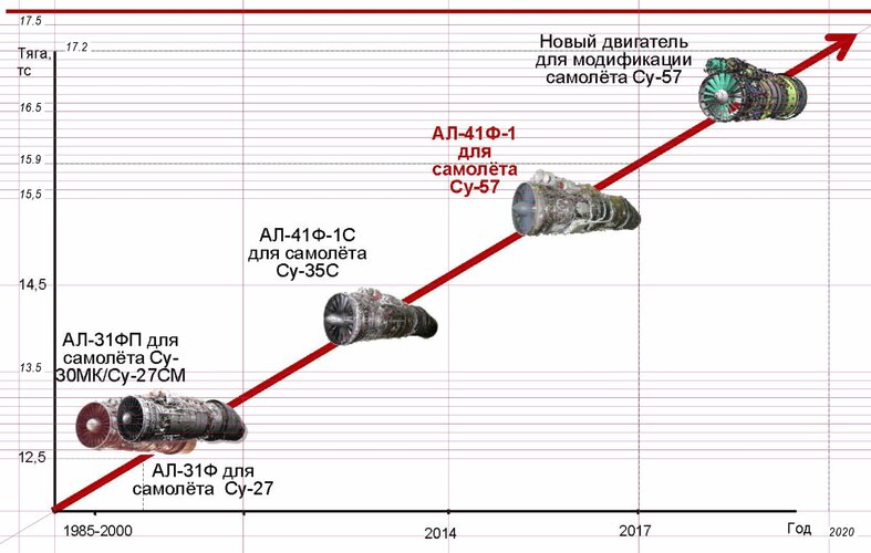

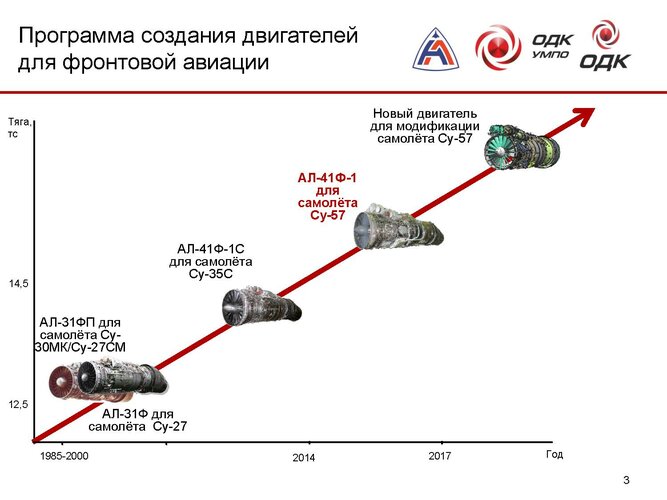

Thrust vectoring adds those 150kg to the weight of the AL-41F1.
Again,AL-41F1 is 150kgs lighter then the old AL-31F. So we have 1530kg -150kg=1380kg and that is the dry weight of the Izdeliye 117.
Citation and source :
''Изделие 117
По сравнению с серийным АЛ-31Ф новый двигатель также стал на 150 кг легче и имел повышенную на 15-20% тягу, доведенную до 14-15 тонн.''
Now we can calculate T/W ratio for both static/ground and dynamic/in-flight thrusts including of course the weight with fluids that one engine needs.Suppose that weight with fluids is 1400 kg then we have a max possible static thrust on the Full AB mode of 15000kgf / in so called 'special regime' /and that weight with standard parameters: H=0,V=0,t=15°C. On the Full AB mode / in so called combat regime/ we have 14500kgf of thrust and that weight. What about dynamic thrusts ? E.g. during take of phase and climb phase to 1000m of height ,dynamic thrust can be almost 20000kgf (calculating temp,density off local air etc ), so it is variable. Now we can understand what real T/W ratio of one fighter with given weight and in given flight phase can be because calculating static thrust is completely wrong.
Now may I ask how empty weight of the serial/operational F-22A was increased from about 14.5 tons to about 19.5 tons? It is 'increased' by 5 tons.How it was possible?
Maybe the empty weight figure was only for the equipped airframe without engines? This could explain the difference and maybe the public empty weight figure is operational empty weight?
Just thoughts.

At a time when izd.30 did not exist yet, an insider reported that the thrust of the T-50 engines was brought up to 16,000 kgf...
any increase of dry/non afterburning thrust figure ? The baseline AL-41F1S was about 8800 Kgf.

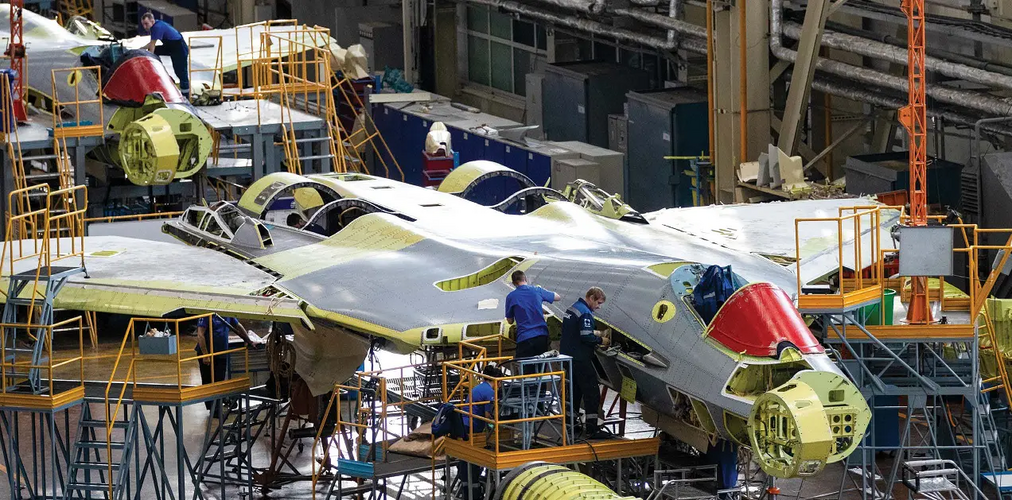

The estimated weight of the empty Su-57 is 16740 kg

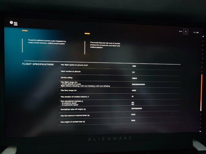

eger-tab
English in the AN column
Forgot to comment this material. Some interesting and some questionable data we have there. E.g. fuel weight: 11 tons. Also about fuel tanks 'cause as we know Su-57 got that new PTB-3400.
Fuel system. Volume 11.68 m3. Fuel weight 11.68 m3 * 775 kg/m3 = 9000 kg
Fuel weight(100%) is 9 tons or 11 tons ?
15000kgf or 16000kgf of the max static thrust on Full AB mode , never mind.
These parameters are related. I believe that the maximum thrust of izd.117 is in the range of 9500 kgf - 10000 kgf
This is more important. With up to 10000kgf of max static thrust on MP mode ,long-term supercruise capability is not on question.

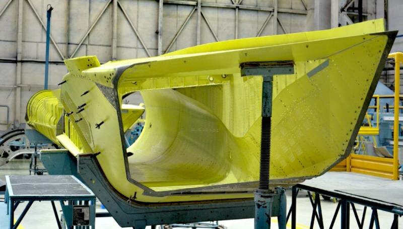

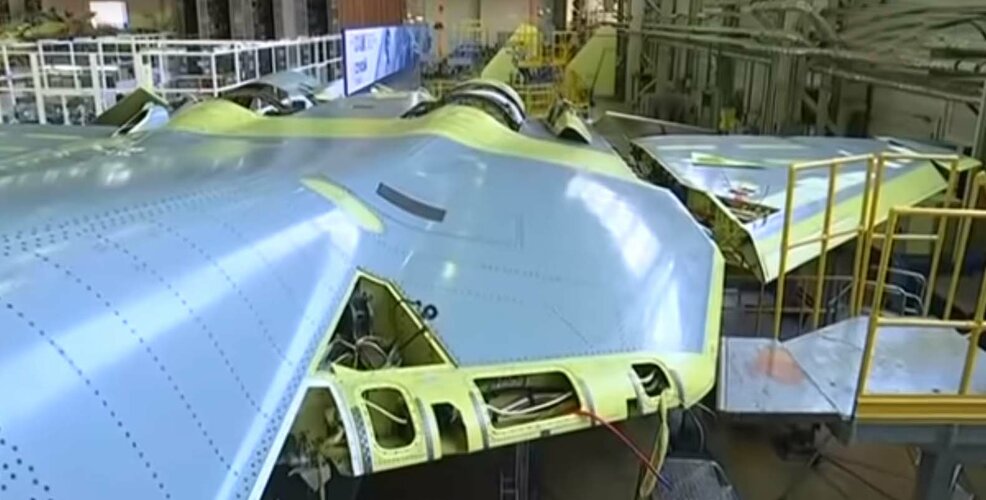

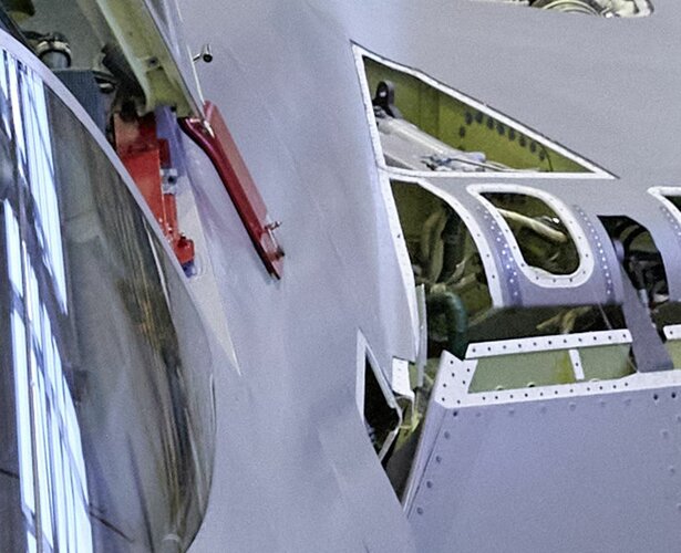

this the RAM layer, if true, maybe Su-57 have thickness is 10-15mm and interesting the radome parts have different thicknesses?

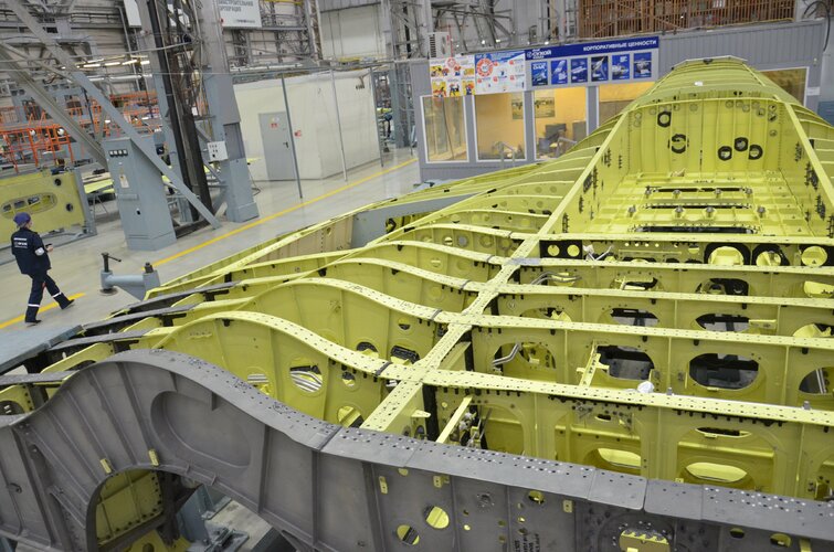

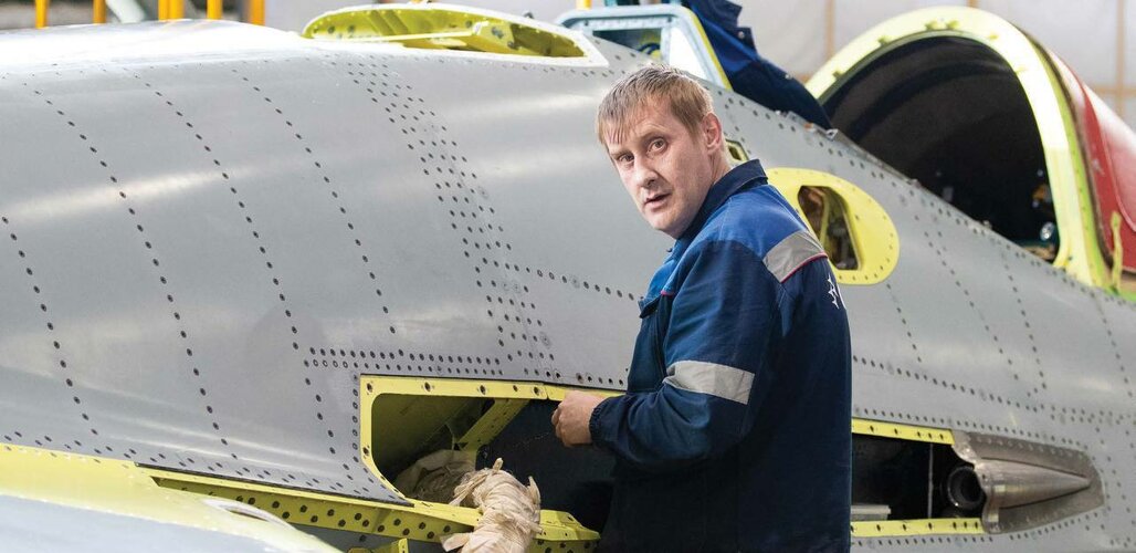

About integrating RAM layers on the skin of the each serial Su-57, KnAAZ factory has one special acclimatization chamber.
The whole process takes a little more than a month to complete work of application of RAM layers.
Translated citation:
''The process of applying a radio-absorbing coating/RAM on the Su-57 is complex; it uses newly developed and introduced into the production chain of RAM .Each layer of special coating has a special functional purpose and its own unique thickness, which depends on the area of application.
Using today's technologies, the entire cycle of step-by-step application of RPP takes just over a month. According to experts, technological capabilities and scientific developments make it possible to reduce the time required to complete this stage of work.''

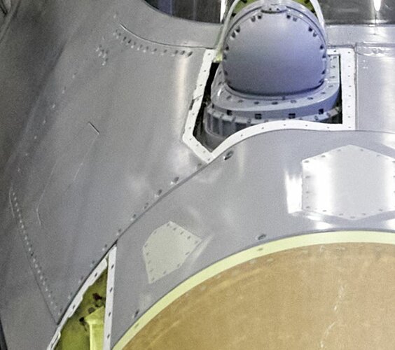

Like our friend “Squirrel” said, there are differences between layer thickness on different panels, and some panels don’t even require the RAM coating.
What I have noticed, is that the lower part of the airframe is covered with much thicker RAM layer, compared to the upper part of the fuselage, which makes sense when we consider that the lower part is the one that is most of the time taking the “hits” from the ground based radars.
It is also apparent that the Su-57 is using thinner RAM layers compared to the F-22, and even F-35, especially at the upper part of the fuselage.

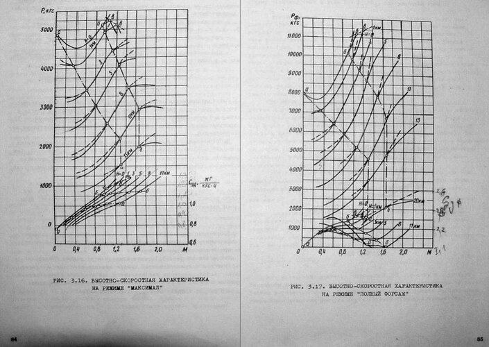

From the book : ''Самолёт СУ-27СК. Руководство по лётной эксплуатации. Книга 1'' or 'Su-27SK Flight Manual'.
1. Максимальная эксплуатационная перегрузка при расчетном полетном весе 21400 кг:
Пу макс = 8,0 при М≤0,85
Пу макс = 6,5 при 0,85<М≤1,25
Пу макс = 7,0 при М>1,25
2. Для весов, отличающихся от расчетного полетного веса, перегрузка устанавливается из расчета:
m•Пу макс = const = 171000 кг при М<0,85, но не более Пу = 9,0
m•Пу макс = const = 139000 кг при 0,85<М≤1,25, но не более Пу = 7,0​
m•Пу макс = const = 150000 кг при М>1,25, но не более Пу = 7,5
3.Масса топлива: кг 9400 / 5240 , Полный / основной (неполный) вариант заправки
Transl. :
1.Max operational G-load with calculated TOW of 21.4 t
Max G-load=real speed
2.For weights different from the calculated TOW, the G-load is set from the calculation:
Max G-load=aerodynamic pressure ,real speed,G-load limitation
3.Fuel mass : full and basic variant of refueling

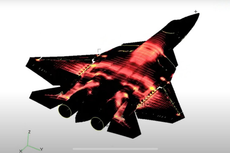

Yes, LM stated that frontal RCS in the centimetric radar bands of F-22A is 0.0001 cm2 ( only 1cm2,OMG) but all of that has nothing to do with reallity. By the way ,one of the tactical-technical demand in ATF program was to have fighter with 100 times smaller frontal RCS in comparison with then actual fighter-interceptor F-15C.
Initial ATF spec, yeah, kinda, but you seem to have missed the part where the RCS requirement changed and was drastically increased.
So ~10 m2 : 100 is .... You can decrease some RCS by 10 or 100 times max ,not by 1000,million or billion because it is impossible to achieve, that is reallity.
You can believe that, but it doesn't make it true.
Hi !
I recommend you to look and hear what one of leader Russian experts for the RCS testings Sergey Nesterov told to Aleksey Egorov author of the famous TV show 'Military acceptance' from 19:25 about possible RCS reduce procedures. He told to Aleksey that all capable stealth technologies and applied procedures can reduce the RCS in the centimetric, decimetric and metric radar working bands by several tens to a hundred times ( as max value).
By the way it was reportage made in 2018 about 2nd Central Scientific Research Institute of the Air and Space Army based in the vicinity of the city of Tver.
P.S. If you want something to be translated I will glad do that.
By the way ,when topic about Su-57's RCS comes up, I will give some data and info from the leading Russian experts in that domain,Andrey Lagarkov,Mikhail Pogosyan,Sergey Yagolynikov...
I wonder when exactly Pogosyan and Yagolnikov became leading Russian experts in low observables.
And, due to the radar range equations, that would make "stealth" impossible to achieve. A 100 fold reduction in RCS only halves detection range.
So either US scientists and engineers lied on a grand scale and conned the US Government out of trillions of dollars, or Sergey Nesterov is incorrect. I note his viewpoint on Stealth handily corresponds with what Russia has achieved.

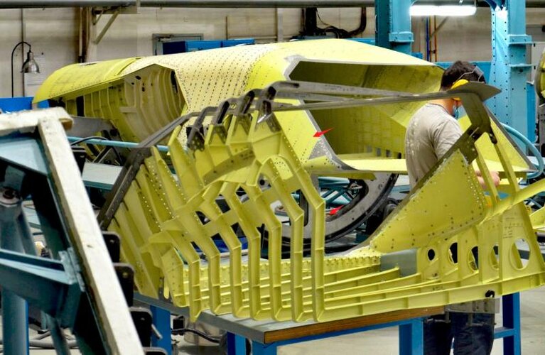

To continue the story about construction materials if I can. So we have that Al-Li Alloy V-1461(not 1441 as mentioned before, sorry ,RadicalDisconnect was right) with about 50% of the empty weight of the serial Su-57. As we know this metallic structure material is applied in complete structure of air intakes and centroplane,in that big upper cross section of the centroplane,leading edges of the wings and LEVCON's ,complete carrying inner and skin structure of the vertical stabilizers then in the inner and partially in the skin structure of the horizontal stabilizers.Also it is applied on the places where the wing hardpoints are and as structural carrying inner parts of the wings. Al-Li Alloy V-1641 is welded with Argon. As mentioned before, Al-Li Alloy V-1641 is easily to identify by its yellow color.
Besides this Al-Li Alloy ,another very important and second in percentage of empty weight is Titanium Alloy VT22. About 20% is the part of this Alloy in the empty weight.
''высокопрочные конструкционные титановые сплавы
BТ22 – высокопрочный свариваемый титановый сплав с высокойпрокаливаемостью широко применен в изделиях авиационной техники: Ил-76, Ил-86, Ил-96-300, Ан-72, Ан-74, Ан-124, Ан-224, Ан-148,Як-42, Бе-200, Ту-204, МиГ-29, Т-50 и др. Сплав предназначен и применяется для изготовления крупногабаритных деталей внутреннегосилового набора (балок, лонжеронов, шпангоутов, нер-вюр, рельсовзакрылков и предкрылков), а также крупногабаритных силовых деталей и узлов шасси, в том числе сварных (траверс, балок тележекосновных шасси, шлиц-шарниров, тормозных рычагов). Из сплаваВТ22 изготовляют следующие виды полуфабрикатов: поковки, штамповки, прутки, плиты, прессованные профили.''
Source: https://viam.ru/sites/default/files/uploads/booklets/pdf/alumin_2012.pdf
This Alloy is used as the main structural material for the engine nacelles .Also in combination with mentioned Al-Li Alloy is used as inner structural material of centroplane and wings especially of connectors for the wings and centroplane.Titanium Alloy VT22 is welded by the beam of electrons in the vacuum chamber. Ti Alloy VT22 has grey color.
Al-Li Alloy V-1416 in inner structure of air intake,
Same Alloy in the structure of the air intake's skin.
Al-Li Alloy and Titanium Alloy VT22 in the inner structure of centroplane.
Both metallic materials in the inner carrying structure of the wing.
Ti-Alloy VT22 as the main structural material of the engine nacelles.
About polymer composit materials they are produced by the 'Himcomposit', 'Aerocomposit' and ОNNP Technologiya factories. Аbout 20% is the part in the empty weight of serial Su-57.It is interesting that composite skin panels have high resistance to lightning and have own fiber optic monitoring.Besides this,there is special ground laser monitoring system for the composite skin panels. Autoclave technology is used for producing composite skin panels.Composite skin panels have grey/bluish-grey color depends on light intensity.
Polymer composite skin panels.
Bluish-grey color under the light.
Another combination of that yellow and bluish-grey colors.

Left engine ready for installation inside of the engine nacelle.

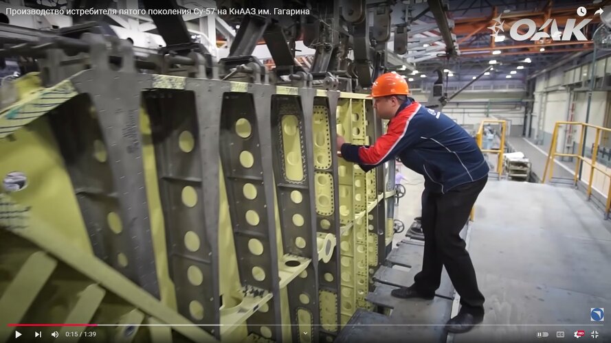

We already know that in serial production workers in KnAAZ factory use '3D-technologies' and AR-technologies;
Workers on assembly line of Su-57 use augmented reality​
View: https://www.youtube.com/watch?v=zWWSUrGB_-4

Actually, the main difference according to the Evgeniy Marchukov (beside the ones you have mentioned) is in materials used for the compressor blades, since the AL-41F-1S could not withstand significant increase in operating temperatures.
There is no official information on the AL-41F-1 engine thrust numbers as far as I know. We have official numbers for the AL-41F-1S, but not for the Al-41F-1. We have various hints for the 15 tones of thrust, and If we exclude the info from the insiders that claim that the engine is producing 16 tones of thrust, there was official statement for the engines T-75 can use, and there was two engine options, one with the 14,5 tones of thrust, and the second one with the 16 tones of thrust.
I assume that the 14,5 t option is AL-41F-1S, and 16 t option is AL-41F-1, since the AL-51F-1 was not finished, and my guess is that it will produce more than 16 t of thrust.
That being said, I might be wrong?!

Probably 15900 kgf for AL-41F-1 and 17200 kgf for izd.30
For me personally,it is not so important those max static /dynamic thrust values as that very inovative plasma ignition system which is used in both the main and AB chamber of AL-41F-1 ( F-1S also).
