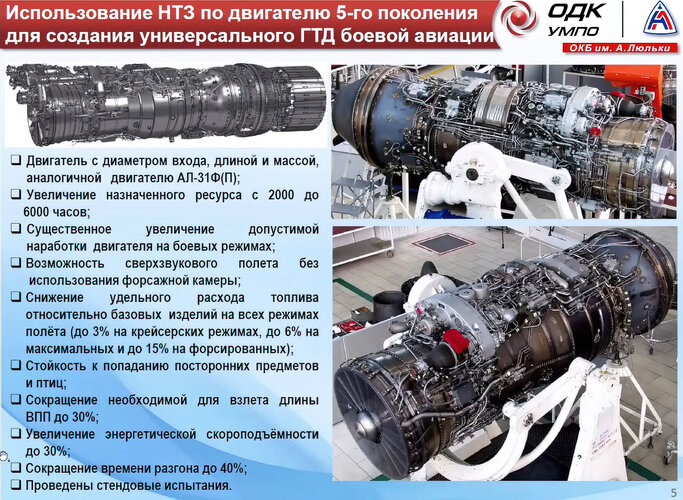

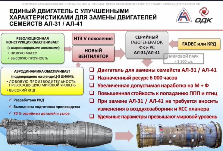

It’s real. They are displaying in Zhuhai. Despite the fact that it is close to service the Chinese are more conservative and will not be displaying WS-15.
If you will read posts above with link to other thread you will discover that this is not Izd.30.
The information from Rostec is quite unclear. Literally it states: "... an absolutely new engine of the fifth generation for the most modern aircraft of the operational-tactical aviation". So it could be AL-51 as well as "Udlinitel" (see above).
So AL-31F(P) whatever exact versions as the life time has changed, according to sources that I have seen over the past 30 years;
AL-31F Prototype : 100 h
AL-31F1 : 300 h
AL-31F3: 900 h
AL-31FP : 1000 h
AL-31FM1: 1500 h
AL-41F1(S): 4000 h
Ofcourse newer production models of the AL-31F(P) likely incorporate improvements that may explain the increase ti 2000 h. In any case it's not the AL-41F1(S) that's taken as a benchmark here. Could somebody translate the text on the board/brochure into English?
So why there is j-20 on the banner? Are they suggesting the j-20 uses it or; they want the Chinese to buy it? What engine is this?
From what I understand 177S is the engine we spoke about earlier - a 117(S) gas gen + new fan part based on izd.30 tech. with 14.5-16t thrust rating. Wonder what's name will it get. My guess is AL-41-F1SM or F1S1.
Why J-20? Dunno, maybe as fallback or for export.
The first ~50 or so of them are al-31fn users, and it gives them a very attractive update path to semi-A standard when their current engine stock dies.
Those, as well as all the other pre-WS-10 jets are a big market.
