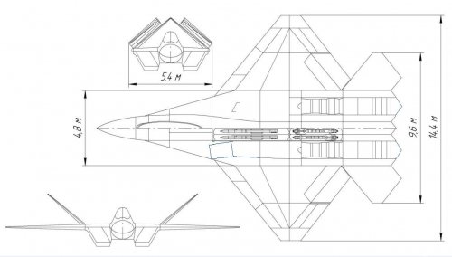

Is the drawing yours? If so, what makes you so confident that the engines will be placed close together?

http://www.secretprojects.co.uk/forum/index.php?action=dlattach;topic=1055.0;attach=25600
This is what an ugly one :D ;D drawing by paraly makes me down

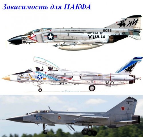

Solve a task and receive PAKFA! ;)
PAKFA = (F-14 / F-4) * MiG-31
PAKFA = (F-14 / F-111A) * Su-33KUB
Very Challenging! However, all I am getting is a 2 engine aircraft with a very high probability of a variable geometry wing and two side inlets. And did I mention a two seat cockpit and a carrier tailhook ;)
Anyway, if the PAKFA ends up looking anywhere near the YF-23 it will take the second place from F-22 as my second favourite aircraft. ::)
Your inclusion of wildcards in terms that may be linked or independent is driving me nuts! I love it :)
Ok, lets take a stab. The picture makes the first one a 'looks like'. So, an F-14 with the wings of the phantom looks like a Mig-31. Thus, the PAKFA looks like the plane it is supposed to beat, with a wing planform from something else, I'm picking the Hornet. SO, just like your drawing, it's a twin engined, flat fuselage aircraft with LEREX and a more or less straight wing.
The second one is harder (Shakes fist at wildcard!). Well, I could approach it a few ways. I'll think out two.
Both the F-14 and the F-111 are swing wings, the Su-33KUB isn't, but it does have a lot of high lift devices on the wing. SO PAKFA has something interesting in it's wing construction to do with high lift.
OR
The F-14 used parts from other projects, and the F-111 WAS a part from another project, and Su-33 is a carrier aircraft from existing project without complete redesign. Thus PAKFA will use already existing avionics, perhaps all those juicy ones that were on sale until a few years ago, along with internal design from an already existing aircraft.
Too many variables, but a lot of fun speculating!

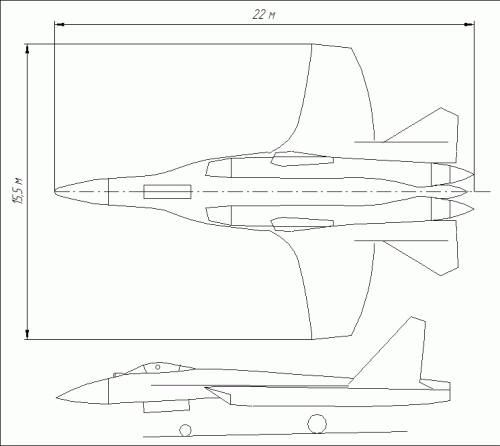

lantinian

The article on a theme of forecasting{prediction} in an aeronautical engineering, in Russian:
http://paralay.com/stat/prognoz.doc
This looks like a great Article. And its one of those times when I hate how little Russian I can read. I got the overal impresion that at the end of the day, neither the PAC-FA, not the JSF-ski will go into production leaving the more conservatice Mig-1.27 a path for development.
Just some comments that topic, too.
I personally believe very strongly that the F-22 will always keep an edge against ANY designs ANYONE can AFFORD to produce. Why?
Answer: Software. Everything depends on it. Especially when it comes to integrated computer systems. If the ASEA radar can be made into a weapon just by some weighless program...
I agree that there are some designs out there that are Superior to F-22 in terms of performance resulting from the shape of the aircraft. YF-23 for one hand, and I do hope the Pak-Fa borrows ideas from it than the Raptor.
As for your JSF-ski pictures. There is no doubt, they look good ... like the ATF artist concepts from the early 80s. Remember the Grumman submition - even the vertical tails were forward swept. However, they do not look stealthy enough, and neither do the MiG-1.27 or MFI designs.
Bottom Line:
All aspect LO, Energy Weapons and Information Warfare will what any post 2010 design need to have in order to reach production. The SU-35BM is still too good an airplane compared to what's in service in other countries to justify building a new one.
«Unknown.jpg» – Vertical tail - ERROR! :-[

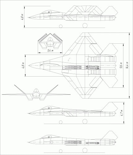

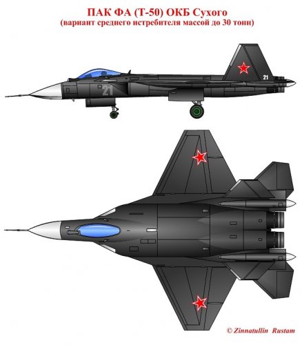

The newest drawing of PAKFA is acceptable
Here is my suggestion for the picture.

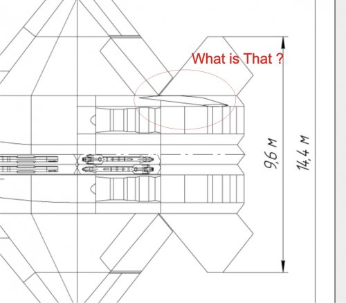

1) The front view shows a CARET inlet but in upview, that inlet still is normal rectangle inlet
2) Since V tail is used, why vertical fin remained? oops Lantinain has already point out it :p
3) The gradient angle of V tail must same as the outboard of inlet for LO.
Of course, even without correct, your drawing still is great and the PAK_FA you drawn is very nice-looking! :D

The Double Folding wings is interesting. Even the vertical tails fold.
However I am not sure what this configuration could be carrier based. The NAVI YF-23 was a canard design.
Besides, only India has one operational carrier. Admiral Kuznetsov has too many problems. And designing a aircraft so optimised for a carrier use might not be that practical.
I think the US navy should consider it, if they dropped the F-35C ;)
Also, I do not think there will be missiles poited backwards. There is too much jamming from the aircraft's own engines.

The witness declares, that PAKFA is similar to this picture
Other witness speaks, that the tail part is not similar.
I think, that engines are placed widely, as at Su-27.
