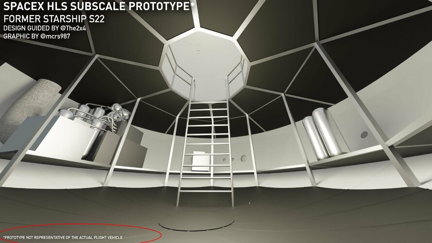

This picture appeared on X.com
claiming it SpaceX design for HLS interior

Inside the HLS prototype there are 5 bedrooms (ISS style, but horizontal), and a picture showing that you can fit 20 in one ring around the ship.
Being inside makes it SO clear that it's stupid big, and there will be no lack of space with any size crew.
They only have 2 floors so far:
One with very laid out life support, all clear to see (& in use).
The main one with the bedrooms, a storage area, 4 control seats, and a 40ft ceiling.
The HLS at Starbase didn't have a garage or airlock. (That may have changed, but I don't think so)
You can see the door in/out in pictures of it, up a flight of ~15 stairs on the outside.
Inside that door is the main room that's huge, and has bunks on one side and storage shelves with foam filled space bags on the other. The control seats, arranged like dragon (but just gaming chairs attached to boxes) are straight across from the door. 4 seats, with touch screens displaying Moon transfer, orbit, and landing maneuvers on them. (Similar to dragon docking simulator screens)
The center of the room has a ~8ft wide hole and a HUGE (4ft wide) ladder going down to the lower floor.
The floor is curved on the bottom as part of the dome for the pressure vessel. Big enough that you barely notice the curve in the area you can walk, but can see it curve up the sides under the life support equipment.
The life support looks like it is running fully, with the heat exchanger having a tubes that go out to the AC unit outside.
Sad to see that Lunar physics is not taken into consideration here, especially in what concerns gravity.
For example the vertical ladder will be a pain in the a** to use countless of time per day. On the moon, a muscular astronaut of 120kg will weight only 20. A tactical petite, only 10! To feel what it would be to step down and climb back that ladder,, try to put only 20 or 10kg at the gym on the bench and do a couple of minute of leg exercise... It's uncomfortable and even painful at the end.
We can see Lunar astronauts like Neil Amstrong repeatedly jumping from and on the LEM ladder to avoid the discomfort or gradually climbing it using the narrow spaced steps one at a time.
I would have though that, 50 years later, we could expect from their designers something that reflects a bit of back thinking on 50 years of blatant evidences.
Similarly, while in space, the absence of gravity would require a bracing surface for safety. The one side ladder doesn't look like the optimal solution here neither.
I do not congratulate those that came with this mess. And, frankly, that is not reassuring for the rest of the design. Hollywood Sci-Fi is cool but as a design inspiration, one should remember that it´s generally not made to be functional.
I don't know what you are talking about. There is only a ladder in the interior of the cabin between the two levels. There is an elevator for going down to the surface.
Wrong, there was no "discomfort". The step from the last ladder rung to the footpad was at a variable height due to the compression of the lander gear struts. Since the descent engine was switched off late (after landing and not at landing probe contact), the struts were compressed less and the rung was higher up. That is the reason for the jump. Also, the astronauts did not repeatedly jump on the ladder. They jumped off to get to the surface and jumped on to leave. They only did these once per EVA. Armstrong made an additional once jump once to test the ability to get back on the ladder before stepping on to the surface.
Hopping on the surface was found to be more efficient than walking given the limitations of the suit. This would not apply on the interior in shirt sleeve conditions.
no "bracing" is needed. A fireman's pole would suffice for weightlessness. the interior ladder serves the same purpose.

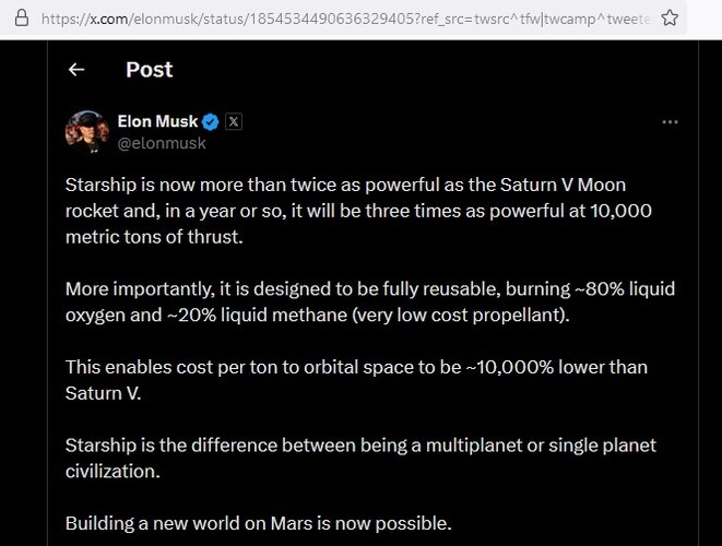

"Starship is now more than twice as powerful as the Saturn V Moon rocket and, in a year or so, it will be three times as powerful at 10,000 metric tons of thrust."

In the mean time I read Musk's complete tweet on X.
He says that: "This enables cost per ton to orbital space to be ~10,000% lower than Saturn V"
Somebody should explain to him that something can never be more than 100 % lower than something else.
Hopefully there are no such numerical errors in the design calculations of Starship.
