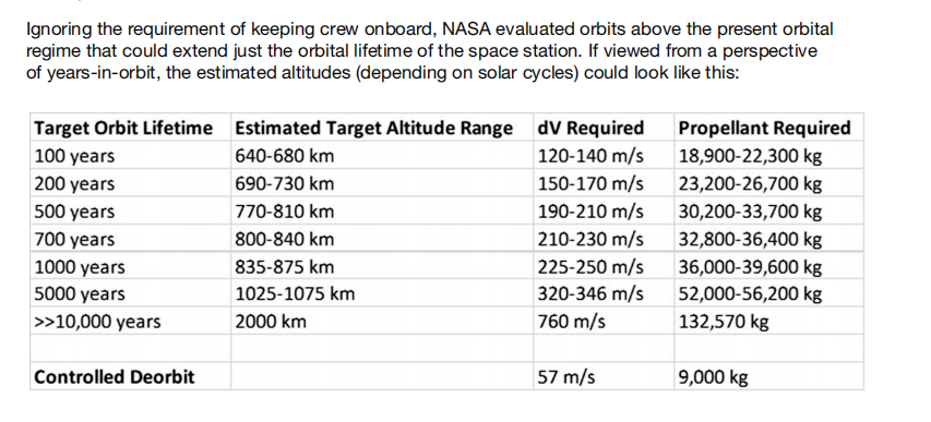

NASA analyzed boosting the ISS to a higher orbit, an option that considered SpaceX's Starship as a factor, but:
1. ISS operations require a full-time crew
2. Starship boost could destroy the ISS' aging truss structures
3. Chance of orbital debris strikes "increases drastically"

It is going to need around 30klb of biprop. It needs to be more than an upperstage: a spacecraft with a large amount of propellant.Does a suitable upper stage exist? If Dragon 2 can carry 7,000lb payload what if they just expanded the tanks on a Dragon 2 capsule? Would 7,000lbs be enough? Would it even be able to dock in a suitable location?
This is more than twice Delta II second stage load and more than 5klb of the shuttle OMS load.

Program office. Was looking into facilities for fueling it last year.Where does the 30,000 lb figure come from?
That isn't the official amount eitherSo not 30k lb but 20k lb (9000kg)

a. it is not riskyThen there is the timing. Why would you spend such amount of money now with a risky technical project when you can expect future Space operations to be able to tackle that problem much more easily, and at a bargain. Raise a budget and save it for the next generations to be able to do it (see it as a time capsule). In 100 year, we will have mass transfer in and out of orbit on a massive scale regarding today and the ISS would be seen as not much but an average daily load to move
not rationalhence, IMOHO, what would be more rational should be:
1. Demo a process (deorbit a piece of ISS valuable for preservation)
2. Do that as a multi-national competition/challenge to nurture an economy around it
3. Raise the rest on a holding orbit step by step (1000 year is too costly in term of fuel? Well, raise it for 20/50 year and wait to see what kind of actors and tech emerge meanwhile).
4. Contain it in space for long "on-orbit storage"
A. the amount of EVA's required and time. Also, systems were redistributed and reconfigured where it is not easy just to cut off a segment.A. Is there a reason they can't decouple segments and bring them down a couple at a time? I can think of a lot of reasons to want to avoid it, but what prevents it if that becomes easier than designing a new vehicle?
b.Same question regarding the 9k lbs of fuel for deorbit. What prevents them from breaking up the 57 dV into several burns? If necessary over several missions/capsules. If you can boost with a Cygnus/whatever capsule, it should be possible to (very slowly) deorbit doing the same thing.
c. How much/long can they milk out atmospheric drag if they are losing 2km a month? That figure is going to rise as it drops.
d. If you can break the mass into more manageable chunks, this should be much easier. And it's already been done. Pirs was deorbited along with a Progress mission. Maximize tankage on a modified vehicle that already exists (Progress, Dragon, Cygnus, whatever) and take the modules down a couple at a time.
