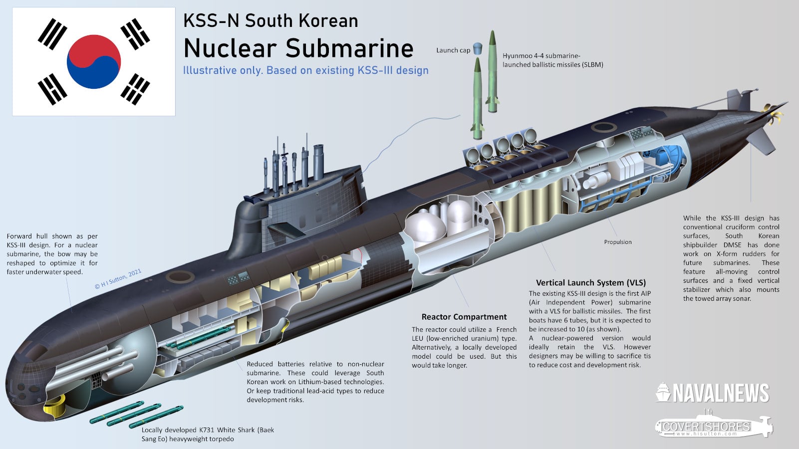

KSS-III understandably somewhat smaller (certainly not definite numbers, correct if wrong but 3358 vs 4500 t, 83.5 vs 97 m long, 8.8 vs 9.6 m beam, both diesel electric but lead acid batteries vs lithium ion, both at least 20 kn submerged, 18 000 vs 10 000 NM range, 80 vs 50 day missions, 60 vs 50 complement). I can't imagine South Korea having many conflicts of interests here with Australia/AUKUS and presumably now as the KSS-III program is fairly mature program some of the design and production talent might be available with some very up to date knowledge.
Hasn't anyone posted H I Sutton's chat on the KSS-III yet (hi there, covert_shores)? Sorry if this is a repost.
View: https://www.youtube.com/watch?v=QzgbWFoFX94
Or SSN?
Nice work on the image too from our very own HI Sutton

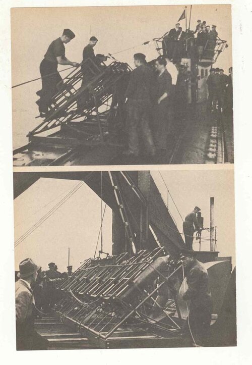

Would this also be the smallest sub to launch an SLBM?
No,that honor would probably go to the soviet B-62/Project 611A -
Nope. Germans got there first and smaller, launching ballistic missiles from the deck of a Type IXC U-Boat way back in 1942. These weren't *much* as ballistic missiles go... but that's what they were. The Soviet Zulu class boats were 2387 tons submerged, the German Type IXC were 1232. Wouldn't surprise me if someone launched similar craptacular rockets from even smaller subs.

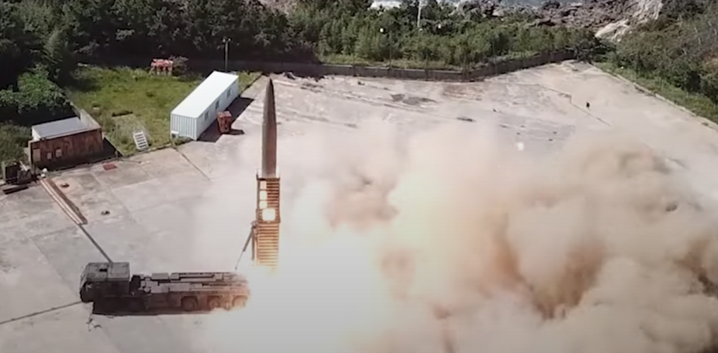

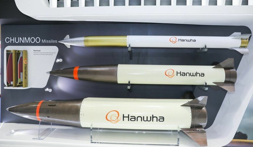

So firstly, KTSSM. KTSSM is a ATACMS replacement (although ATACMS will continue to serve for years to come even after KTSSMs are fielded in numbers) in development and fielding within ROKA Fires Brigade. There are two versions of it: KTSSM-I and KTSSM-II. KTSSM-I is a SRBM operated from fixed launchers fielded on Fires Brigade batter sites. They are equipped with penetration-thermobaric warheads and are intended to neutralize North Korean forward artillery bases which are heavily fortified and are often connected via tunnels under mountainous terrains. KTSSM-II is a mobile version of KTSSM-I intended to be used from K-239 MRL in form of a cannister. It is still under development and is projected to be fielded in around 2 years' time. KTSSM-II again has 2 versions, one armed with the same penetration-thermobaric warhead as the KTSSM-I and another armed with unitary HE. They are named Block-I and II respectively.

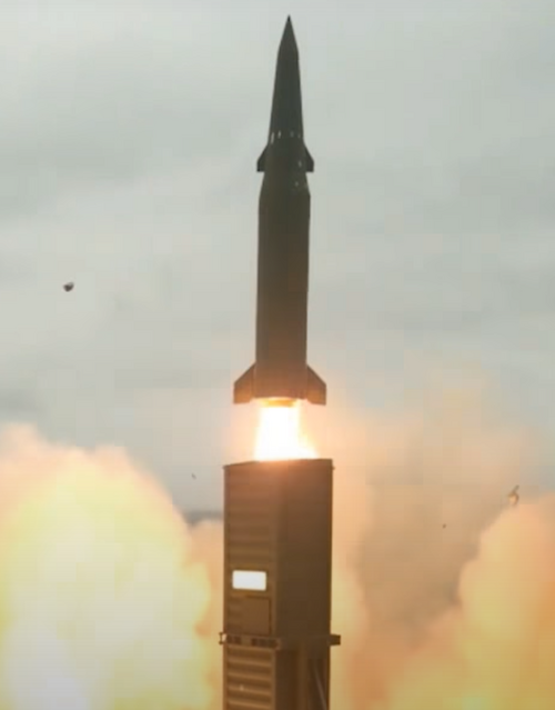

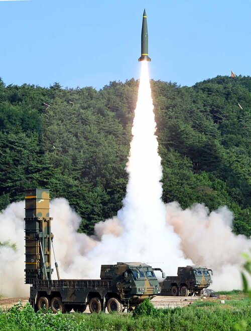

1) are the Iskander-esque missiles that are well known. Development of IIA started after the first revision of Korea-US Missile Range Guidelines. It allowed a development of solid motor rockets with a payload of up to 500kg with a range of 300km. Fielding of these missiles are known to have been started in late 2000s, although its existence was only officially confirmed and revealed in early 2010s. Similarly, IIB was developed following the second revision to the guideline in 2012. A new guideline extended the range restrictions to 800km. Range and payload were able to be offset which meant a solid rocket with heavier payload was also permitted should the range reduce accordingly. As a result, IIB has a range of 500km and a warhead heavier than 500kg, some speculating it to be around a ton.
There are allegations circling Hyunmoo IIA and B, that Korea didn't abide the range guidelines and that Hyunmoo IIA had a performance exceeding the restrictions. This seems to be reinforced by the similarities between IIA and B as well as the newer information disclosed concerning IIC (explained below). According to this speculation, the difference between IIA and B are essentially only their warheads, the former being cluster munition and the latter unitary penetration, as revealed.
There are speculations of Hyunmoo IIA and Bs being developed with the assistance from the Russians due to its similar looks to the Iskander, though no concrete connections or evidence exists. They are both launched from a 4X4 TEL and primarily replaced Hyunmoo I.
(impact footage of IIA[from 0:8 to 0:17] and IIB[0:20 to 0:25] respectively, showing their cluster munition warhead and unitary penetration warhead)
The importance of Hyunmoo IIA and B are that they were the first modern ballistic missile systems fielded by the ROKA alongside ATACMS that were capable of precision targeting. They were and are primarily used against TSTs, most notably the North Korean TELs and underground facilities.

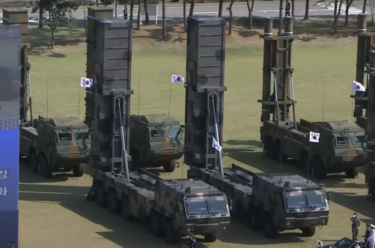

Due to longer range and heavier payload, 2) are much larger in size and are transported on newer 5X5 TEL that looks similar to HEMMT. It is rumored that the L-SAM launch vehicle as well as the MFR mount are also to use the same vehicle.
(you could clearly see the size difference of the TEL as well as the missile canisters compared to the previous IIA/B TEL [nicknamed "feelers" in Korean forums since the side-view mirrors look like feelers of an insect] and canisters.)
A newer version of Hyunmoo II equipped with 2-ton penetrator warhead revealed last year is yet to be officially named, albeit there is a separate naming system within the DoD/AMSC for their missiles (meaning, "Hyunmoo-#X" is only a public name), which means this new missile obviously would have its own name, just not disclosed. This new missile seems to have a similar booster section to the IIC. It will still need a different guidance system to the IIC since unlike the IIC this newer missile is unitary.

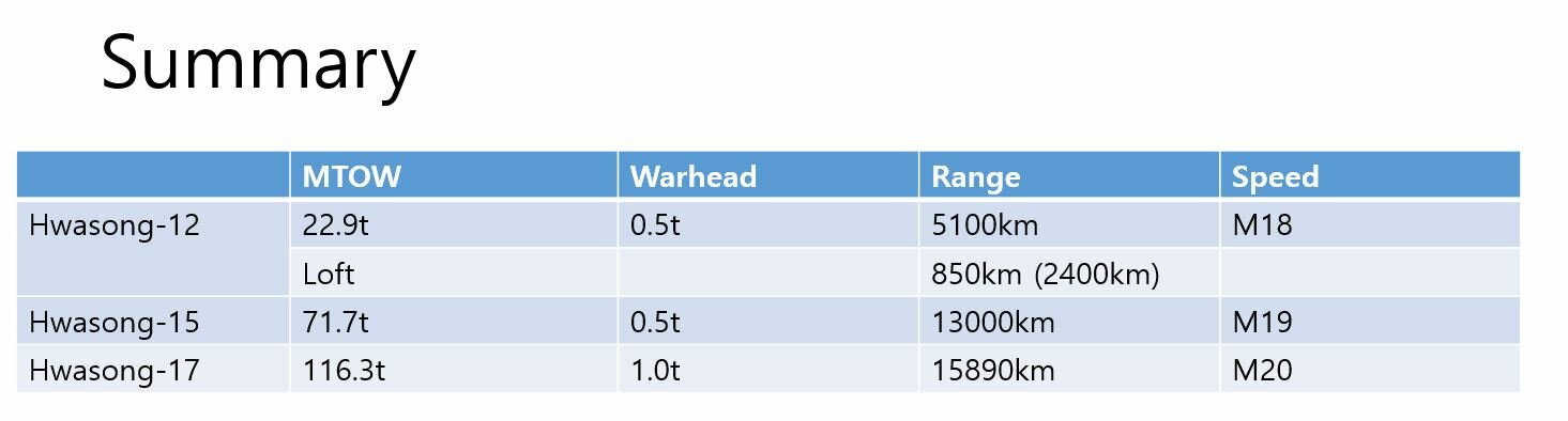

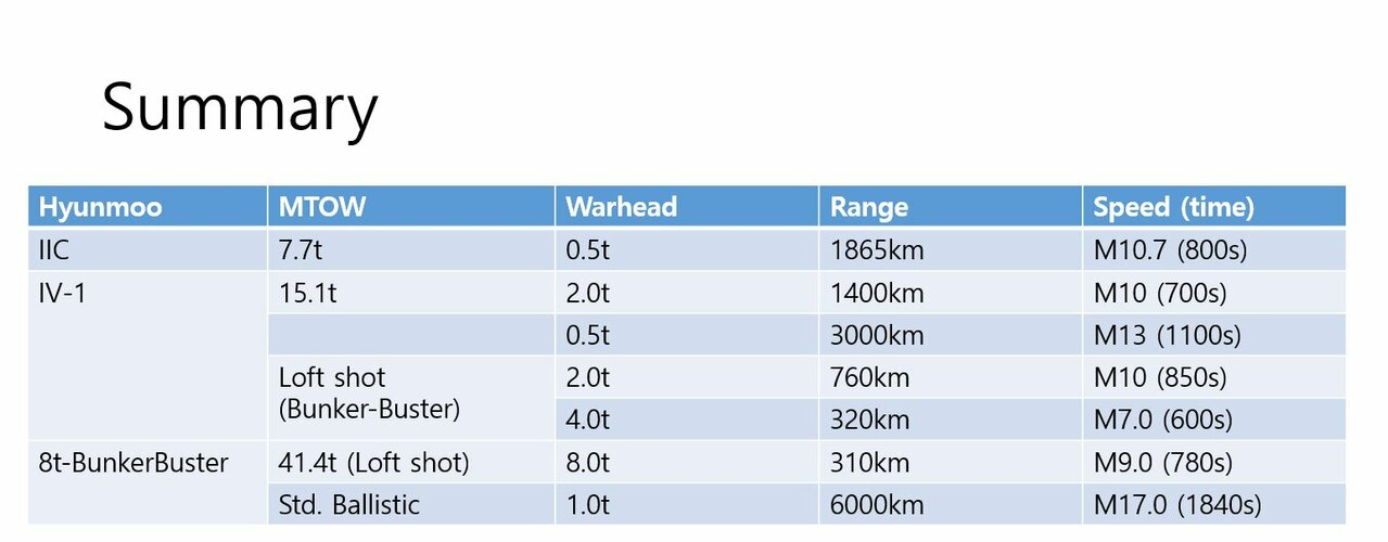

Hello @overscan (PaulMM), sorry to bother you yet again, but shouldn't this thread be elsewhere than The Bar or Discussion and Speculation section? I mean the thread sure is full of speculations since there are very few confirmed information, but the topic itself isn't "off-topic, alternate history and what-if" isn't it? ;)

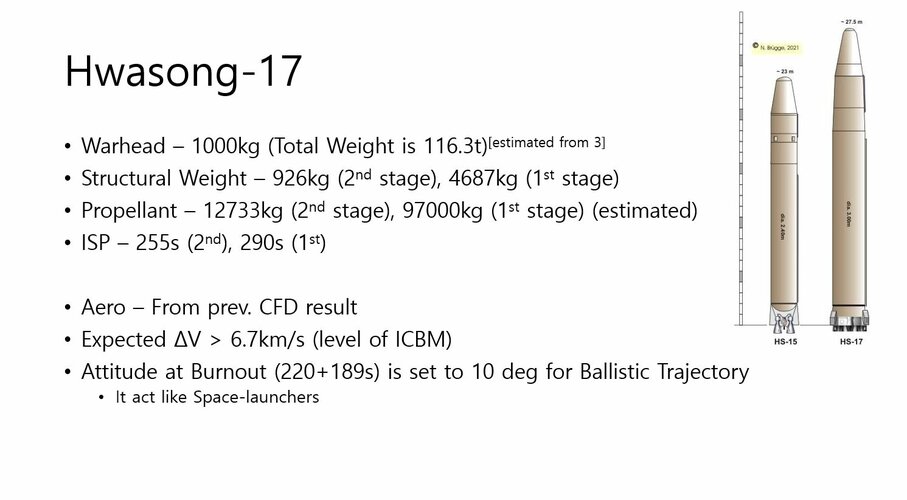

Are any of these real?
Existence of those missiles are, numbers aren't. Could ask our fellow member @litzj on how he got those numbers in the first place.
based on number from the press, I speculate the sizing with previous or similar class missiles.
this is why exact number is not correct for total launch mass something like that. I satisfy it right in rough
