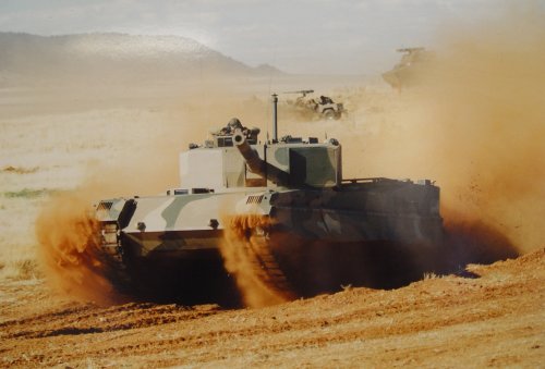

I went through my computer for pics to attempt to show the rear and the engine deck.
Fair enough. It just appears that the vehicle in your pictures looks wider and longer than the pictures I posted. Either yours or mine are distorted or the vehicle underwent a hull change/turret change at some point.
Yes, I see what you mean.
I suppose the best pics in regards to that would be those with humans, as below.
Interestingly, from available info, the hull width and length of the TTD is within a 5 to 15cm range of both the Abrams and Leopard Mk2, which is pretty negligable, so perhaps some of the pics out there do give a somewhat distorted picture.
EDIT: Or as Abe Gubler points out above, it is probably simply a matter of perspective.

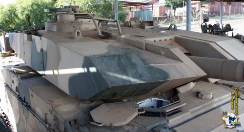

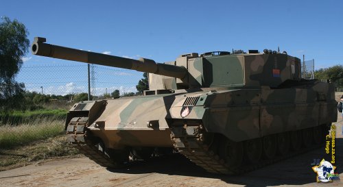

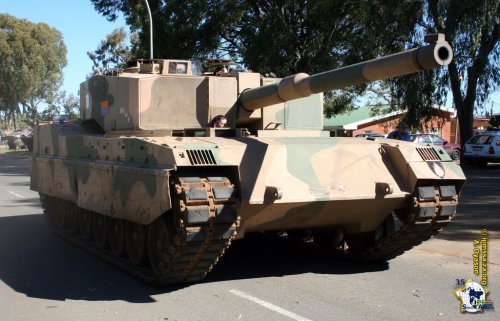

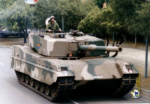

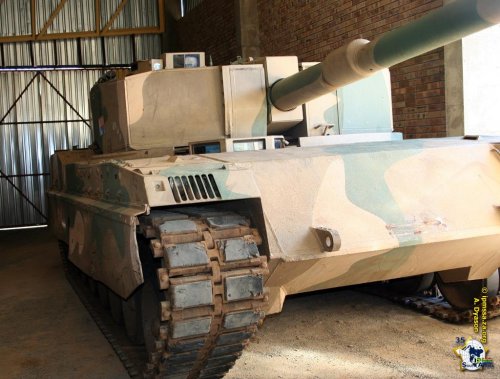

The TTD's name actually implies quite a bit.....Tank Technology Demonstrator.
One would assume that the operational or service version would show some changes.
One which interests me is the armour package.
I get the impression that the flat turret faces, in particular the front, would have seen additional armour components?
If one looks at certain pictures, particularly of the turret front and the gun mantlet/surround, it looks like space (and attachment points?) was left for these modules.
I wonder whether the thick sloped armour modules, as seen on the Olifant Optimal, would have been the sort of thing envisaged?
Or whether the drivers hatch would have only allowed a flatter array, assuming of course that a production vehicle would have remained unchanged...
kaiserbill said:
Quite the family of engines.... sort of almost the go-to company for tank diesels.
Panzer II, Panzer III, Panzer IV, Panther, Tiger, King Tiger, Leopard 1, Leopard 2, TAM, K1, Challenger 2E, Arjun, Merkava Mk 4… And that’s just the tanks. Plenty more self-propelled guns, tank destroyers, APCs, IFVs and even amphibian assault vehicles (the EFV) with Maybach/MTU engines. They are owned now by Rolls-Royce so I guess the British have solved their long lasting tank engine shortfall.
The mantlet area looks a bit ‘open’ from the front probably to enable ease of access to changing the trunnion cradle so the TTD could easily have the main gun changed. Part of the technology demonstrator role.
I seem to recall there is an attached brochure earlier on in this thread which shows some turret shells being welded up for the TTD. There are large hollow pockets for the armour arrays to be inserted. No problems to make these pockets wedge shaped to allow for high obliquity in the array.
Shouldn’t be too much of a problem. The driver’s position is designed to be accessible even with the turret traversed to the rear. The overhang of a frontal wedge is not as bad as the turret bustle when the turret is trained aft.

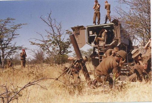

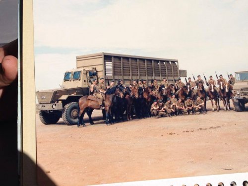

Does anybody have an idea what vehicle this is in the backround?
I can't identify it.
The old style helmet is in use, which means it is probably from before the early/mid 1980's.
GTX said:
Looks to be a variant of the Casspir.
I'm not so sure, GTX.
The Casspirs front cab upper sides are vertical, whilst these are sloped.
The Casspir also has a single unitary cab and rear compartment, whereas this appears to have two seperate compartments.
The Casspir also is a monocoque design, whereas this appears to have this cab mounted above the axle on a seperate chassis.
Rear compartment looks very cramped, and as said, the old style helmet sort of shows it's an older concept.
Not seen it before.

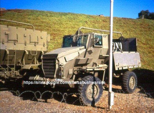

I was wondering if it is based on a Kwevoel mine proof vehicle... perhaps a Kwevoel 20 or 50?

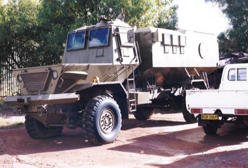

I'd guess for a version optimised for arty fire control of a Samil, my best guess would be similar to pic.
Nice one CG.
That looks to be it. The rear door latches and side roof slope match up perfectly.
As you say, it looks like they re-purposed or were testing that vehicle type.

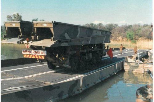

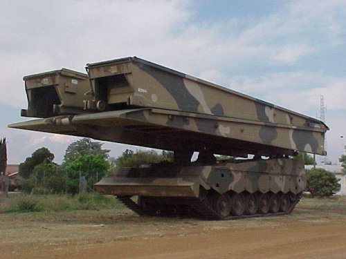

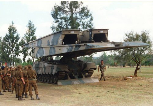

Also stumbled across these rare beasts on my PC, which haven't been posted before.
The Olifant Mk1B Bridgelayer and accompanying 8x8 bridgelaying vehicle (Leguan?) being put through their paces.

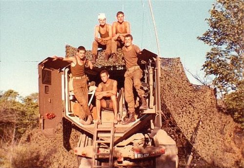

Another angle,also from fb.

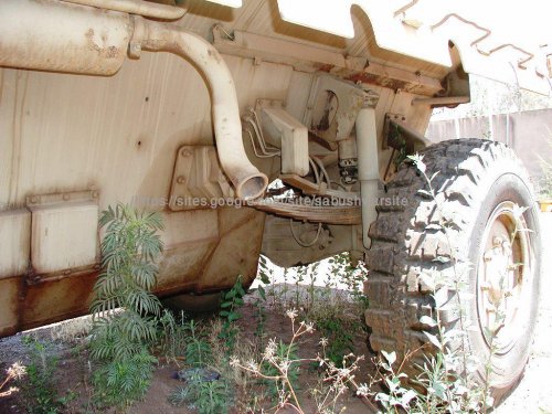

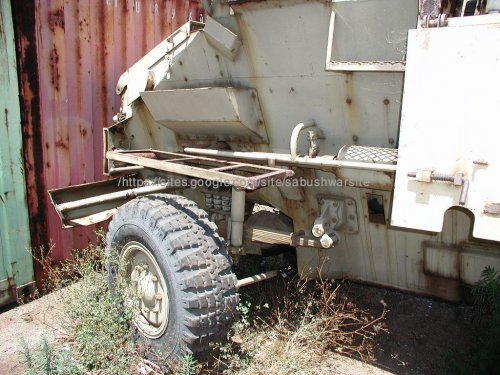

Something curious on page 69 of "Surviving the Ride". Project Sireb was intended to result in a suitable replacement for the Buffel. It resulted in two vehicles, both based on SAMIL-20 components: the Kieweit and the Wildebees. Both were evaluated against the Buffel and the conclusion was that they were no better than the latter. Two more vehicles were then constructed by the same contractors: Armscor for the Kiewit II and the Chemical Defence Unit of the CSIR for Wildebees II. And here is the curiosity; I quote: "The vehicles were essentially the same in comparison to Kiewiet I and Wildebees I, although SAMIL-30 axles, imported from Egypt, were used in both vehicles"
[/size]
[/size]SAMIL-30?? Egypt?! After having a look at the photo's, it is clear that the axles, both front and rear, are different to SAMIL-20 units, and the tyres are larger. The rear axle hubs look like the hubs on the rear wheels of the bigger Magirus and SAMIL trucks. Looking through older editions of Janes' Armour and Artillery, I happened across the Egyptian Walid APC. This was developed in Egypt during the mid-sixties, and consisted of a Magirus Deutz chassis fitted with an open-topped armoured body, resulting in a vehicle similar to the BTR-40. The chassis of the Walid was produced by the NASR Automotive Plant and the armoured body by a plant at Kader where the vehicle was also assembled. Janes'reported that the vehicle was probably still in production during the early eighties. The axles of the Walid look identical to those of the Kiewiet II and Wildebees II.
[/size]
[/size]My guess is that standard axles instead of the portee units used on SAMIL-20 were required for the Kiewiet/Wildebees. The Egyptian, licence built, Magirus units fitted the bill and the axles were imported from there.
[/size]Apparently arms sanctions make strange bedfellows!

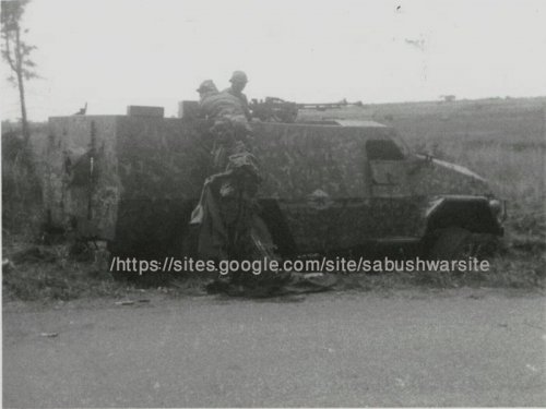

The SADF also came across some Walids in Angola during Ops Savannah in 1975/76. It is not clear if this vehicle belonged to the FNLA, MPLA or UNITA. It is suspected that none were returned to SA after Ops Savannah at this has never been mentioned in declassified literature.

You are absolutely correct Abraham: the Walid/Magirus axles are simple comercial off the shelf (COTS) items and would not have been subject to an arms embargo. The track of the SAMIL 20 is somewhat narrower than the that of the the bigger SAMILs and when the builders of the Kiewiet and the Wildebees needed standard axles for their vehicles, the Walid items apparently fitted the bill. Being produced in Egypt probably made them much cheaper than equivalent German made items as well.

Thanks Bushwar. Never saw that photo before and did not realize that Walid's had made it this far South!

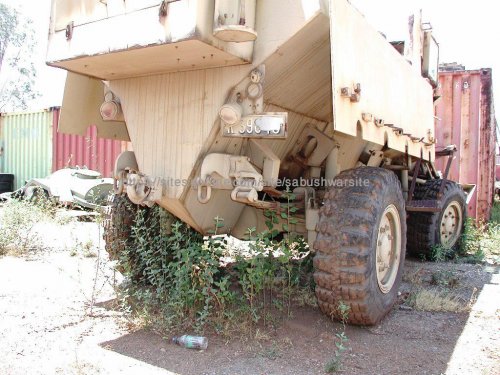

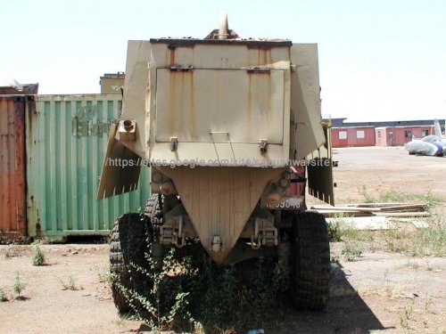

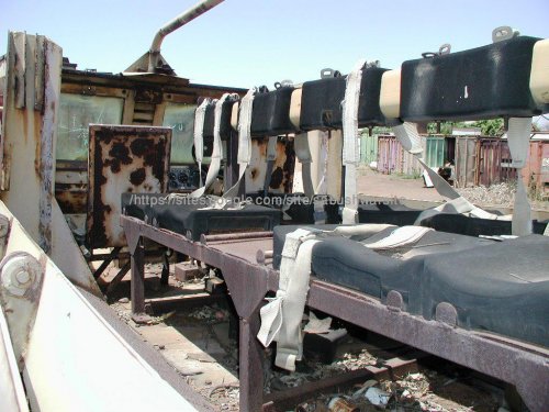

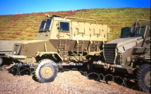

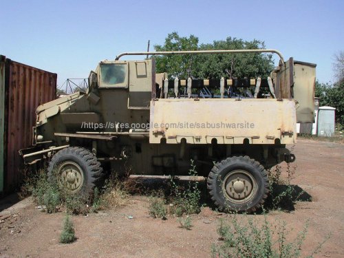

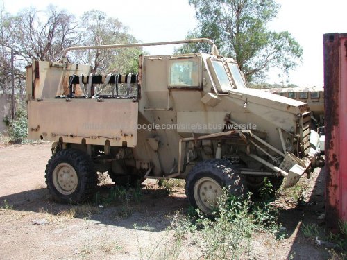

Walk-around of the SIREB.

Nice pics SABushwar.
Where and when were they taken?
There appear to be Impala fuselages in the backround, as well as another vehicle, which might be the Hippo MkII if I recall from previous pics of yours?
Herman said:
Reply to post # 1397:
Interesting! Appear to be photo's of Wildebees I.
Photos taken at SAAF museum in 2005. Yes it is the Hippo MkII in the background.
I do not have the book Surviving the Ride (yet!), so cannot verify the other vehicle with the same axles in the picture below. The Wildebees I? can be seen here in a much better condition. These were taken at Fort Klapperkop in the late 1980's. (Re-post).

Anyone seen the armored MAN 8x8 truck that plies its trade in SA. Seen it many times on M1 and N1 and also at reserve bank in Durban. I believe it carries bullion and typically is escorted by many tactual reaction police vans and cars as well as a chopper . Seen a blue one and yesterday a white one
