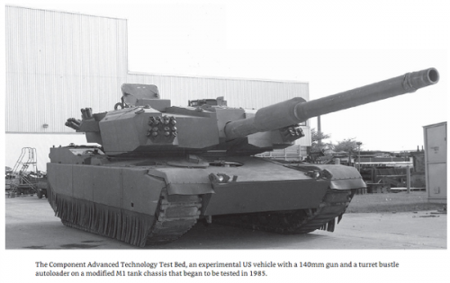

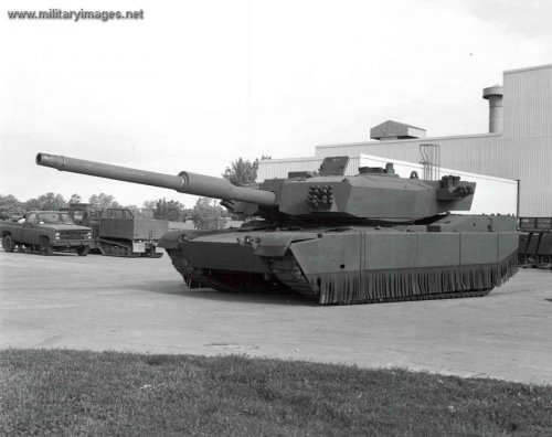

TomS said:
sferrin said:
If they felt the L55 with the latest US DU round wasn't enough they could even go with the 130mm the Germans are playing with.
Not without a massive redesign. The 130mm round is significantly longer than the 120mm. No way it fits in the M1 turret bustle.
http://www.secretprojects.co.uk/forum/index.php/topic,26693.msg284076.html#msg284076
Like I said, a massive redesign. Everything else you talked about could be done within the existing "outer mold line" of the M-1 family. Going to 130mm means a whole new turret, at minimum.

True. Just pointing out they'd done something similar in the past (with an autoloader even) so it wouldn't be entirely new territory. Of course then there's round count; how many 130mm vs 120mm. At the least though, an L55 with the latest US DU round would be an improvement to buy time while they hunt for Leprechaun's gold.

That's certainly true. It could be done, though I suspect it would make sense to go back to a clean sheet to take advantage of newer technology.
Sticking with the M-1 chassis, you'd lose the 6 rounds in the hull and have to do with a longer bustle and autoloader. Fortunately, the 130m round is the same diameter as the 120mm, just 30% longer.
Once upon a time, Meggit designed an autoloader that fits the current bustle and still holds 34 rounds, so you could probably fit about the same number of 130mm rounds in a new turret. The claim it won't even cost you a crew station, which would be interesting -- four-person crew with autoloader might free up the "loader" to run a remote weapon station or some such.

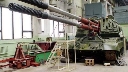

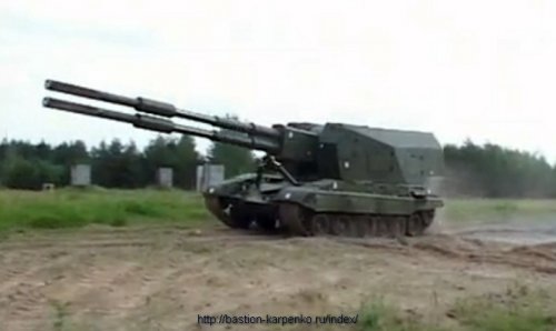

Making a whole tank is hard if you've been out of the game for a while (Object 148 is literally a relic of the Cold War; being essentially an austerity model Object 195 equipped with the 2A82 gun, which is c. 1986), but America has all the pieces sitting around, it just needs to put them together. We don't want to build, but by Jingo if we do, we have the gun, XM291, we have the engine, just use an MTU, and we've the armor in SEPv3 and the ammunition too. The Russians shall not have Tallinn.
The best example of this sort of design austerity I can think of, the kind where you reuse as many pre-developed or already commercially existing parts as possible (thus, the "only" thing that needs to happen is regeneration of the industrial base) is probably GD's Griffin light tank, which is literally a Baby Abrams.
https://1.bp.blogspot.com/-iZL3hDhSJuA/WOeUZdOPDGI/AAAAAAAAAn4/72K-QzmizbcBlMZT-ztFd3NZ29wyWcIIACLcB/s640/Griffin%2B%25282%2529.jpg

Of course nuclear reactor how else you going to power the two rail guns on twin turrets. :eek:
bobbymike said:
sferrin said:
Up next the new DARPA project to come up with ideas to make the next tank as expensive as possible. I'm suggesting an onboard nuclear reactor to save on gas and defend against climate change. Seriously though, it sounds like they're thinking of the "see-through" F-35. If they can port over the software and sensors (albeit smaller) of the F-35 DAS and couple it with the latest COTS consumer VR goggles. . .maybe it wouldn't be a fortune after all.
The Rooskie one has two guns so we need two guns.
