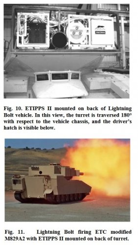

The reduction in ammunition stowage and the cumbersome loading
were in part why the 140mm never progressed. That and it pretty much
required ETC (or other complicated ignition methods) to get reliable and uniform ignition.
ETC would have also facilitated fire-out-of-battery because the muzzle brake that
was envisioned would have had obscuration issues.

Either a 120mm or 105mm ETC Buford should be a consideration for Mobile Protected Firepower (MPF) and beyond.

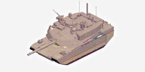

Anyone know what this pic depicts? Appears to be two diamond shaped arrays off each side of the turret front and large bulbous turret appearing not to be satcom but more like a DEW.
PS: this not a photobash.
Probably some picture taken from a 2000 era powerpoint slide. My guess would be the arrays are radars for the defense suite (It's also got some kind of trainable launchers near the sides of the turret) and the bulb would indeed be some kind of laser.

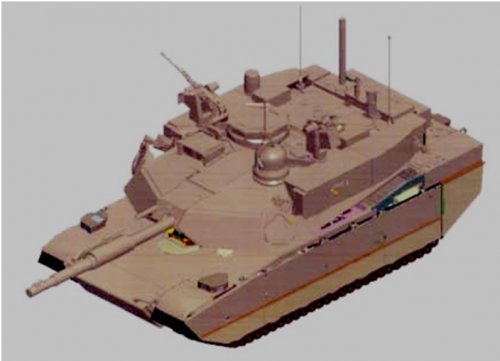

I found a slightly higher resolution pic with google image search.
MihoshiK said:
Thank you for the find Mihoshik.
A 'Lightweight M1A3' (as depicted) certainly deserves a look as entirely new tank seems a bridge too far minus some political changes.
