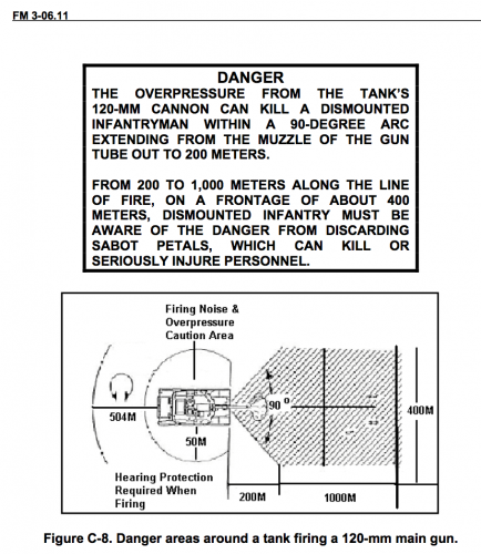

This completely ignores the practical realities of using vehicles equipped with high velocity cannon in the urban environment.
The minimum separation for dismounts from the Abrams while firing is 55 yards. And yet you've consisently advocated for
higher velocity guns for future tanks. This does not contribute to concentrate of force.
And in order to compensate for the inability of tanks to employ high angle fireyou have to employ
two of them (assuming the buildings are short enough as they were in Fallujah but not in Grozny) , separated by a
not-inconsiderable distance, meaning they are not both on line, contributing to direct fire. This does not contribute
to concentration of force.
