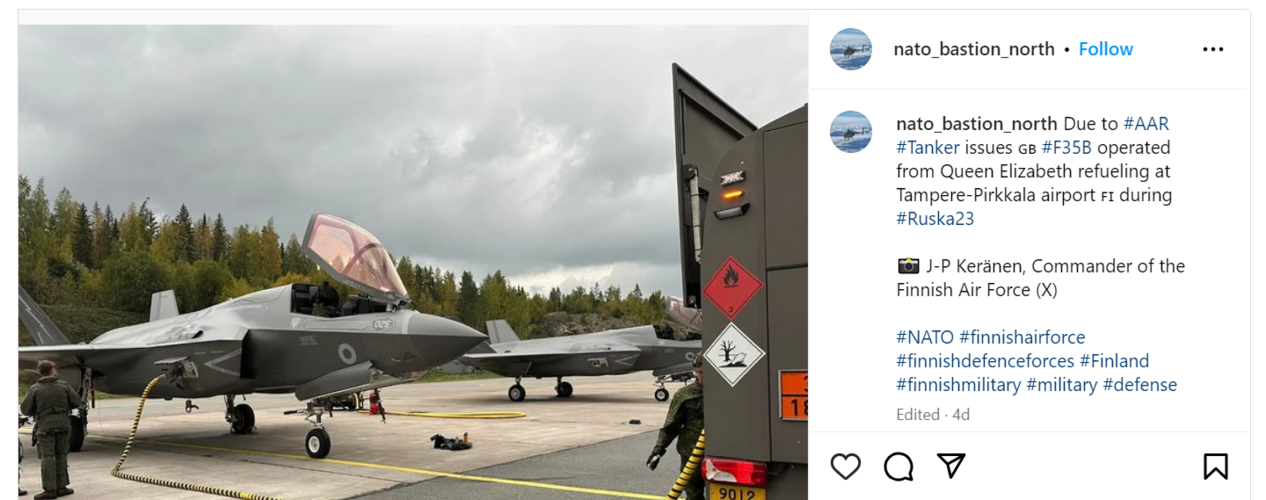

I have understood that the RAF F-35Bs were flying from a carrier off Norway, supported by a tanker. Before landing, the pilot reported that he had fuel for 9 minutes.Hard to say.
I'm not sure if this was an actual emergency, or just training. They had the RAF F-35Bs flying out of that airport during the exercise anyway. Possibly they decided to demonstrate an STO landing, which could be operationally useful even on shore (e.g., for landing on a damaged runway, or a stretch of roadway).
That is one of the advantages, yes. Was at an air show years ago with a Harrier. Announcer apologized for the Harrier not doing the full vertical takeoff because it was too hot and they'd shred the asphalt runway. So we got a super STOL demonstration, IIRC 250ft takeoff and 50ft landing.What is the advantage of a rolling landing vice a vertical one? Less erosion of the landing surface?
How did I miss that piece of news....Seems there were AAR issues and some of the F-35s were refuelling there.
