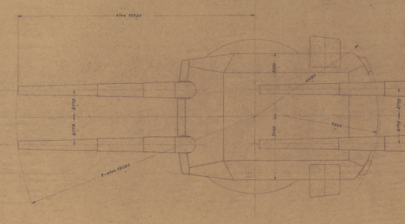

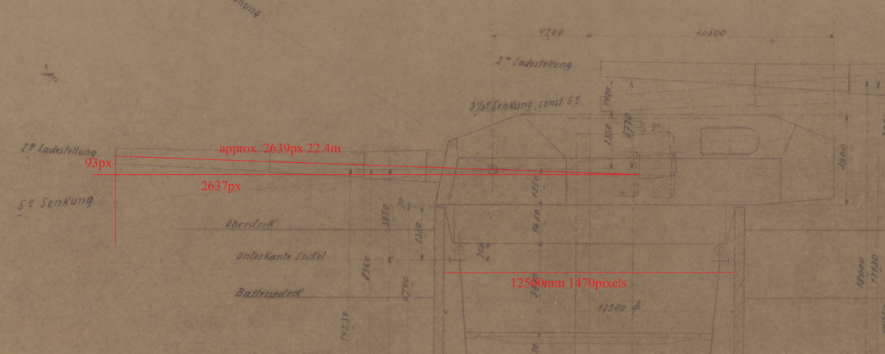

Based on the dimensions of the turret the full length of the gun including the loading trays is 5.500mm. Without it it is around 4.850mm and if I remove the tray length from the breech or that loading mechanism thing than we get 4.200mm which is 5cm/84, very close to the 5cm Flak 41's /86,8 value!
Seems like this is indeed a navalized 5cm Flak 41!

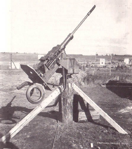

If I recall, the 3cm MK 103 was given "Bord" or "Bordkanone" mounts which were literally just wood and metal "mountings". There is an image or two online for these.
Bordflak = land-based anti-aircraft mountings.
Bordkanone = air-borne canon.
I assume? since i often see "flak" term used for land mountings.
I suppose Bordkanone was used because the MK 103 is really a Luftwaffe airborne weapon first and foremost before a land mount. Flak was the primary word in use for land mountings so I suppose if you have Bordflak then you have a combination of a typically airborne cannon with a typical land mount (Flakvierling, Flak 38, and a piece of wood with some hollow steel supports I guess).
"Bord..." in this context just means used on a ship, or in/on an aircraft.
"Bordflak" : AA gun on a ship
"Bordflugzeug" : Aircraft launched from a ship
"Bordkanone" in most cases used for aircraft guns only.
The special features of the shown model of the Bordkanone Mk 103 are the two types
of gun mountings for, what typically is an aircraft gun.

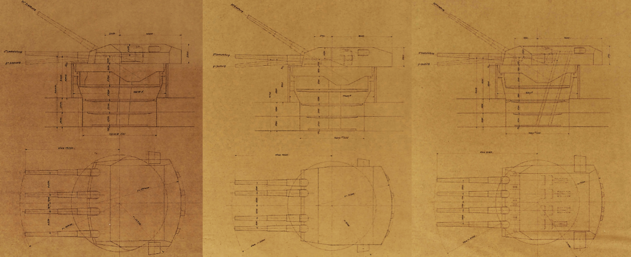

Recently I saw a sketch of the battleship H (RM25/15820), which mentioned 40,6cm C/34f. 1644410528078.png
I remember someone has measured the length of the barrel (including the breech) of the c/34f shown on RM 24/362 (fortunately the link is shown before
actually I started looking up on bundesarchiv after seeing that post), and I did the same and got the same results. It's about 21.1m, same as a 40.6cm/52, so I believe that to be 40.6cm.
RM 24/362, 363, 364, 366 shows the Drh LC/34 f, and 371 for g, 372 for h. The c/34h seems to be larger than the others, with a barrel over 22m in length like a 17in/52(my weird guess before without any reliability). The turret on RM 24/371 has a similar size as on 362 to 364, while the date on 371 is closer to that on 366, both July 1937. 362-364 is later, dated Sept. to Dec., and 371 even later in 1938. And then there's the similar three Drh LC/34 f4s and h4s, and the design of the quad turrets of two different sizes seemed to get optimized together. The dates between f and h were quite close of the three schemes.
This shows the development of Drh LC/34 h4 and f4 is almost identical, except that it's smaller in size.
I know nothing about the process of armament development though so I couldn't get more information from that:(

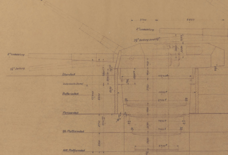

The 1-2-1 arrangement turret is indeed the largest I suspect due to the loading mechanisms. You can see the same at the various twin 28cm turrets for the Zenker designs found at the first posts of this thread.
The smallest is the 4x1 turret while the 2-2 is minimally larger than the 4x1 one.
Found a file name "20,3-cm-Drillingturm" (scale 1:50) but this file dated 1931, likely is an early proposed 20.3cm triple turret for secondaries on aircraft carrier designs that Whitley mentioned about.

Recently I saw a sketch of the battleship H (RM25/15820), which mentioned 40,6cm C/34f.View attachment 673901

I measured the document provided by bundesarchiv (RM 24/373) and if there haven't been a mistake, I've got a result of 22437mm. And as I used MSPaint, if a limit error of 5px each time is introduced, it'll turn out to be (22.44±0.06)m. Here the 0.06m is the standard error while the limit is about 0.12m.
It can either be a longer 40.6 with a 55-caliber barrel, a 42cm with a 53-odd caliber barrel, or a 45cm/50-caliber of some sort.
The 42cm should be a /48 calibre gun as navweaps states that these would be bored out 40,6cm/52 barrels.

Checking out the C/34f and C/34g twins, the 'g' is very slightly larger - by no more than about 5% in most measurements - which is a rather small increase in size. I wonder why, if they're the same 40.6cm guns?
Checking the 'h', it's a massive increase in size.
Trunnion to Rear of Turret:
f: 13200
g: 13650
h: 14700
Width of Turret:
f: 9600
g: 10100
h: 10900
Width of Barbette:
f: 11000
g: 11500
h: 12500
53cm/45 for comparison:
Trunnion to Rear of Turret: 16350
Width of Turret: 12800
Width of Barbette: 14200
38cm/52 C/26 for comparison:
Trunnion to Rear of Turret: need to do maths
Width of Turret: 8900
Width of Barbette: 10600
38cm/52 C/34d for comparison:
Trunnion to Rear of Turret: more math
Width of Turret: still more math
Width of Barbette: 10500
So, some obvious conclusions:
- f-h is increasingly larger in turret size
- f and h are different size guns
- g is either a 40.6cm gun like f or an intermediate caliber between f and h (need to remeasure barrel lengths and confirm)
- h is no larger than 53cm, and in fact comes nowhere NEAR the size of the 53cm twin.
With all of these in mind, I can make some surefire assertions:
- This is not a 50cm gun.
- 43cm was never considered by the KM as far as I am aware, and I do not believe it is mentioned in any sources that I am aware of.
This leaves me with:
45cm/50-caliber.
However, I will not discount the idea of a 43cm/52-caliber gun. There could be a source out there. The KM has considered a wide variety of calibers including 17cm, 19cm, 21cm, 35.5cm, 42cm, 48cm, etc. It would not be out of the ballpark to think that 43cm may be one of these calibers. 45cm is just what I feel comfortable with as it's already been established as a caliber the KM have or will consider, albeit at /60-caliber length.
