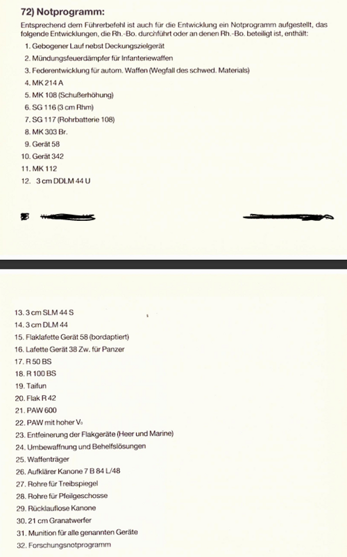

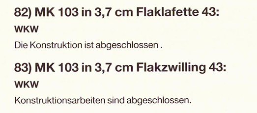

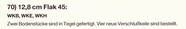

Here are some more images and translated text.
Translation:

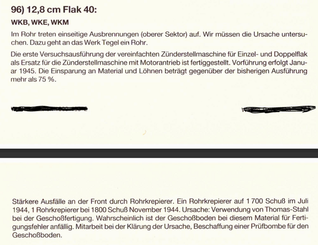

96) 12.8 cm Flak 40:
WKB, WKE, WKM
Burnouts occur on one side of the barrel (upper sector). We need to investigate the cause. For this, a barrel is being sent to the Tegel factory.
The first test execution of the simplified fuse setting machine for single and dual anti-aircraft guns, as a replacement for the motor-driven fuse setting machine, has been completed. Demonstration is scheduled for January 1945. The material and labor savings, compared to the previous version, amount to more than 75%.
Increased failures at the front due to barrel bursts. One barrel burst for every 1,700 shots in July 1944, one barrel burst for every 1,800 shots in November 1944. Cause: Use of Thomas steel in shell production. It is likely that the shell casing is prone to production defects with this material. Cooperation in clarifying the cause and procurement of a test bomb for the shell casing.

82) MK 103 in 3.7 cm Flak Mount 43:
WKW
The design is completed.
83) MK 103 in 3.7 cm Twin Flak Mount 43:
WKW
Design work is completed.

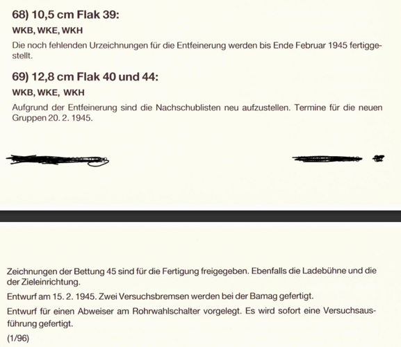

68) 10.5 cm Flak 39:
WKB, WKE, WKH
The remaining drawings for the refinement will be completed by the end of February 1945.
69) 12.8 cm Flak 40 and 44:
WKB, WKE, WKH
Due to the refinement, the supply lists need to be recompiled. Dates for the new groups are set for 20 February 1945.
[Redacted text]
Drawings for the Mount 45 are approved for production, along with the loading platform and the aiming device.
Design dated 15 February 1945. Two test brakes are being manufactured at Bamag.
A design for a deflector at the barrel selection switch has been submitted. A test version will be produced immediately.

70) 12.8 cm Flak 45:
WKB, WKE, WKH
Two base pieces have been manufactured in Tegel. Four new breech wedges have been ordered.

72) Emergency Program:
In accordance with the Führer’s directive, an emergency program has been established for development, including the following projects that the Rh.-Bo. conducts or in which Rh.-Bo. participates:
  1. Curved barrel with cover sighting device
  2. Muzzle control adapter for infantry weapons
  3. Spring development for automatic weapons (elimination of Swedish material)
  4. MK 214 A
  5. MK 108 (increased firing rate)
  6. SG 116 (3 cm aircraft cannon)
  7. SG 117 (battery for 108)
  8. MK 303 Br.
  9. Device 58
  10. Device 342
  11. MK 112
  12. 3 cm DDLM 44 U
[Redacted text]
  1. 3 cm SLM 44 S
  2. 3 cm DLM 44
  3. Anti-aircraft mount Device 58 (adapted for onboard use)
  4. Mount Device 38 Zw. for tanks
  5. R 50 BS
  6. R 100 BS
  7. Taifun
  8. Flak R 42
  9. PAW 600
  10. PAW with high V₀
  11. Refinement of anti-aircraft devices (Army and Navy)
  12. Conversion armament and emergency solutions
  13. Weapon carriers
  14. Reconnaissance cannon 7 B 84 L/48
  15. Barrels for propellant mirrors
  16. Barrels for dart projectiles
  17. Recoil-free cannon
  18. 21 cm mortar
  19. Ammunition for all aforementioned devices
  20. Research emergency program

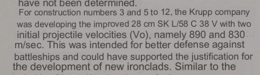

Does anyone know of German naval gun projects for Panzerschiffe or heavy cruisers? There was a 210mm gun planned for the Reichsmarine I/10 project in the 20s, but beyond that there isn't much.
There was a 283mm/58 "C/38V" gun planned for some of the later Panzerschiffe; Breyer translation:

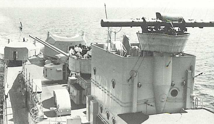

G'day, I was wondering if anyone has any photos or blueprints of the 8.8cm/75 SK C/25 mount that was temporarily tested on the Konigsbergs before it was swiftly replaced. It just looks so weird that it made me interested in how it actually worked and was operated. Here are some of the photos I've collected of it for context and so they aren't reposted:
