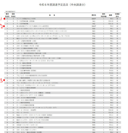

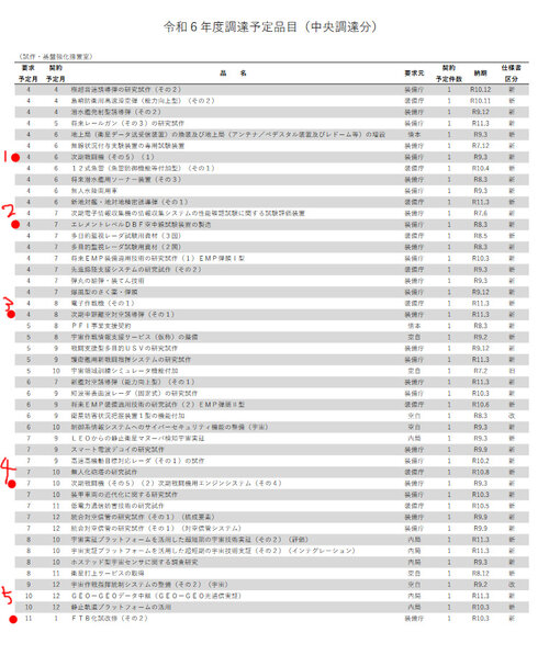

The procurement schedule in this financial year was opened at ATLA site
I pick up the related part with next gen fighter.
1: Next gen fighter(no.5 )(1)
2: Manufacturing of test equipment for element level DBF antenna
3: Next mid-range AAM(no.1)
4: Next gen fighter(no.5)(2) engine system for next gen fighter(no.4)
5: FTB(no.2)
1,4 are next phase of preliminary design for air frame and detailed design for engine that have been worked last year.(or one after next for engine)
2 will be related with performance test of the mission system integration that public notice was open in this month
5 is C-2 FTB for the mission system integration.
1: Development for engine e-power generator capability improvement(probably be related)
2: Demonstration experiment for UAV attritable system
3: Research study for CCA

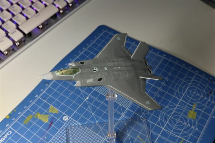

my work with 3D printer:D
I used decals of 1/144 F-35 .
That's a nice desktop model:)
