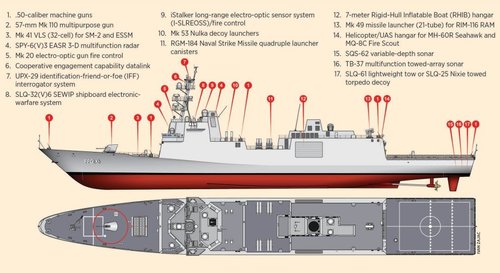

I found this site on the FFG (X). There is also an email address for questions.
That's a lot of .50-calibers (I count 10).

I'm not sure that .50 cals would be the weapon I'd choose to deal with boat swarms. I'd rather have seen a pair of 30mm, as in the LCS ASuW fit, for commonality and ABM ammo, but at least the machineguns are cheap. The 57mm is clearly going to be a much more significant line of defense here. I hope ALaMO lives up to its promise. (And not up to its name...)
No but it seems it's all they're willing to pony up for. A ship or two will have to be attacked before they pull their heads out.

That's also the 30mm Mk44, not the 57mm Mk110. Plus, no guided rounds. The main swarm-killing will be done with ALaMO and/or weapons launched from helos/UAVs.
The .50cals are point-blank defense and they're included because they're cheap and the Navy can pretty easily train Specialist Bonehead to do some damage with it without taking a big bite out of the time needed to train said sailor on other things.
