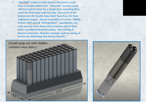

The mods I was talking about would include the ability to fire 24 missiles without reloading, and integrate a fire control system with the shipboard combat system, so yeah, that's a bit more of a modification than bolting a tripod launcher on deck and hoping for the best. But I'm inclined to agree with bring_it_on that there are better ways to accomplish the purpose of FFG(X) without a permanent Hellfire launcher.
Depends. I was thinking something more like this (could substitue VLS Hellfire near term).
That's not actually how the current Hellfire SSMM works. There isn't a Hellfire canister (which I only just realized today). SSMM actually uses a pair of enclosed boxes with it looks like 12 rails attached to the inner surface of each box. Each rail has a Helllfire attached, but the missiles are not encapsulated or separated from each other inside the larger box. Which helps explain how they put this together with so little development work. I suspect there are three pairs of M310 dual rail launchers just bolted to the inside of each box.
Check out the first few seconds of video here:
This wasn't an attempt to describe the system they tested. Just noodling with a configuration. That said, they could probably modify Hellfire for VLS that wouldn't require a rail.
I know. I was thinking that this design is not compatible with Hellfire as fielded. It might be adaptable, using something like the Hellfire adapter they designed for ExLS. I'd definitely want to go retain the missiles at the top, though, to prevent them from whipping around in shock situations.
