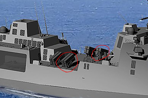

This seems more likely. There's probably room for one of the LCS SUW package's SSMM launchers (w/24 Hellfire) in lieu of one set of 8 NSM. This was hinted at somewhere up thread, IIRC.
If their engineers can't fit more than 24 Hellfire in the space taken by 8 NSMs they should be fired. :confused:
I'm not talking about a theoretical maximum, but a realistic and affordable option.
I'm speculating about reusing using the existing SSMM launcher developed for LCS. On LCS it drops into one of the weapons system module spots, which is something like 15.75 ft x 14 feet x 8 feet and has a max weight capacity of 16,500 pounds. Now, I know the SSMM probably does not max that out, but that's the worst case.
A set of 8 NSM Launchers and associated hardware weigh about 17,000 pounds. On FFG(X), the NSM sit on a weather deck, so to use SSMM, you'd need to add an enclosure around it. I'm not saying it would weigh the same as 8 NSM, but we're in the same ballpark here. Possibly you'd have enough weight left to add a couple of 25mm Mk38 Mod 3 (The Mk46 needs deck penetration or another added deckhouse, so I'd rule that out).
Of course, if you really anticipate dueling FIAC, bring an ASuW LCS instead. Might as well use them.

Here is an image of the SSMM in an article from last year.

For Flight II, it might be interesting to fit a few ExLS around the ship. You could replace the RAM and Nulka launchers, eliminate a bunch of moving parts, and have some launcher space left for Hellfire if needed.
L3 claims that the ALaMO has an extended range round with accuracy for the type of FAC threats we may need something like a Hellfire for. So if that can form the outer layer of that capability then the HEL can form the inner layer and double up as a C-UAS system as well. The Navy has already tested the AN/SEQ-3 against this type of threat and what is likely to go on a FFG(X) is likely to be between 3-5 x the power levels so they'll have an excellent idea in terms of what, in terms of the level of swarm, threats these two systems can deal with together.

Just replace the forward bank of 4 on each side with Hellfire VLS.
Couldn't additional vls cells be added in place of NSM launchers? I know that the JSM variant built for the F35 can also fit into an mk41 cell.
AFAIK, VL-Joint Strike Missile does not actually exist yet, beyond an engineering study.
NSM is as close to a commercial off-the-shelf procurement as the US Navy is likely to achieve for a major weapon system. Adding the development effort to switch from NSM to JSM and add VLS compatibility is an expense the Navy is not interested in taking on.
And it's not trivial to replace the on-deck box launchers with VLS. A new VLS installation there would have to penetrate below the current launcher location (by at least one deck, possibly two) displacing whatever spaces are down there already. That's a lot of redesign work, when the box launchers already do the job.
Does one seriously need to significantly modify a 7000+ ton ship to fit 'man portable' weapons?
Couldn't they build cells above the deck like mk 48 vls?

Note that those are attached to the side of a superstructure, not above it. And Mk48 is very small, two meters shorter than a Strike-length MK 41 and a half meter shorter than even the Self-Defense Mk 41 (which isn't in use and would not hold a VL-JSM anyway). Also, a suitable VLS would likely weigh significantly more than the dedicated box launchers for NSM.
