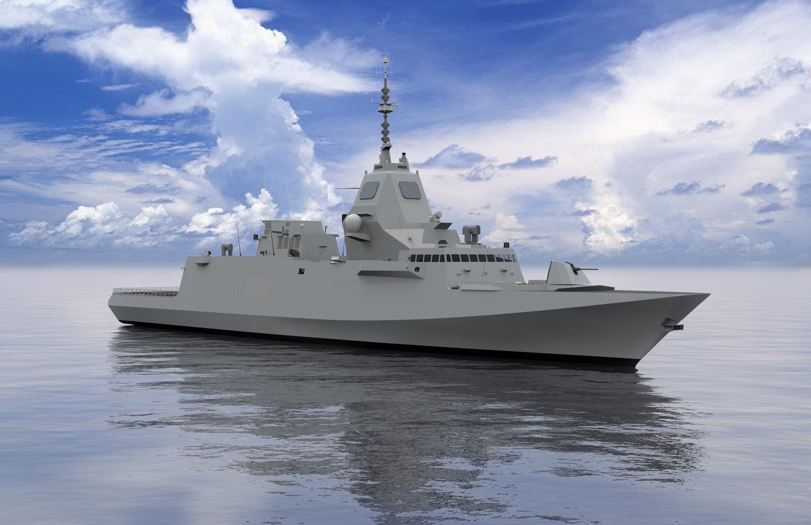

Would be an interesting counter factual if the USN had insisted on a minimum-change FREMM, with flat panel SPY radar but no platform changes from the main deck down, no propulsion changes etc.
Might have looked a little like this 2017 Canadian FREMM proposal (though without some of the French looking topside design tweaks, as this was a joint Fincantieri-Naval Group submission).
