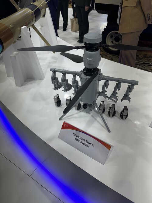

This funny little robot with six hand grenades is really what the future of CAS will look like. Make the hand grenades aerodynamic, and impact fused HEDP rounds, and you have a really lethal weapon against infantry and light to medium armored vehicles.
A $90 million airplane isn't really attritable enough to fight in close combat at low altitudes anyway. Gun runs probably won't vanish but they won't be in the realm of LSCOs either. They'll be like something where Belizean or Honduran A-10s will strafe caravans of drug mules in Central America or whatever.

Hand grenade drones are so effective they've forced an order of magnitude reduction in troop densities compared to the A-10 and Su-25, and a halving of densities compared to Future Combat Systems, Force XXI, and the EXFOR of the 1990s. It's kind of mind boggling, since Army After Next was talking about 100 kilometer brigade frontages in 2050, not 2025.

Six quadcopters is fully capable of killing an armored brigade. It would be a significant planned operation though. That said they would have enough grenades to drop on nearly every vehicle accurately and probably hit them in vital spots, because the operators aren't stupid, unlike a spin distributed random scattering of the same grenades from a cluster bomb.
The lethality of the drone is that it is simple, cheap, easy to use, guided all the way to target, and can perform ISR, BDA, and attack in a single action. In prior eras this required very sophisticated organizations to do. What once needed a Corps and COCOM air planning cell and tactical fighter wing equipped with air to ground missiles can be done by about two or three guys in a truck with some small 40-60mm shaped charge grenades with 3D printed stabilizer fins on them.
The end result is the same: burning armor and dead tankers.
It won't replace aircraft, of course, but it will certainly liberate them from the need to babysit ground troops with CAS runs and let them perform the much more important job of degrading enemy air defenses for major attacks on C4I nodes, counterbattery, and operational-strategic logistical elements such as ship convoys.
Again, the best CAS aircraft for the XXI century is going to be a DJI Phantom with a rack of six little 40mm ICM bomblets that can defeat roof armor and kill a tank by detonating ammo under the turret, or under the bustle rack, or lighting the engine on fire, or whatever.
This scenario raises many questions. Does this armored brigade have no support? It's just spread over 100km with no apparent objective other than hold territory? In that context and assuming no upgrades to those tanks, I suppose those six quadcopters could gradually grind it down to nothing. But in that same context a pair of AH-64s or modernized A-10s could do it faster.

In that context and assuming no upgrades to those tanks, I suppose those six quadcopters could gradually grind it down to nothing. But in that same context a pair of AH-64s or modernized A-10s could do it faster.... a F-35 lobbing GBU-53s or an attack helicopter launching off 16 ATGMs is going to be much more effective, although less available because of high demand.
For a AH-64, you can get like 1,000 baba yaga drones.

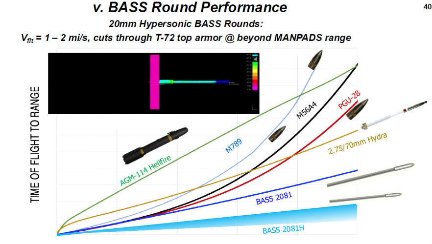

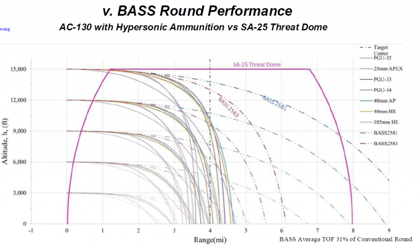

Back when long range suppression resistant ATGMs where 400k/shot items it is far too expensive to hand out to grunts and was centrally controlled and consumed by the likes of airforce on critical parts of the front. In this day and era, one gets a FOGM by spending 2k in a hobby shop for parts.
Unless some new high cost, high effect, low weight munition munition is developed, air support is unexciting since ground forces can bring far more. That said, air power can still be useful due to mobility, but it just means payload adaptors since smart weapon systems don't demand much from transport platforms.
