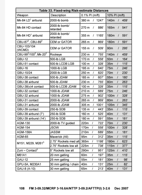

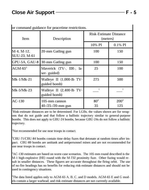

Because most of the quarterback's weapons are honestly best from medium altitude, not from the weeds. APKWS, SDBs, JDAMs, etc. Gun is the last resort for when the enemy is way too close, as a function of the various danger-close distances.
If, assumed, the primary operating environment for your "quarterback" will be at med alt, with specific conditions for the employment of gun strafe, and sensor, self analysis and comms fidelity are potent enough, I'd suggest going full VLO with an upsized X-47B toting full-on Boeing's IWB deployed airborne howitzer, true multifunction DEWs, off/defensive missiles and mini-drones ala super stealth AC-130.
Seriously though, your quarterback operates with a gun anyway, and the employment of a gun place severe limitations on the configuration and tactics of a CAS plane without some major breakthrough eg hyper accurate airborne mini SLRC. Maybe some basic shaping and (which is the opposite of as-much-as-possible in my understanding) like a blended, chined Scorpion with Supabug intakes.
