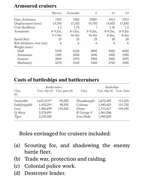

Why start from a hypothetical when you have the actual E2 and E3 ACR designs? Plus E from 1911
E: 15,750 tons, 4x2 9.2in, 16x 4in, 25kts, 6in belt, c£1.45 million
E2: 15,500 tons, 4x2 9.2in, 8x 6in, 28kts, 6in belt, c£1.35 million
E3: 17,850 tons, 4x2 9.2in, 8x 6in, 28kts, 6in belt+4in upper belt, c £1.5 million
This is interesting: one or more warships for Australia roughly equivalent to the Deutschland-class pocket battleships. Perhaps a better fit for the country's interwar financial and shipkeeping capacity than, and perhaps a greater potential against Japan than, one capital ship. The 9.2-inch caliber you three favor was retired by the Royal Navy immediately after WW1, but as I understand, it stayed in service with the British Army until the 1950's.
DWG, what is your source for the E, E2, and E3 projects that you mention? I would like to do some further reading on this thought-provoking subject.
DK Brown, The Grand Fleet. I can't recall off hand whether there's anything in Friedman.

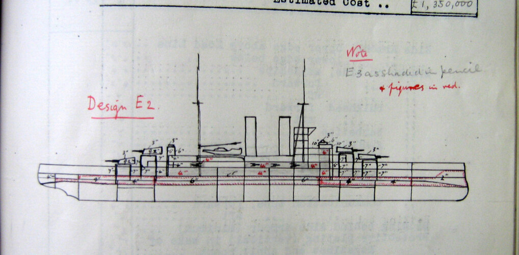

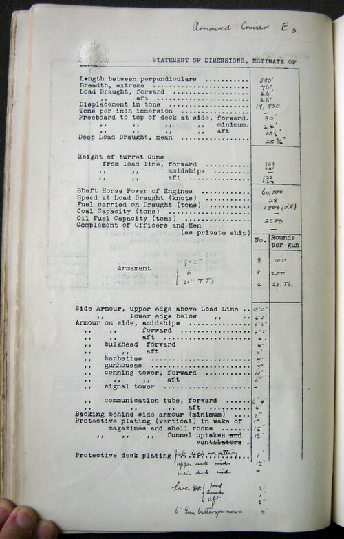

The following was posted on (I think) an older version of the board....
Unfortunately it's only details for one of the series....

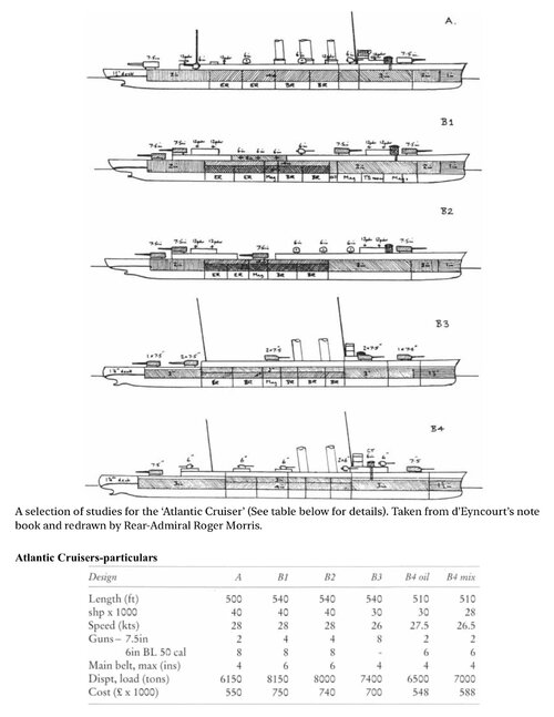

I have some info from years ago... off the internet.

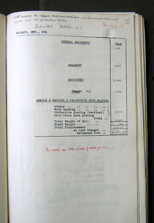

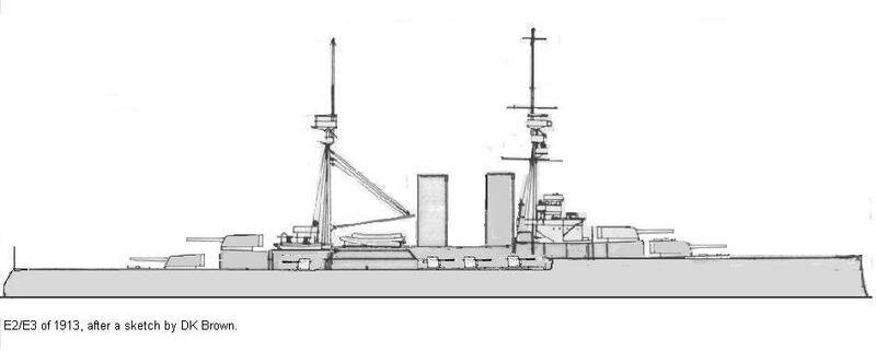

RN Atlantic cruiser designs of 1913

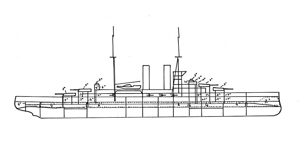

T2, E2/E3: a pair of armoured cruiser designs from 1913 contained in Eustace Tennyson d'Eyncourt's notebook.
Drawings of the "Atlantic" cruisers of about the same time were published in "Grand Fleet" by DK Brown. They are in the d'Eyncourt notebook, but there are also drawings larger scale in the Ship's Cover at the Brass Foundry. Those published in DKB's book had actually been redrawn by Rear-Admiral Roger Morris, based on d'Eyncourt's notebook.
E2/E3 drawing: Redrawn from a sketch DKB had made from T d'E's notebook. It doesn't have the armour scheme, either.
E2 £1.35M; E3 £1.5M;
E3 is the larger ship with the deeper belt, but her displacement is 17,850 tons against the smaller E2's 15,500. (Did you take it to be 11,850, BCR, from the handwriting?)
They are traditional, if modern style, armoured cruisers rather than light battlecruisers. What I mean by that is they were designed for cruiser functions; aimed to be cheaper than battlecruisers (but not enough to build many more even at Invincible level) and would have no chance in a 1914/15 battleline. Updated Minotaurs. Speed 28knots. Guns (4x2) 9.2in; armour belt 6" to 4".
DK Brown did a comparison in "Grand Fleet" and gave them little chance against Invincible, let alone their contemporaries, Tiger or even Renown.
1913 E2 / E3
15,500 normal / 17,850 normal (not the sum of the weights below because of fuel and stores)
560’ pp / 580’ pp
75 beam / 76 beam
26’; 28.5’ deep / 26’; 28.75’ deep
55,000 shp / 60,000 shp
28 knots / 28 knots
2500 tons oil / 2500 tons oil (1000 at normal load)
(4x2) 9.2in / (4x2) 9.2in
(8x1) 6in / (8x1) 6in
4-21”TT / 4-21” (submerged I think 20 torps)
Weights
5500 / 6000 hull
3560 / 5070 protection
1900 / 1900 armament
2700 / 3000 machinery
685 / 700 general
155 / 180 board margin
E2 internal arrangement:
E2 M scale approx:
Part of Post 134.

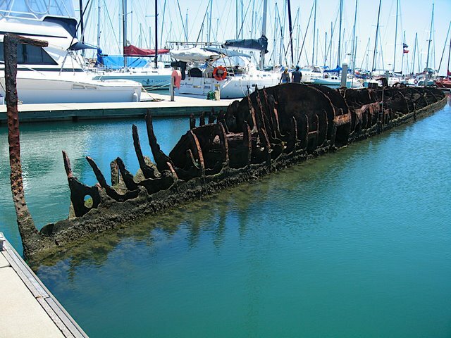

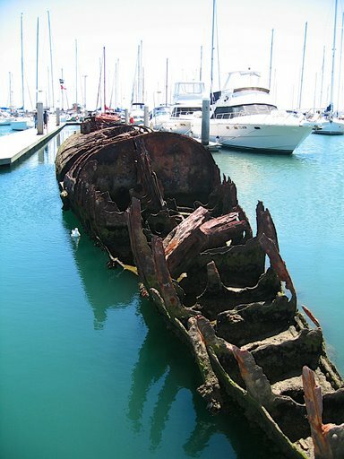

However, the entry on the HMAS Platypus (I) on the RAN website says some things of interest
HMAS Platypus was built to the order of the Australian Government. After completion in March 1917 she passed to the control of the Admiralty until 25 March 1919 when she was commissioned into the Royal Australian Navy at Portsmouth, under the command of Commander Edward Boyle VC RN, as a Submarine Depot Ship for six J Class submarines transferred as a gift from the Admiralty to the Royal Australian Navy.
Platypus sailed from Portsmouth on 8 April 1919 and with the submarines in company proceeded to Australia via the Suez Canal, arriving in Sydney on 15 July 1919.
In February 1920 Platypus proceeded to Port Phillip where a Submarine Depot had been established at Geelong. In May 1922 the Naval Board decided to abandon the policy of maintaining a Royal Australian Navy Submarine Service. The three J Class boats remaining in commission were paid off, and on 1 July 1922 Platypus proceeded to Sydney. On 12 July at Sydney she paid off as a Submarine Depot Ship and on the following day recommissioned as a Destroyer Depot and Fleet Repair Ship. Operating with the Fleet, mainly in home waters, she served in this role until 1929.
Meanwhile, in 1924, a Five Year Naval Development Programme had been approved by the Australian Government, which included the re-establishment of a Royal Australian Navy Submarine Service with a flotilla of six boats.
Two Royal Navy Odin Class submarines were initially ordered. Named Otway (I) and Oxley (I), the submarines reached Sydney on 14 February 1929. Platypus returned to Sydney from a cruise in Queensland waters the following day. She paid off on 31 March 1929 to recommission in her former role as a Submarine Tender.
The reconstituted Royal Australian Navy Submarine Service suffered from the outset from the world wide naval retrenchments beginning in 1929. On 10 May 1930 Otway (I) and Oxley (I) were paid off into Immediate Reserve with provision for one day diving exercises per fortnight each boat. As a result it was decided to use Platypus as a Depot Ship at Garden Island, acting also as parent ship for the submarines.
Platypus paid off on 15 August 1929 and the following day commissioned as HMAS Penguin. In April 1931 Otway (I) and Oxley (I) were transferred to the Royal Navy.
Platypus continued in service as the Depot Ship at Garden Island, Sydney, under the name of Penguin until 26 February 1941 when she recommissioned as HMAS Platypus to resume seagoing service as a training ship.
Although the entries on each and every J class submarine on the RAN website says that the entire class was paid of on 12.07.22. Five boats (J.1 to J.5) were sold in 1924 and sunk in 1926. However, J.7 wasn't sold until 1929 and was sunk in 1930.
The RAN website's entries for Otway and Oxley say they commissioned in 1927, but they didn't said for Australia until 15.11.28 and arrived at Sydney on 14.02.29. The entries also say that Otway and Oxley paid off into Reserve on 10.05.30, alternating with each other once weekly for diving exercises. Otway and Oxley paid off on 09.04.31 for transfer to the Royal Navy, commissioning as HMS Otway and HMS Oxley on 10.04.41. They sailed from Sydney (for Malta) on 29 .04.31.

1913 E2 / E3
560’ pp / 580’ pp
75 beam / 76 beam
28 knots / 28 knots
Weights
5500 / 6000 hull
685 / 700 general
Is a 1% margin for weight growth really that typical for ships of this time? (My interest is generally more WW2 than WW1 and before)
I recall reading in DK Brown about the 'Armoured Cruiser' design, a sort of Queen Elizabeth class BB in miniature idea....
Also these…
From D.K. Brown ‘Grand Fleet’, plus, a selection of later “Atlantic Cruiser” designs
Thanks to Pirate Pete and BlackBat242 for posting this detailed info, before I could access the cited DK Brown book at the public library. I won't bother engaging with those pedestrian 7-8kt cruiser designs, because relying on a modest fleet of cruisers and destroyers and corvettes (no submarines) is what the Royal Australian Navy actually did in the Second World War. Arguably that may indeed have been the country's optimal choice, considering all feasible alternatives. But in a thread like this whose very raison d'être is counterfactual history, I prefer to discuss vessels of more zest.
'E3' seems like a lot of ship for only eight 9.2" guns, the equivalent of Germany's SMS Blücher mistake. And seen in hindsight, the 25 knots of 'E' is just too slow—might as well keep already-paid-for battlecruiser Australia in service instead. How about two or three of the 'E2' design (or Atomic Coyote's similar design) for the RAN? I will call them Tiger cubs as per author Alexander Clarke. They would not be laid down in the UK in 1913, but after the Armistice, so that their design can incorporate post-Jutland magazine protection improvements and the vast increase in attention to torpedo defense in 1919 as compared to 1913. (HMS Defence of comparable size exploded at Jutland, killing her entire crew.) And 1919 would allow a more efficient geared drive for the turbines, rather than the older direct drive. While sort of "pocket battleships", the Tiger cubs are not capital ships, and thus are not banned by the Washington Naval Treaty. As mentioned in post #69 above, Australia never did have a battle line, so the Tiger cubs not being powerful enough for the line is of no consequence. They would fit into the Sutherland drydock in Sydney.
With the benefit of hindsight, I would delete E2's underwater torpedo tubes and torpedo magazines, and use the saved weight and space for better purposes. As Atomic Coyote mentioned, the Tiger cubs' anti-aircraft weapons would have to be greatly strengthened in time for service in WW2. Plus a substantial increase to the main battery's no-doubt inadequate original max elevation.

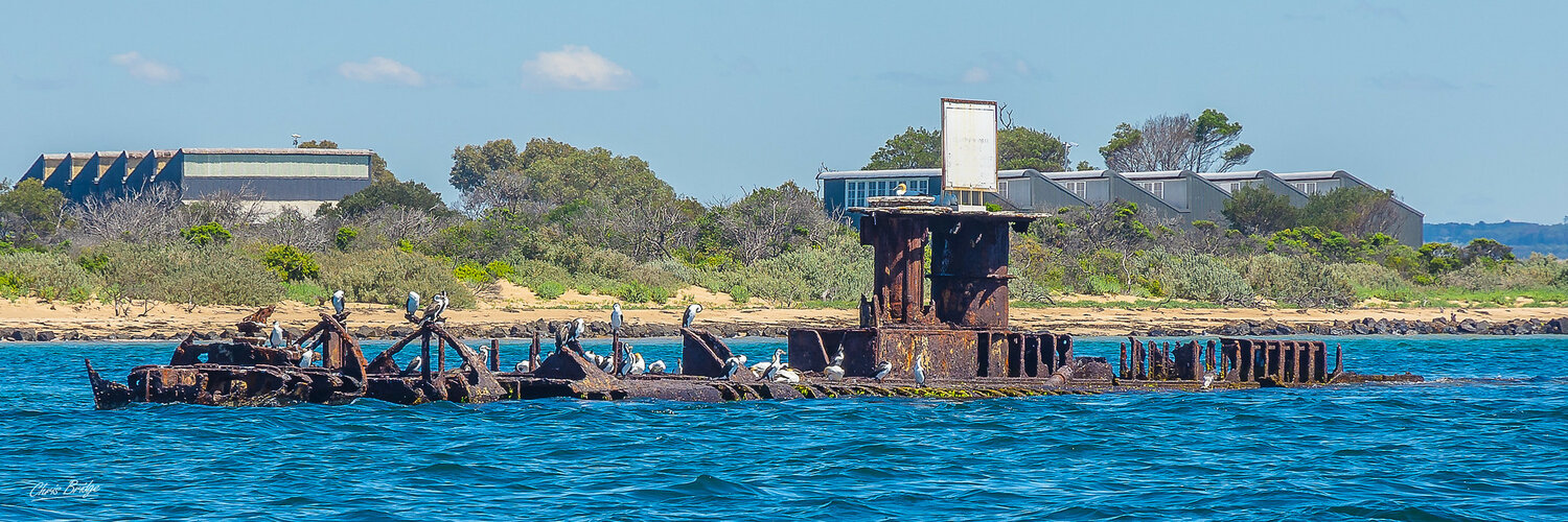

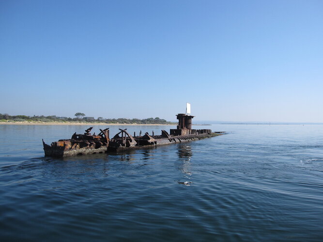

Interestingly, there are two of the RAN's J-class subs whose hulks are still in existence.
J-3 is located just off the tip of Swan Island (pics from the World Naval Ships Forum, taken in 2014-19):

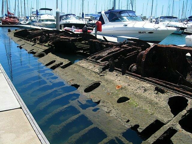

J-7 was sunk as breakwater suburban Hampton Victoria in 1929, now Sandringham Yacht Club 1 (same pic source, 2013-15):
J 7 sank as breakwater suburban Hampton Victoria in 1929  now  Sandringham Yacht Club 1.JPG
