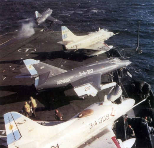

A fully bombed-up A-4F Skyhawk (the model the Australian birds were modified from), while 3000 lbs lighter than a bombed-up FJ-4, has about the same stall speed on takeoff, which means in practice the differences in takeoff performance are surprisingly small.
Argentina could fly Skyhawks off of Karel Doorman without unduly modifying her catapult equipment, but the Argentine A-4Q was based on the A-4B, which was another 3000 lbs lighter than the A-4F.

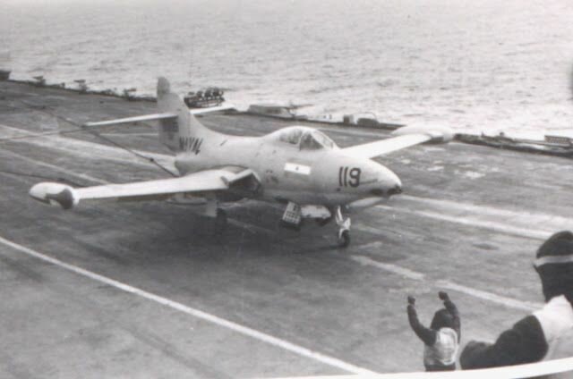

Our naval aviation never operates the F9F from the ARA Independencia, with regularity. (Colossu class with the original cat) Catapult did not have enough power.
Only one pilot do a landing on it
This is the only phot of the F9F on Independencia
I would have liked this image to be the normality.
I almost sure that the Karel, with her BS4, could operarted the F9F and Fj-4.

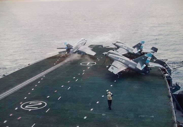

We almost launch and attack (falklands / malvinas war) with A-4Q from the ARA 25 de Mayo former KD) : the load was set: 6 x 227 snake eyes and 2 x1300lts drops tanks.
Due to the lack of wind and the top speed of 20 knots of the aircraft carrier, the load of the aircraft began to decrease, until it reached a point where the attack was cancel.

Here un link to video, from the face page of ARA 25 de mayo (Most ex former sailors)
View: https://www.facebook.com/100001810803715/videos/269995745065932
Click on link
