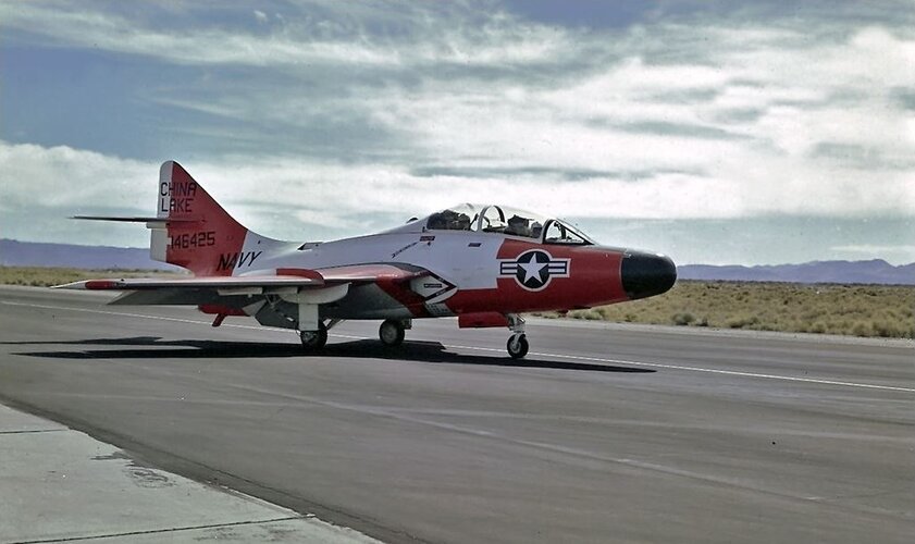

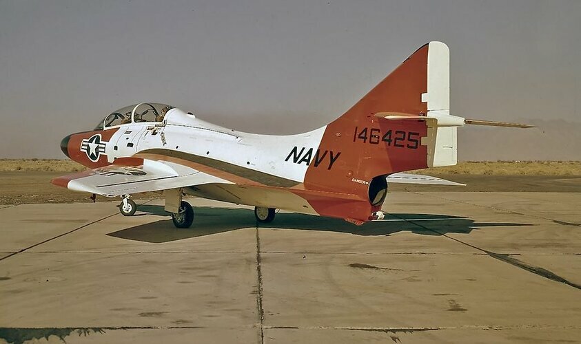

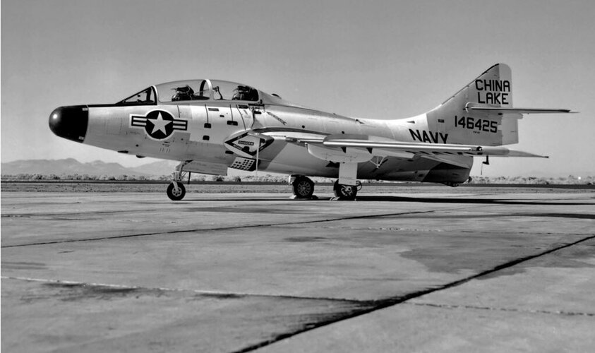

Here are photos of the night-fighter test F9F-8T 146425 with APQ-89 at Armitage Field, NWC China Lake 14 Sept 1961:
US Navy F9F-8T 146425 with APQ-89 Armitage Field China Lake 14 Sept 1961 1.jpg
US Navy F9F-8T 146425 with APQ-89 Armitage Field China Lake 14 Sept 1961 2.jpg

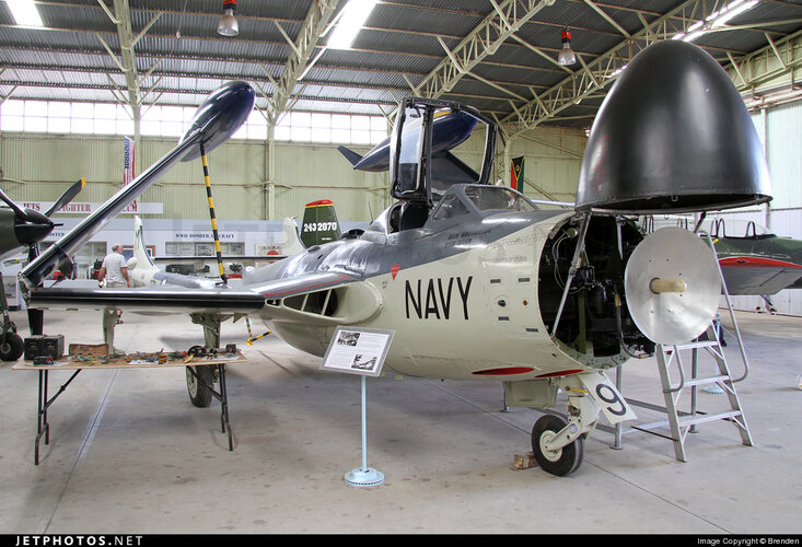

The F9F-8T night fighter lost all of its cannon in gaining the radar (its only air-air weapon was to be 4 AIM-9 Sidewinders) - the FAW-53 had 4 x 20mm cannons and 8 unguided rockets.

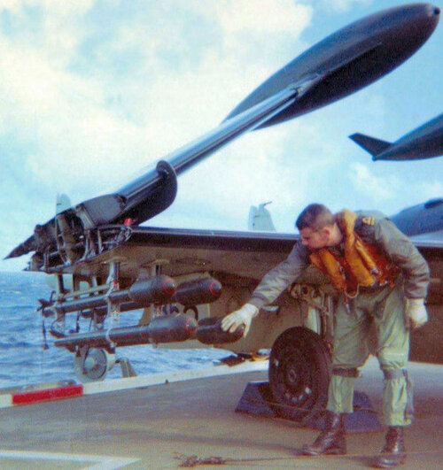

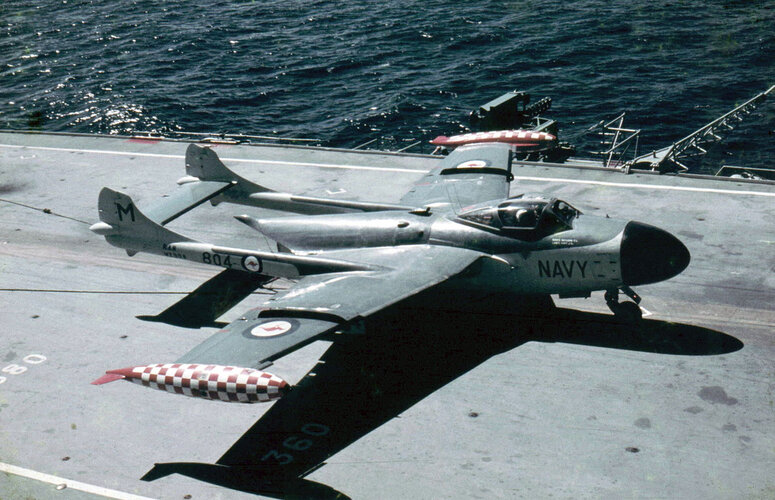

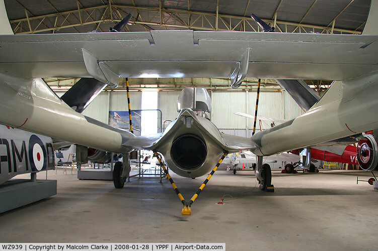

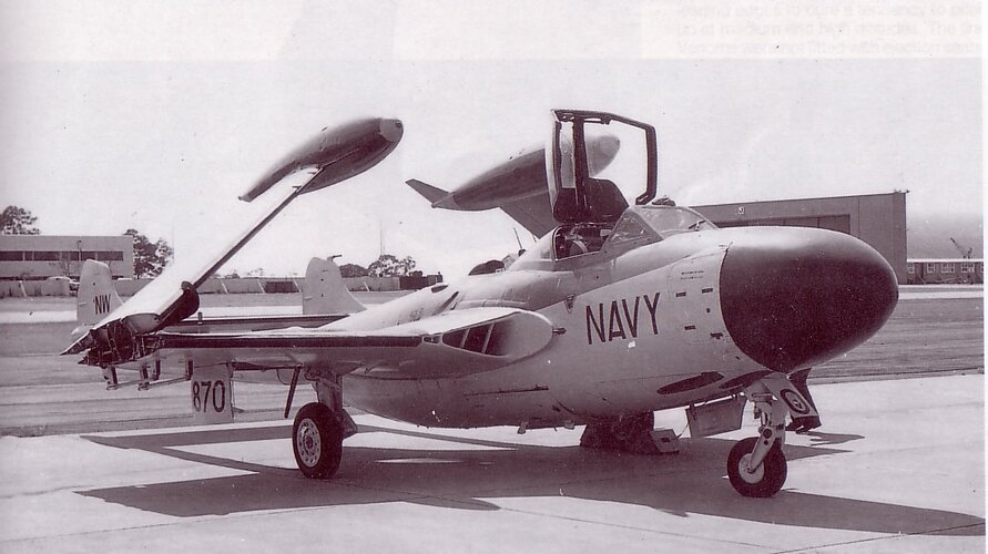

Fitting Sea Venoms for AIM-9s would be a lot easier than making a gun pod for the Cougars (or adding a fairing for 1 or 2 x 20mm cannon) and dealing with whatever flight changes that would introduce.
One AIM-9 per rack would do just fine - 4 to match the Cougar's load:

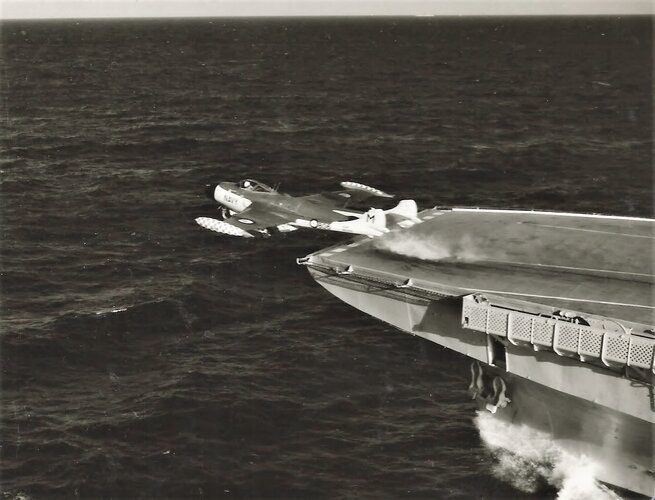

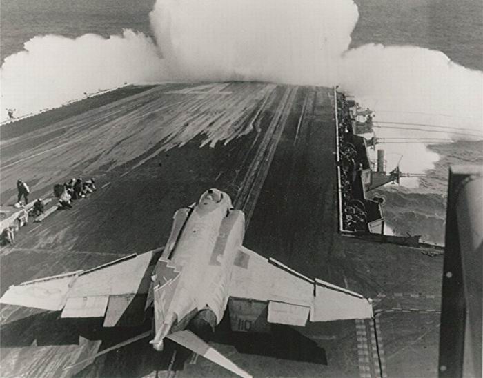

The enlarged flight deck and expanded blisters made her horrifyingly unstable in any kind of a sea. It was so bad that it was predicted that if she rolled more than 24 degrees, she would keep going and end up capsizing. In 88, she damn near did capsize in the Sea of Japan when she rolled 26 degrees during a storm. There were very real concerns about her stability following her 101.66 refit.
My recollections (and I am hardly an expert on this subject, and am always happy to learn more) was that the complaints were mostly that Midway's flight deck and hanger deck needed to be closer to the water than on the Essex class for stability reasons, and that working forward on the open bow areas in any heavy seas resulted in very wet decks with sea spray. They got hurricane bows and blisters in one of the 50's retire and it was considered adequate, though not great, stability-wise. The later refit in '86 was the one that greatly increased the GM and gave her the pronounced stability problems and nickname.
The above is just my recollection, but I'm wondering if some of the history is getting conflated (and, also, how adequate my memory is!).
She seemed quite stable when I was on deck (in harbour, moored as a museum ship) ;)

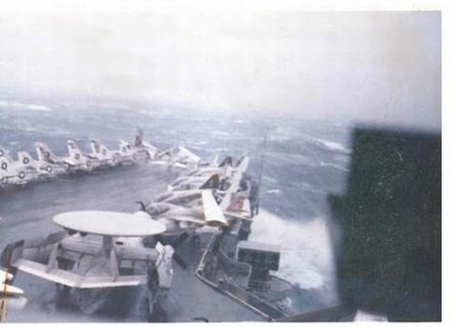

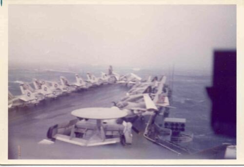

Went fishing for pics of water over the bow and found these among a host of others at the following website: https://midwaysailor.com/midway1980/rocknroll.html
Following from the infamous typhoon incident:

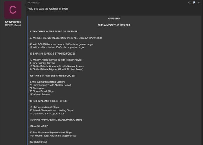

At one point the USN wanted 15 CVA & 6 CVS in 1975. IIRC from Friedman each CVS was to have 20 Vikings and the 187 S-3As bought were to have been sufficient to support a front-line of 120 in 12 squadrons of 10.
The 6 CVS would have been SCB.27C Essex class ships and/or a new class of CVS designated SCB.100. The Essex class would have been ex-CVAs which became CVSs as more super carriers joined the fleet. However, one of the reasons why that didn't happen was that the the SCB-27C Essexes wore out faster than expected due to their Vietnam War service.
Whether Congress would have provided the money if the Vietnam War hadn't happened is another matter.
The top two were in the north Pacific... which can get pretty gnarly.
