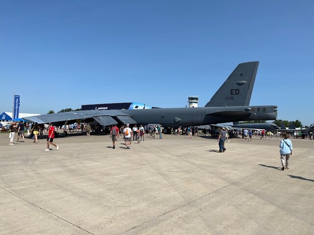

NASA may no longer have a B-52H, but there is 60-0036 with an ED tail flash at Oshkosh EAA this week
Erik Johnston said:
B-52 Testing & Upgrades Oshkosh 2024
This B-52H-150-BW 60-0036 is used for testing new systems. Here we also learn about what upgrades are in store for the B-52.

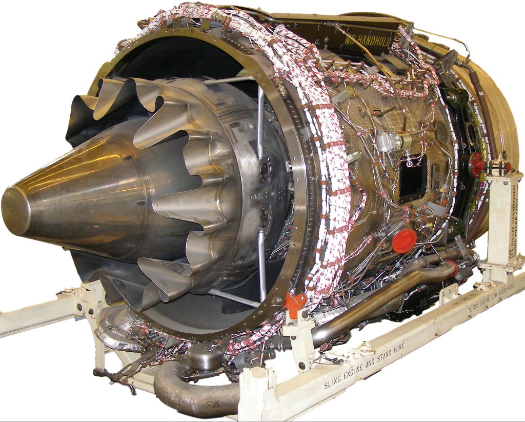

So how’s total thrust and range compared to the old ones?
TF33-P-3: max power 17,000 lbf (5 min limit), military power 16,500 lbf (30 min limit), max continuous power 14,500 lbf; sfc .78 lb fuel/lb thrust/hour
F130 (modified BR725): max power 17,000 lbf; sfc .657 lb fuel/lb thrust/hour
In addition to burning less fuel, the F130 has fewer parts, is more durable (longer times between planned maintenance and fewer unplanned maintenance actions), and is much easier to work on.
