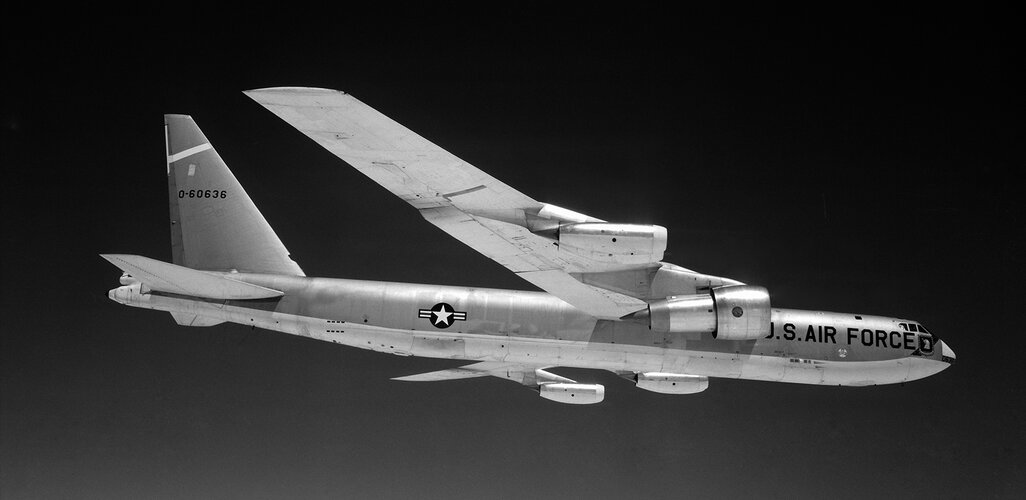

And one B-52E was loaned to P&W as a NB-52E and tested the JT9D engine.

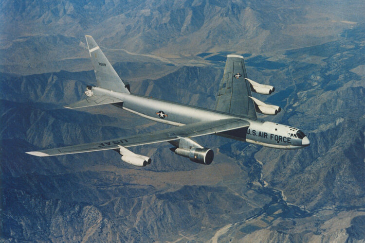

JB-52E (B-52E-55-BW 57-0119 [MSN 464108] bailed to GE Flight Test January 1966 and converted to JB-52E as engine testbed for TF39 for the C-5A, and for CF6. Put in long-term storage in 1972. Decommissioned by GE in 1980 and towed to the south end of the lakebed at Rogers Dry Lake (Edwards AFB). Years later in 1991 it was broken up by explosive charges according to the SALT treaty. It seems that a Russian photo interpreter noticed that the plane seemed to be intact, and insisted that it be rendered inoperative. Seen at Rogers Dry Lake in three pieces). :
JB-52E SN 57-0119 in 1965 flight test of TF39-GE-1C turbofan for C-5A Galaxy.jpg
NB-52E (B-52-85-BO 56-0636 [MSN 17319] used as a test airframe by Pratt & Whitney until 7/30/81. Used to trial some of its engines, including the JT9D turbofan used on the Boeing 747. To MASDC as BC275 July 30 1981. Scrapped February 1994). :

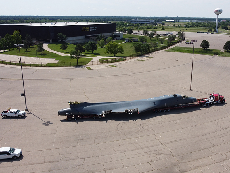

DoD is making a digital twin of the B-1B. It's a 6+ year effort that is going to cost north of $100 million.
DoD is also tinkering with one for the B-52 as an SBIR. I don't think this one aims for the level of fidelity in the B-1 effort, given the relatively little money being spent.

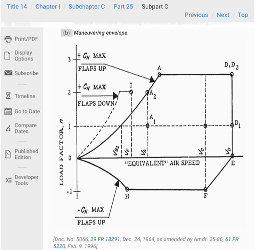

Just to pick a nit, the DC-8 is 2.5 G flaps up Old time bombers only had 2 G.
ISTR there also being a 727 that had an upset and went supersonic and managed to regain control by lowering the gear. Rod Machado talked about it on one of his safety tapes back in the day whennwe listened to cassette tapes, LOL. It did rip the gear doors off but otherwise the plane landed without further incident.
I'd thought bombers and transports were +3.5-1.5 in general?
The Bone can be anywhere from 2.0 to a little over 3 depending on load and wing sweep (I don’t have the dash one handy). It’s also been a while since I looked at the old Mil Std’s and I’m geographically separated from all my design books, so memory’s a bit fuzzy. The kicker now is that all of Mil Std’s are no longer binding unless specifically called out as a contract requirement so it’s entirely possible to have it vary by aircraft. I did have a DC-8 manual in the virtual library that I could reference quickly.
I’m confident no one would pitch a B-52 into a dive like that unless they knew they were gto die anyway.
Hrm. That looks like +2.5-1. Odd. I swear my ancient paper copy of FAR43 said +3.5-1.5... Too many dead brain cells!
Yes, almost made that mistake myself. Part 23 aircraft, general aviation, come in two flavors (3 actually but aerobatic are supposed to pull G’s) Normal and Utility. Normal are your +3.8/-1.5 G and utility are +4.4/-1.76 G.
Both the DC-8-43 and Global 8000 have been dived through Mach 1 and recovered without shedding their wings... and they're 2g rated.
