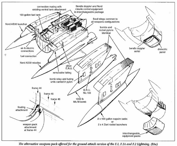

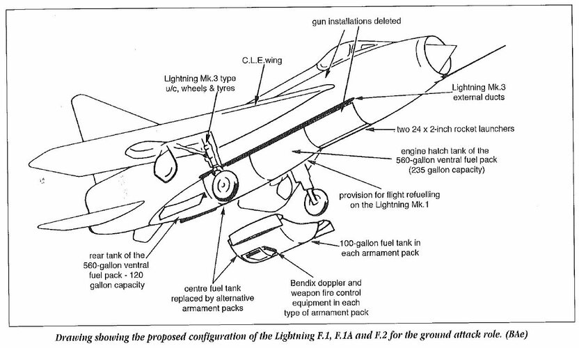

If continuing the historical trend then we would have seen the RAF develop a "Lightning FG.7" conversion in 1965-70 as replacement types came into service (e.g. F.155 or Bloodhound Mk 2), rather than 5-8 years earlier when the F.1 is barely in service and needs fixing.And I don't expect them to develop one in this scenario, but to adapt their existing and more importantly paid for, Mach 2 interceptor into a fighter-bomber the way the US did for the F104 and the French did for the Mirage III.
This is a symptom of trying to convert a research aircraft into a combat suitable "weapon system". It might look similar, but really you're having to redesign a lot.It took 3 years 8 months from order to first flight for the first P1B prototype, yet 4 years 2 months from order to first flight for the first of 20 development batch P1Bs
I think it's quite telling that very little effort was put into trying to make such a fighter bomber conversion - because Lightning was both expensive and unsuited for this role. The likes of P.1154 and Jaguar are far more suitable.
No, that's about 5 years too early for a Lightning variant. In reality then it's just the first F.1s coming into service then as little more than prototypes which required further development and fixing to get a basic interceptor version that worked.So as suitable as these aircraft were they weren't options in 1958-60 whereas a developed Lightning could have been.

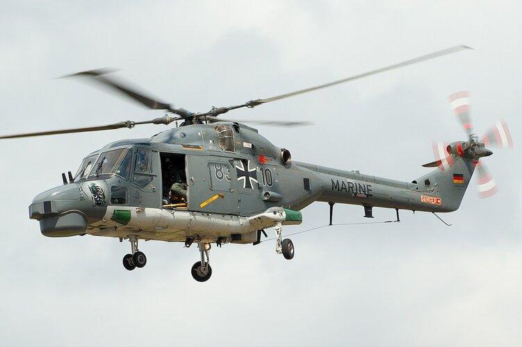

Basically impossible, the Germans started license producing their UH-1s before the WG.13 was even designed.What´s the change the Germany buys british Helicopters Lynx instead of the UH-1D etc ?
Yes, and Lightning F.1 can't do ground attack... and those airframes and squadrons are needed to give an interim UK interceptor capability until Bloodhound comes into service

But how? More design and test effort on these aspects then delays other aspects of the programme e.g. getting a flyable, working F.1The ground attack options for the Lightning started to be developed from 1959, the basis of this scenario is that these were developed from 1957 for RAF and LW use.
