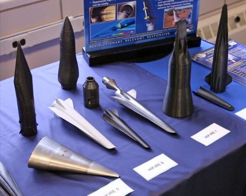

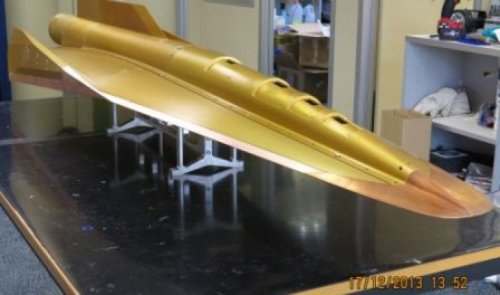

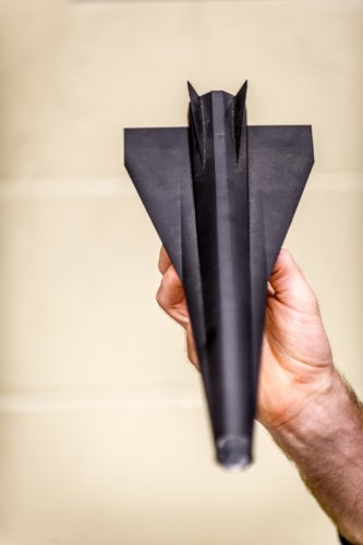

Ryan Helbach, a Hypersonic Research Engineer, holds a flight test model in Hypersonic Combustion Research Cell 22, used to research SCRAM jet technology at the Air Force Research Laboratory at Wright Patterson Air Force Base in Dayton, Ohio, Jul 21, 2016. Helbach is the program lead for AFRL's Intellect to Intellect Exchange (i2i Exchange) which pairs AFRL scientists and engineers with innovative private tech companies and created the AFRL Entrepreneurial Program allowing scientists and engineers to take sabbaticals to pursue outside for-profit goals. (U.S. Air Force photo by J.M. Eddins Jr.)

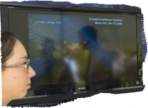

Lt. Malia Stephens, an aeronautical research engineer, and Alex Maag, an aerospace engineer, both with the Air Force Research Laboratory’s Aerospace Systems Directorate, demonstrate the Hypersonic International Flight Research Experimentation (HIFiRE) to a visitor during the 2017 DoD Lab Day, May 18 at the Pentagon center courtyard. (U.S. Air Force photo/Mikee Huber)

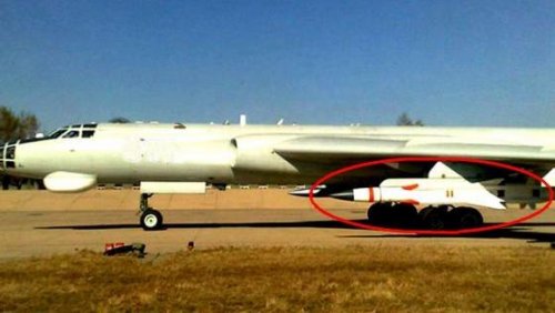

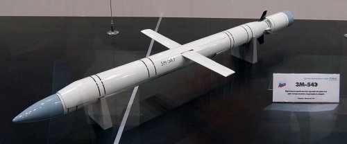

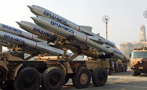

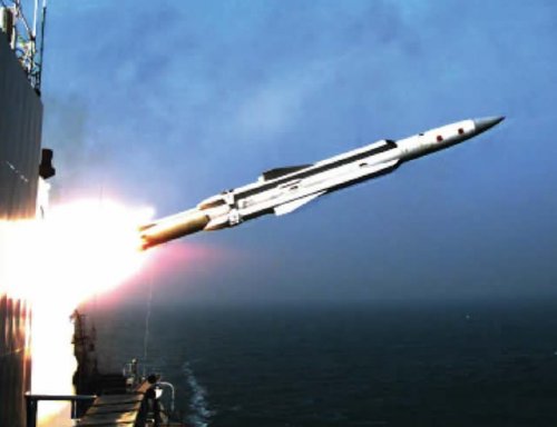

And you're right, the USAF isn't keeping up with anybody. Virtually the entire civilized world is running the table on them. Japan, Taiwan, China, India, Russia, hell even North Korea, are developing, and deploying cutting edge weapons. What the last new hypersonic (hell even just supersonic) missile the USAF deployed? Or any US service for that matter? We couldn't even blow the dust off the nearly 40 year old ASALM and get that working. "Too risky."

KH-32 (improved AS-4. Rocket powered but basically does what you're looking for.)
Kh-90 Koala
Kh-80 Meteorit
And my point was really that there is a plethora of research, flight testing, and deployment going on in the world, of all kinds of high speed missiles - just not in the US. ASALM was the last US attempt. The failed HyFly, RATTLRS, etc. were never intended as actual weapons. (One would hope anyway, considering how easily they gave up.)
How many hypersonic variants of those missiles are operational?

Can anyone identify the "Tactical Strike/ISR" vehicle in the middle of the attached image (found from https://www.nextbigfuture.com/2016/04/us-air-force-hypersonic-weapons-roadmap.html )? Or find the original source for that slide?
It looks a bit like a HiFiRe variant, but on closer look doesn't match any known ones (wings in particular). Also it looks like it has a rocket nozzle in the rear. Isinglass revisited? On the left is clearly the Lockheed HSSW and on the right the Lockheed FRV.
Weird that they'd say the technology wouldn't be ready until after 2030, a mere half-century after this:
