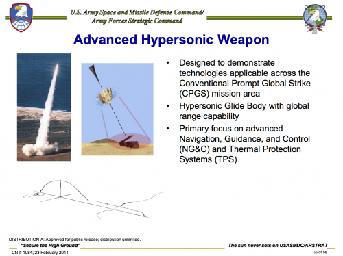

Image is from Nelson's SMDC presentation from April 2017
Do you have the whole presentation?
The drawing of the HGV looks like the Army's HGW. The article mentions an HGV shape close to final production design which I would have thought would look more like the DARPA HTV (greater lift/glide range, maneuvering performance). The Army is supposedly still scheduled to fly a 3rd HGW after its' second flight had a booster failure at liftoff from Kodiak Alaska.
Actually, from the EA, it comes across move as the 900 pound unitary penetrator that was mentioned as
a possible payload along with the rods.

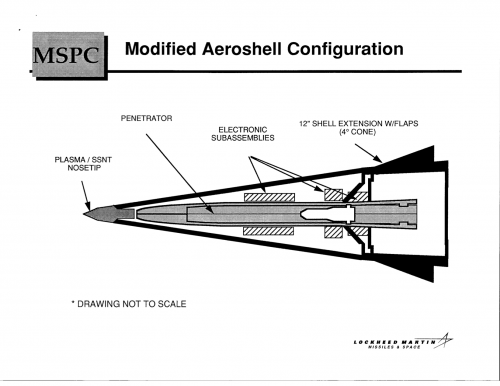

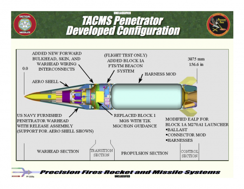

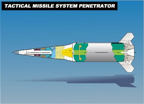

Sandia links AHW to work on TACMS-P which seems to go back to earlier LM work on an SLBM
MaRV with a unitary penetrator ("A Hard And Deeply Buried Target Defeat Concept" by Swinford and Kudlick of LM).
  • slbm-penetrator.pdf

I'm guessing because of the payload options: the unitary penetrator or the tungsten rods (flechettes).
AHW is a direct descendant of SWERVE
quellish said:
The RV definitely is; didn't mean to imply otherwise. But I'm curious about the payload given
Sandia linking AHW to TACMS-P and the stated TACMS-P link to a Navy RV effort.
My understanding was that SWERVE carried a KEP warhead that
if not fuzed to disperse the tungsten rods had some penetrating capability
vs. the dedicated unitary penetrator of TACMS-P.

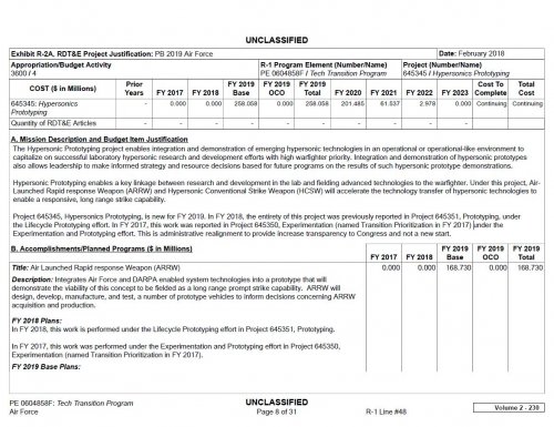

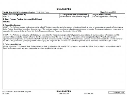

Title: Air Launched Rapid response Weapon (ARRW)
Description: Integrates Air Force and DARPA enabled system technologies into a prototype that will
demonstrate the viability of this concept to be fielded as a long range prompt strike capability. ARRW will
design, develop, manufacture, and test, a number of prototype vehicles to inform decisions concerning ARRW
acquisition and production.
ARRW Aquisition Strategy - The Air Force applied funding to an existing DARPA other transaction authority contract to Lockheed Martin in order to leverage the synergistic efforts ongoing in the Tactical Boost Glide technology demonstration. The cost type contract incentives schedule through milestone payments. The government agency responsible for managing this program is the Air Force Life Cycle Management Center, Armament Directorate, Eglin AFB FL.
HCSW - The Air Force is conducting a limited source competition for the rapid development of a hypersonic, conventional air-launched, stand-off weapon. An IDIQ contract will be awarded to a single offeror to develop/test all elements of the end-to-end system, integration with existing bomber/fighter Aircraft, all respective operations/mission planning and sustainment efforts, to include operational safety, suitability, and effectiveness. Contract award is anticipated in the second quarter of FY 2018. The government agency responsible for managing this program is the Air Force Life Cycle Management Center, Armament Directorate, Eglin AFB FL.
I hope they consider rocket power for the ARRW. Something like a modern Skybolt could fit the bill.

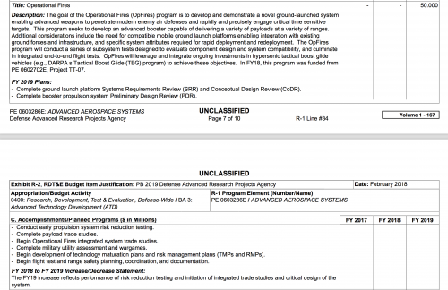

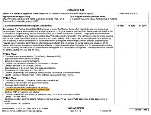

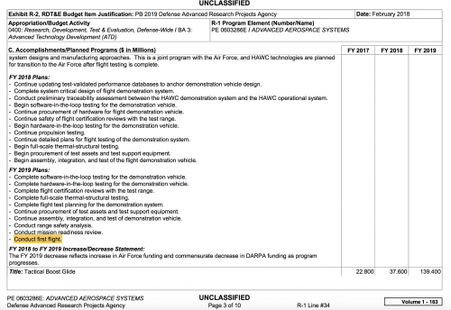

ARRW is going to be leveraging technology from DARPA's TBG which would hint at boost glide weapon. HCSW appears to be more near term since they will be at source selection very soon.
HAWC/TBG/OpFires (DARPA FY19 Budget)

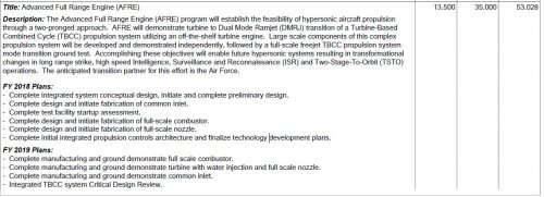

dark sidius said:
I see nothing about a reusable hypersonic system ?
AFRE is funded and the TBCC system is expected to have its CDR in FY19. XS-1 is funded as well.
