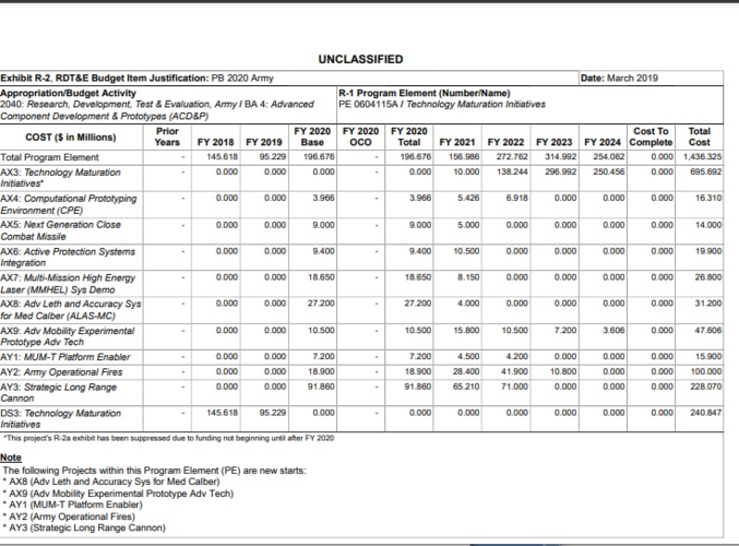

Technology Maturation efforts are often only funded from yr to yr. As one can see SLRC funding goes into FY2022 and even rises.View attachment 658419
So basically the old.
They didnt spend $$$$ last year so they only get $$$ this year.
Saying in full effect?
Cause Im not going to lie that check may as well be in greek for me.
