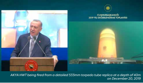

Some up-to-date information was released on AKYA HWT

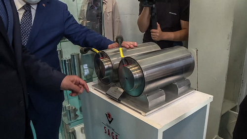

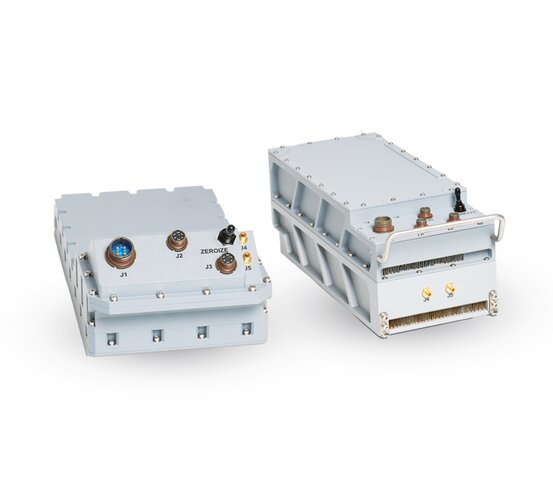

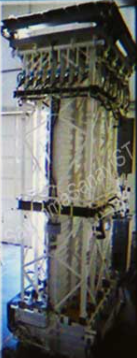

Very Large Thermal Batteries, unknown use case - likely very long range missiles.

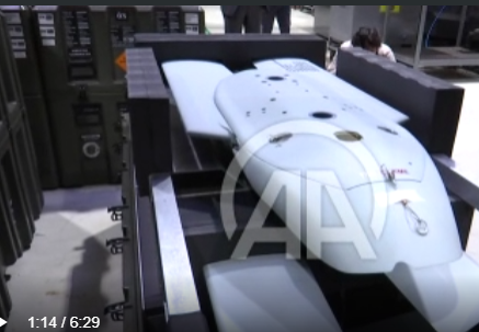

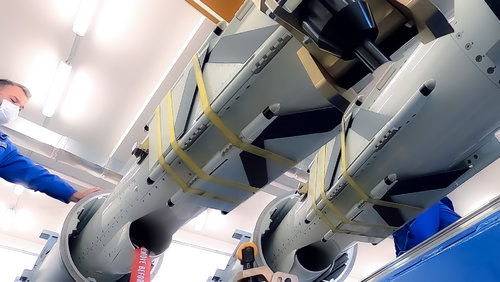

Inlet design on ATMACA AShM - being slid into launching cannister. (Side-by-side image of same missile)
--- to add ---
ATAMACA AShM passed electronic warfare and GPS/GNS denial testing in recent test fire, flying only with INS to target.

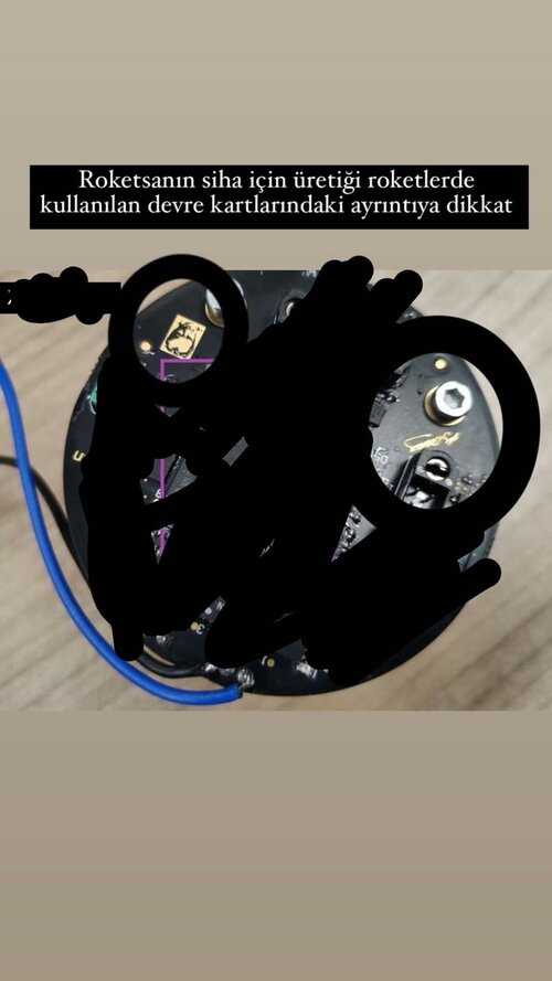

Domestic Missiles from ROKETSAN etched into every PCB board the Founder of Turkish Republic, Mustafa Kemal Ataturk and signature.

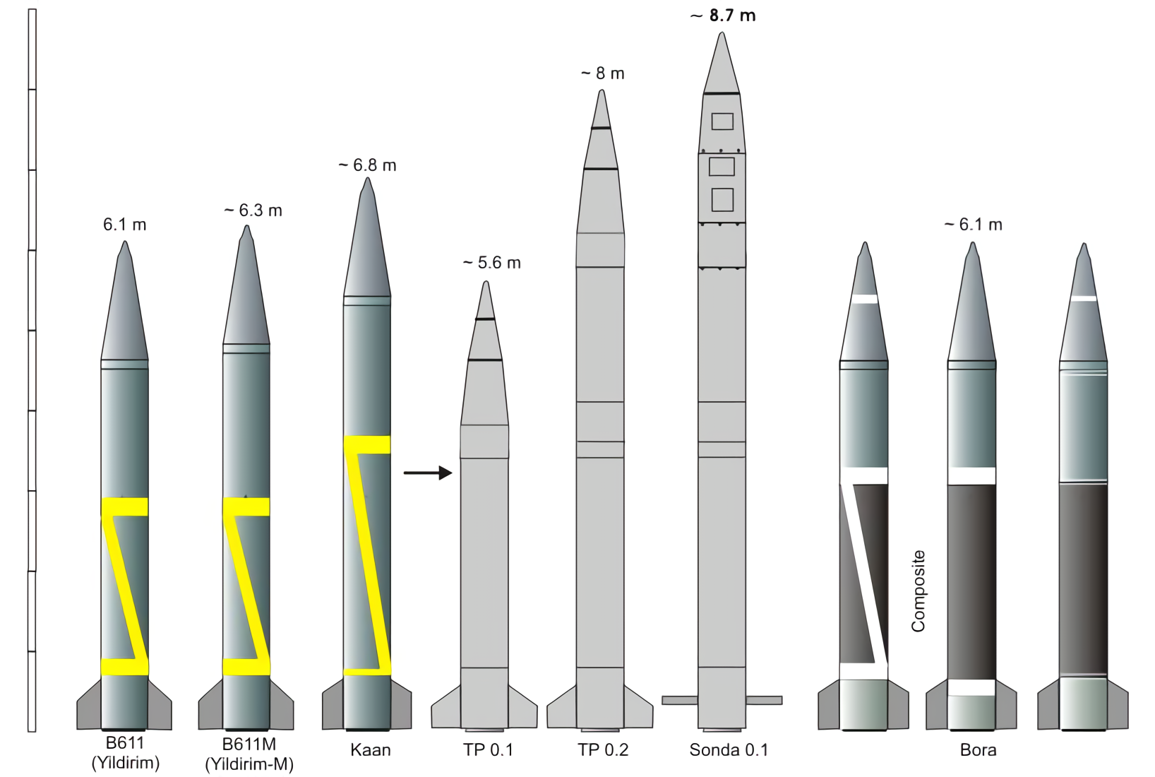

The dimensions of the "Yildirim" missile from Roketsan and its tube-launch variants "Kaan" and "Bora"

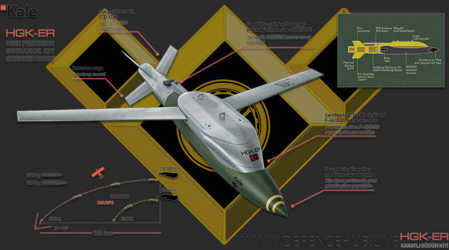

HGK-ER wing kit for Mk-82 and Mk-83 bombs.
Entered into serial production without any news it seems, here are casses of HGK-ER kits. Each case has 4 HGK-ER wing kits stacked inside.
it's the new designation of KGK?
KGK was the name of the project whilst in development by Tubitak. Serial production and marketing name is HGK-ER used by KALE group.

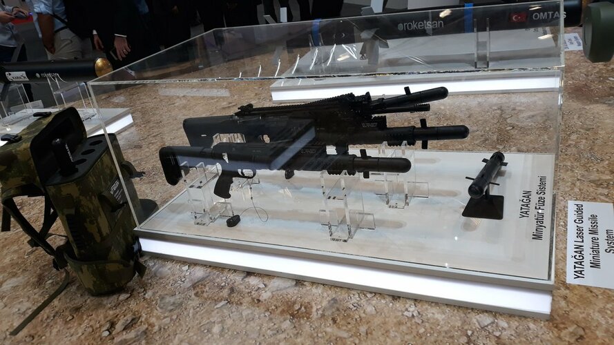

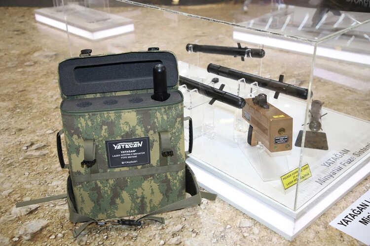

YATAĞAN® LASER GUIDED MINIATURE MISSILE SYSTEM​
YATAĞAN® Laser Guided Miniature Missile System can be fired using new generation man portable 40 mm grenade launcher and has a greater effective range than the maximum range of existing grenade launcher ammunition. Lightweight and small size missile enables integration of the system with mini unmanned aerial vehicles, ground and surface vehicles.
It brings precision, range and target oriented fire power to urban warfare.
Technical Specifications​
Diameter40 mm
Length~40 cm
Weight~1 kg
Maximum Range~1,000 m
SeekerSemi-Active Laser Seeker
Accuracy (CEP)1 m
PlatformsGrenade Launchers
Mini UAVs
Unmanned Ground Vehicles
Unmanned Surface Vehicles

Akya Block 1 heavy weight torpedo launched from Gur Class Type 209 submarine - notice no cavitation :)
View: https://www.youtube.com/watch?v=sdWJ1VO3G_k

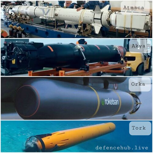

Turkey almost self-sufficient on and under the sea.
  • Atmaca Anti-Ship Missile
  • Akya Heavyweight Torpedo
  • Orka Lightweight Torpedo
  • Tork Anti-Torpedo Torpedo

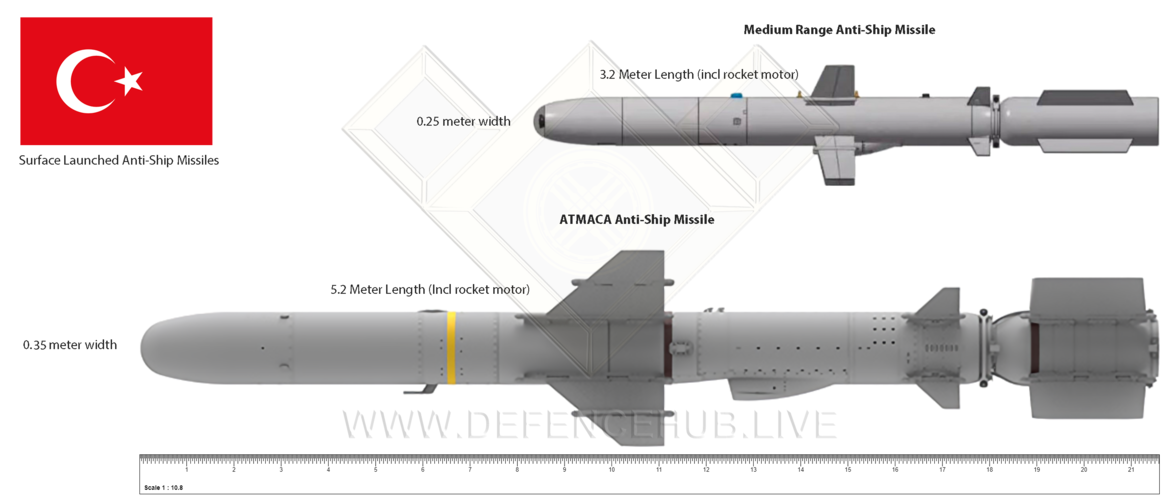

Medium range anti-ship missile under development
