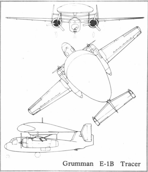

- In another thread (or maybe this one ?) the E-1B Tracer was shown to be able to operate out of very small carriers. Its oddly shaped radome seemingly acted like an anti-gravity device, lifting it over a very short distance.
No, it just was another wing (a side view clearly shows the airfoil shape) - a thick, long-chord, narrow-span wing... making the E-1 Tracer a biplane! ;) :p
Of course, on the debit side the Tracer is a space-eater. About half as many Tracers can be accommodated as compared to Crusaders in the same space.
IIRC from our previous discussions, the Tracer had a spot factor of 2.27 when using the Corsair as the baseline size for each "spot." So yeah, she's a big girl. On something the size of a Centaur, I don't think you're shipping more than 2 without running into major issues trying to fit the rest of a functional air group on board. As crazy as it is to say, something like a Gannet or AEW Skyraider is probably the better option so you can at least carry 4 aircraft and maintain round the clock radar coverage of your fleet
Edit: Just looked, and the USN flew the AD-5W with the AN/APS-20 radar until 1967, with the last operational deployment of the type being with VAW-13 Det N on USS Hornet. So it's possible that some might be in the Boneyard. Especially if Canada asks for them early enough
